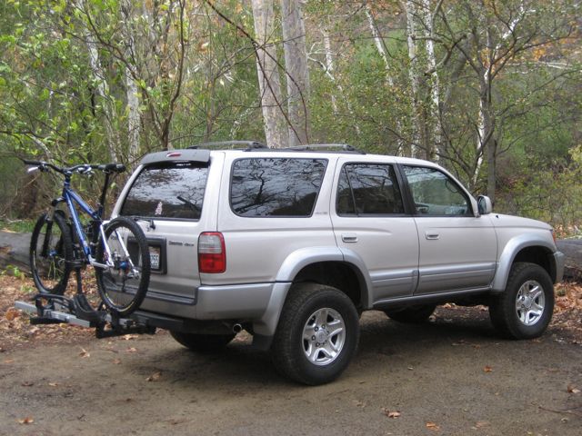

Here is my 2000 with PP's and Bilsteins.

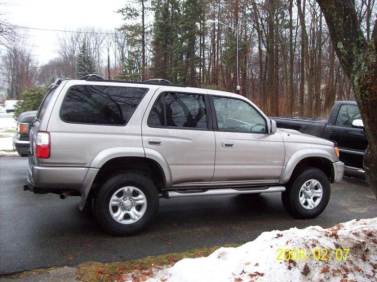

Here is my 02 with the PP springs and Billsteins.

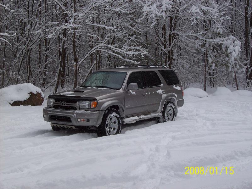

Not a great pic because of the snow but you can kind of get the idea how far up the suspension brought it. This is before the new set up.

Bilsteins should be fine for on road. I really didnt think they are that rough as people thought em to be. I don't do too much off road driving. Lots of highway for me.
If your looking for a plush ride the PP and Bilsteins arn't the way to go though. You can't beat the looks though!
I am still running the stock size 265/70/16, I intend on going to a 265/75/16 next time.
As for the rake I believe it is mostly due to the fact that my driveway is sloping down, it looks far less pronounced on flat ground. I would say it sits about level on flat ground with perhaps a slight rake, but better than before when the front actually looked higher than the rear.
I am running stock 265/70/16. As for the rake, my front came out much higher than the rear. I was hoping the rear would be higher as I haul a bunch of gear often.
