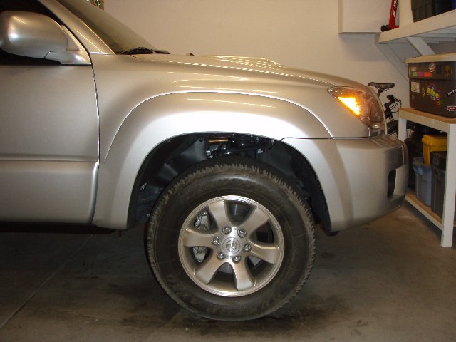

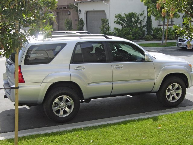

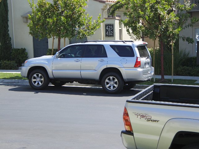

Here you go... 1" toytec spacer on the front.

Very cool, thanks for posting those pictures. I think that is the convincing I needed to pull the trigger.
Did you have to re aim the headlights and fog lights after you installed the lift?
So, when are you going to get bigger tires? :)
I had to point the headlights down just a bit, but the fogs I left alone, seemed like it lit up the road better unadjusted. As for the lovely Dunflops I have about 4/32 of thread left so they'll be replaced soon with up sized Revos 265/70/17. The factory size tires look a little funky on the 4R, I wonder why Toyota decided to use that size.. :confused:

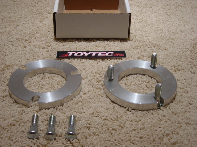

The part code is "TOP1-T", it sells for $59.99. The spacer measures 3/8" but with the suspension's geometry (leverage ratio) the end result is 1 inch of lift. Their web site is www.toyteclifts.com. I've had the spacer on for almost 2 years 15K miles with no problems, as for ride and handling it feels the same as stock. Yeah, I saw your other thread with the incident at the stealership, that sucks big time hopefully they'll get your Runner back to new.

The Cornfed spacers look exactly the same.
They are a 1/2 inch spacer , which provides 1" of lift , so I'm told.
I dont understand how a 3/8 spacer and a 1/2 spacer would provide the same lift. The 3/8 looks slightly higher, looks great though !! , once you get some 265/70's on there it will look really sweet.
You know what, they are 1/2" not 3/8. My bad... Yes these spacers are similar to the Cornfeds but for half the price..
