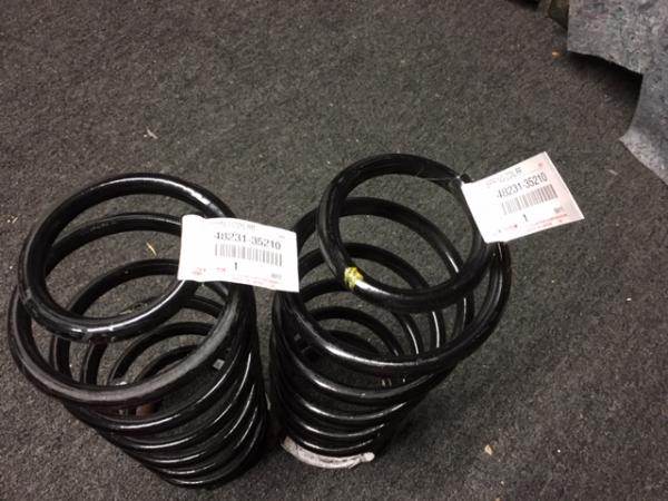

What's the part number for the "talls" you are talking about. I have a set of brand new springs for sale that I bought for the 2000 Limited I just sold and it was my understanding that they are an inch taller than the originals.
Part number is 48231-35210
Those are exactly the ones I'm looking for in the back.
How much are you asking for them?
i just scooped some lightly used 99s for the front from [MENTION=113851]dirteater4[/MENTION], so this project seems to be coming along nicely.
[MENTION=79826]absalom[/MENTION] I was seriously considered the 890s but from what I read there was debate on whether or not it was wise to run them with 4600s. A lot of people seemed to think it was ok, but the manufacturer doesn't recommend it.
