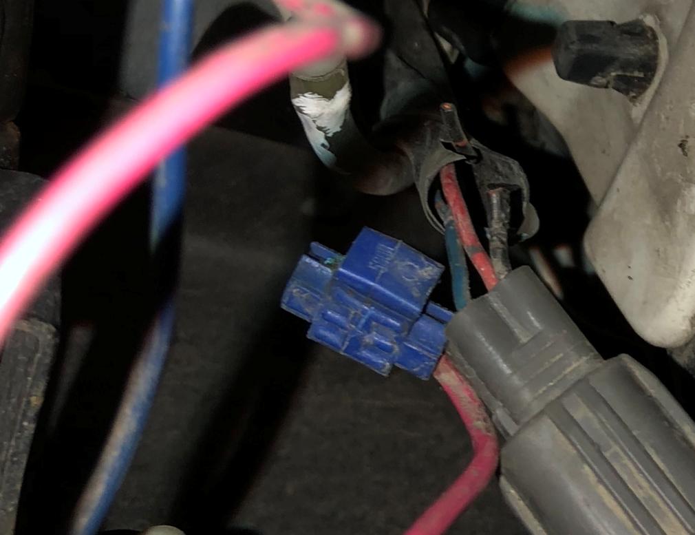

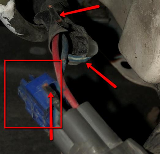

I decided to take out the washer fluid container and noticed the female plug has some broken wires and some weird blue connector?
I am not good at electrical work. I have some spare wire, solder, heat shrink but not sure if I have enough wire left on the plug to fix. Can I even order this plug and rewire it, can't find a part number?
Any tips or info would be great on how to get these wires connected.

That blue connector is a aftermarket "tap" that is used to get power from an existing wire without having to cut, then crimp/solder and heat shrink the connection. IMHO they are totol junk and should never be used on the exterior or under the hood of a vehicle -- I don't like using them on the interior of a vehicle.
It looks like there are three wires going to the plug: red, black, and blue. The black appears to be cut. Is that right?

Thanks so much. It helped me figured out what it was. They had that wire going to my aftermarket daytime running light modules. The whole thing was corroded. I rewired, soldered everything and all is back up and running. Just had enough wire to play with.
Thanks again my friend.
