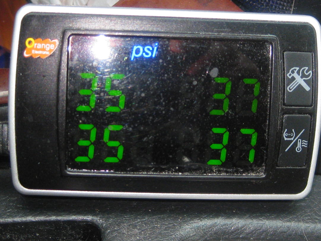

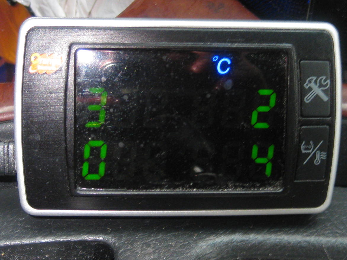

the tpms i have for my aftermarket wheels tells pressure for each wheel not just indicates that one is low, so yes, its needs a bigger screen. i think its better but it uses its own sensors not he oem ones. pretty sure the batteries are replaceable also.

probably too big & bulky for you but it plugs into cig. socket without additional wiring. it is a little large but i like that i can see all wheel pressures at once. mounted on console in front of shift, its about 2in x 3in.

That's cool. Does it integrate with the factory TPMS (dash light on)? I'm assuming you had to also install aftermarket sensors for the temp. function.
Thats pretty cool Chaz. I think it would drive me nuts though having different numbers for each tire. . . . . . would be stopping all the time to air up or down.:doh:
