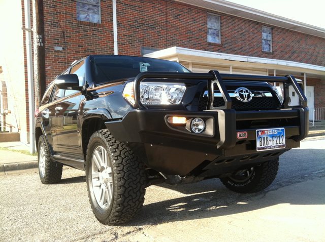

285/55/20 BFG A/Ts
No lift needed, but I do have a 1" spacer lift on the front to support the ARB.
A slight bit of rubbing on the back front wells (plastic rub--it will eventually lose to the tire).

Helix,
You got my attention; could we get some more pics of your truck? I never thought I'd go with 20's but your set up looks great.
