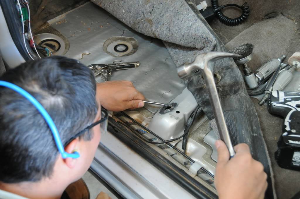

I did something really stupid yesterday! I was trying to find a good ground point for my sound processor, and read that the rear seat bolt was a good option. Well, as I was trying to put the seat bolt back in, it was getting stuck. After cleaning and using a wire brush to clean, it was still getting stuck --- so stupid me, I was forcing it and the weld nut ended up popping off! :(
From what I've seen online, some people have cut out the section where the weld nut is,and welded in a new piece of metal, with new weld nut in place.
Any welders here in DFW that can help me out?
Post a picture, that sounds like a really extreme solution. Should be able to tack weld a new weld nut on or even use a riv-nut.

I've also had one weldnut come off on my '15 - one of the front bumper flange weldnuts came off. Poor welding. It appears that on these newer 4runners they're meant for one time use only. I have access to the back so I can re-weld it on. Depending on location it may be harder for you.
On my own vehicle - it would depend on location. I would seriously consider epoxy as an alternative. But you'd want to make sure it's the correct epoxy. Lots of two part resin glues are called epoxy. The good stuff is extremely strong.
FWIW - if this is the bolt that holds the rear seat in place - I would not use a nutsert. They pull out pretty easily. It may not be safe in a collision.
I was about to order a nutsert! :) Maybe in the right application it would work, but yes, this is one of 4 bolts that holds down the rear passenger seat -- so maybe a welded plate replacement is the best option. -- Or take the seat out :)
Sounds like you've found a friend to weld it! I think they work great for some things. Just not for sheet metal in a pretty critical spot. Something like this welded or bolted in will be a lot stronger. They're generally called "washer nuts" http://www.shopjeepparts.com/round-washer-with-welded-seat-belt-harness-floor-mount-p-6964.html

To me, it seemed that the weld nut gave a little too easy, so this seems like a great solution for my application. Three other bolts, plus this solution, should be a good fix :) Thanks for the link!
