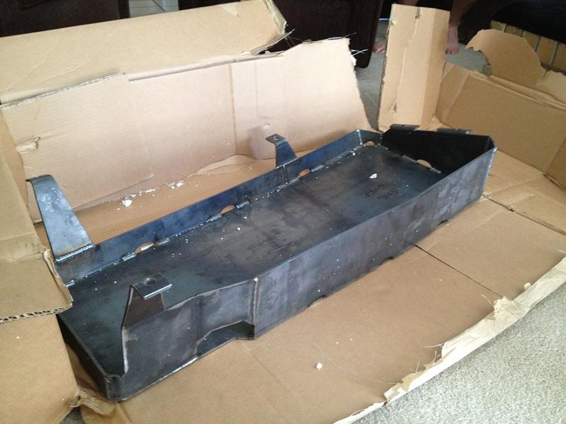

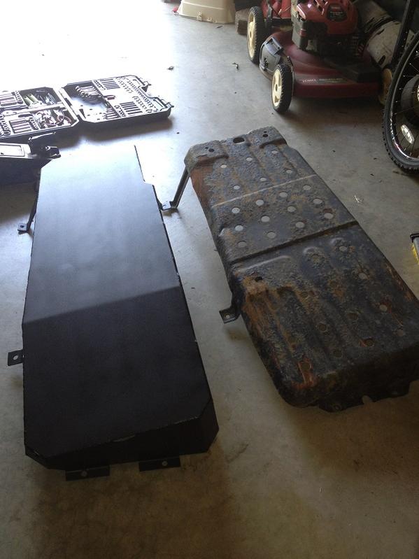

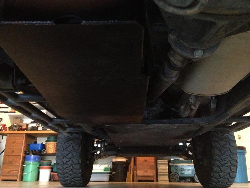

Thought I would post up here as I have an Any7 Gas Tank Skid. I had a couple fitment issues but I relayed them to Darren and I dont imagine they will be a problem again. Even with those little changes it took me less than an hour to mount it up.

[MENTION=82211]TCMach[/MENTION] do you mind sharing with us the small fitment issues you ran into? That is such a stout piece of hardware, i need to make a gas skid purchase soon.

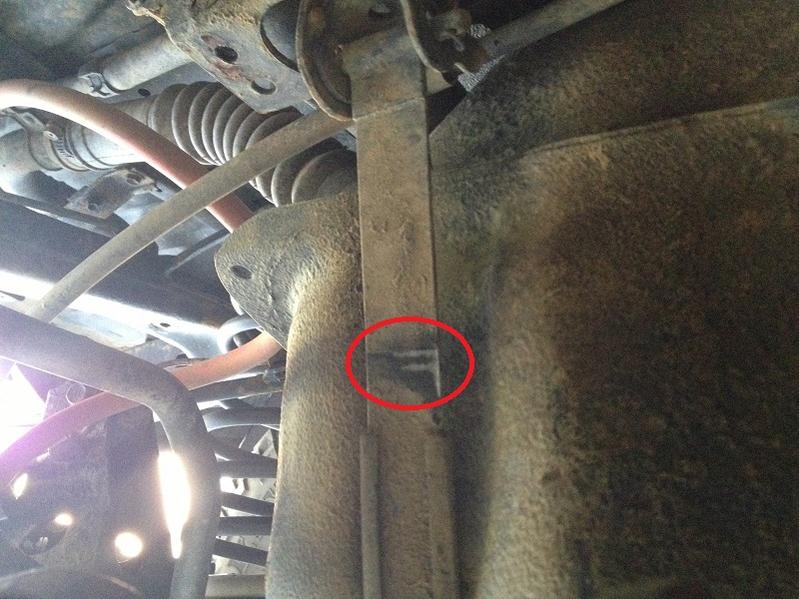

Sure. Since this skid has all its mounting locations welded on (which I like) as opposed to the Lil' Skips skid which has bolt on mounts (the rear two I believe) the size and location of the mounts has to be exact. Dealing with the tolerances of different 10+ year old trucks probably makes this difficult and its where I believe the issues stem from. On the rear passenger side mount (where the gas tank mount strap is) the skid was a little to tight and actually cut into the strap when we tried to shove it on. The skid does fit very tightly here in order to have maximum driveshaft clearance so its a small issue.
The problem, shown on the gas tank strap
The fix, two cuts with a hacksaw and a crescent wrench bent it enough to clear without issues (yes I repainted it :D)

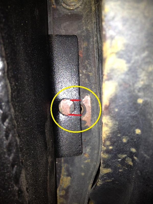

The other problem I had was the drivers side front mount. I don't really have an explanation for this one. Maybe they can just incorporate more material into the mount next time because I didnt have enough to enlarge the hole to where it would fit. I don't have a picture but my solution was to chop on the red lines and run the bolt through with a big fender washer. I could probably make a piece of metal and cover more of the mount but I'm happy with it and its definitely not going anywhere.
Chop lines shown in red, approx. size of fender washer shown in yellow. I had not cranked the skid on at this point so the hole was a little closer by the time I tightened everything up but not enough for that bolt to fit in the original hole.
I sent all these pictures to Darren and told him about my fixes so hopefully these problems will be eliminated in future skids!

How tightly do these skids fit up to the tank? Did you notice a better fit with more clearance over stock skid? I like how all the mounts are fixed and no brackets are needed. A side shot of your rig with the skid installed would be nice to see.
I think when any7 was taking measurements, it sat about 1/2" higher than the stock skid. Without the need for rib supports, it could be tighter to the tank. I don't have a stock skid to compare to anymore but a side shot should help with the relationship to the lower control arm mounts and the crossmember right in front of it. Ill see if I can measure out the drop below the frame as well.

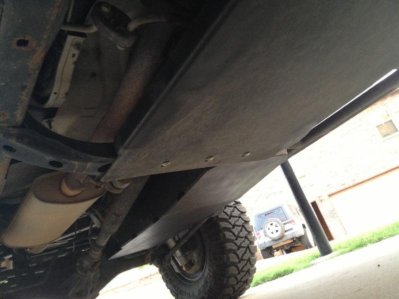

I thought I had a picture form the side in the first post.
I'll see if I can grab a shot from the side later today and post it up.
I was able to grab a quick picture from the side.
As you can see, it is level with the cross member up front and in line with the lower control arm mount. It creates a flat ramp from the belly skids to the cross member to the skid then on to the control arms. No steps of any kind to hold you up.
Hope that's the shot you were looking for.
Thanks for the measurement and pic. That was exactly what I was wanting to see. I'm really liking this skip plate.
