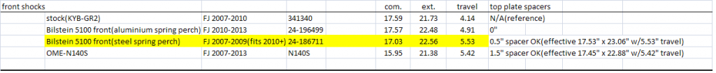

From what I understand, Looks like the valving is different for the 10-13 vs. 07-09 5100 front shocks. Rears I know have different diameter mounting eyelet for 10-13 rear shocks , see below for details on fronts.
