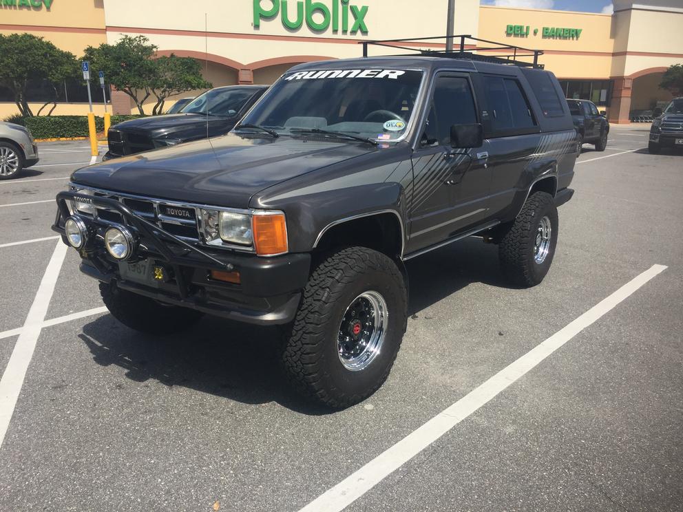

Just installed BFG KO2's 31 / 10.5 / 15
Anyone else running these?
Where do you like the PSI?

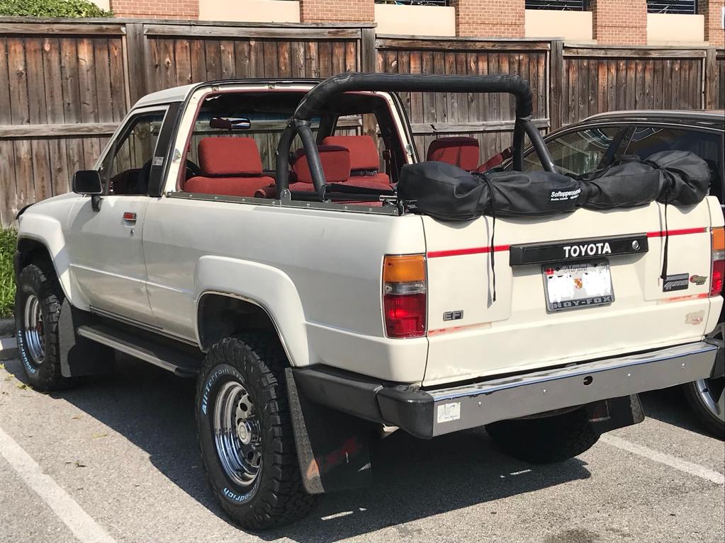

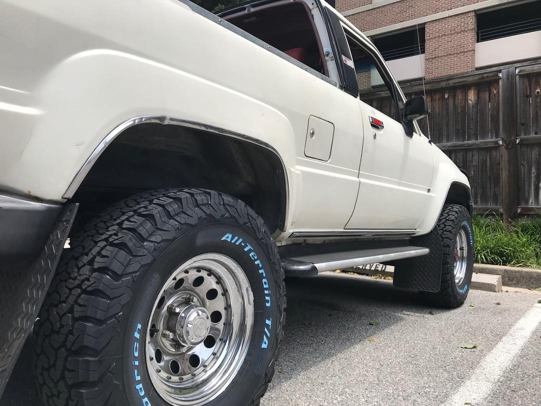

Ome rear leaves with a leaf removed. Stock torsion bars up front. Bilstein shocks.
I just did a chalk test and found the factory 26psi front looked good and about 28-29psi rear is good. Factory calls for 35psi rear which is too much.
did a chalk test. 34 PSI in the front looks good
I went down to 27 PSI in the rear and had about a 1/2 inch on each side of the tire.
Figure I'll leave it there, accounting for extra weight in the back (people, cargo, etc)
With the hard top canopy off, really takes a lot of weight of the back of the 1st gen.
