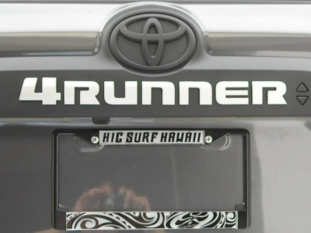

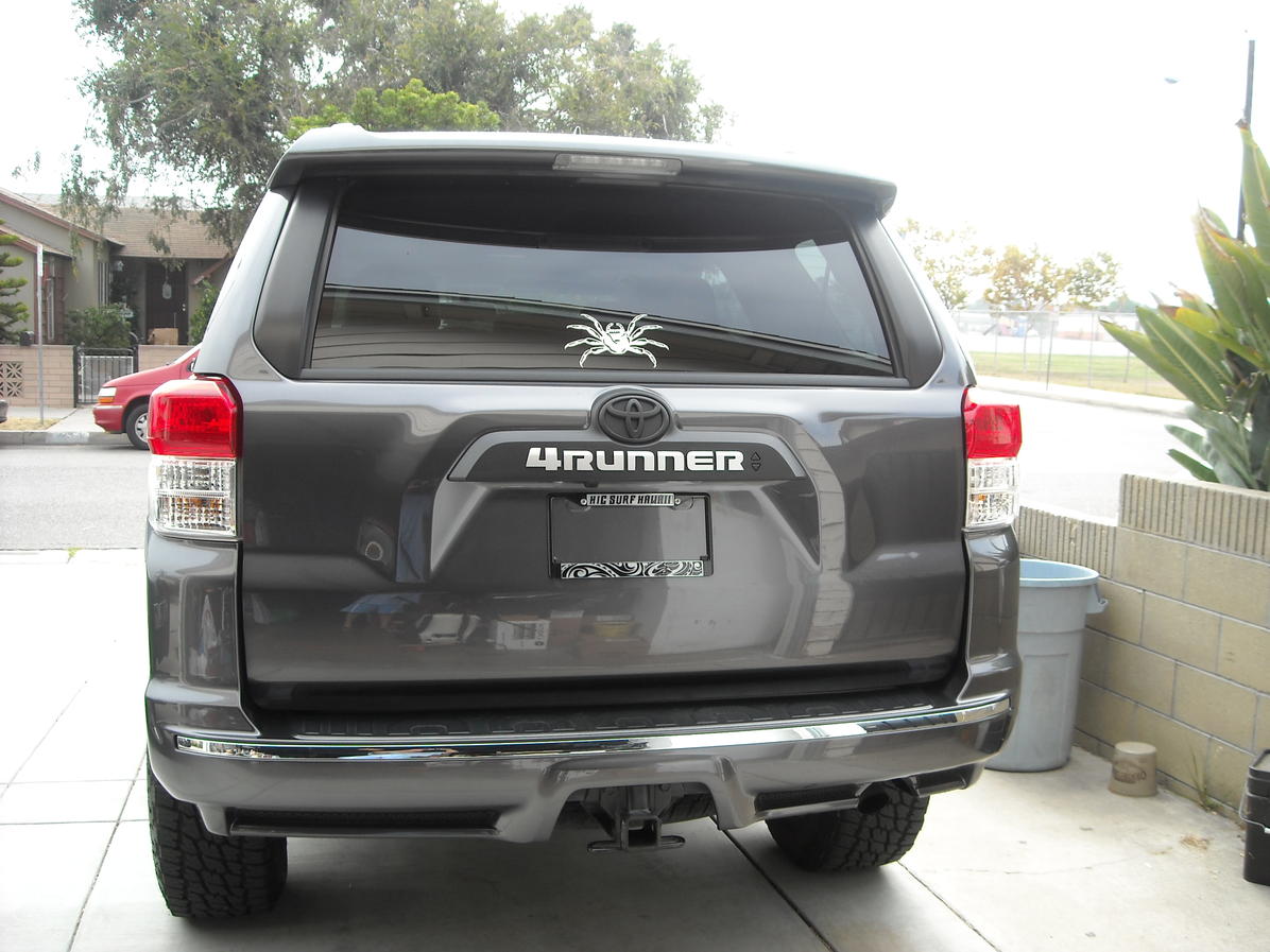

removed,painted,reinstalled 4runner emblem
This is what I did. removed 4runner emblem. Painted chrome housing black. Reinstalled 4runner emblem with 3m double stick tape.

I painted it while still installed. Process: I removed the lettering with fishing line,used 3m adhesive remover to get off the rest of sticky tape from housing with small plastic kids ruler. I bought a plastic table cloth $1. it covered pretty much the whole back of the rig. Cut out the area that was going to be painted,taped off all areas exposed around housing,lightly sanded then painted (3 coats). Bought 3m double stick tape to reattach 4runner emblem. I know you didn't ask how I did it,in case you or any other member decide to do this mod this is how.
