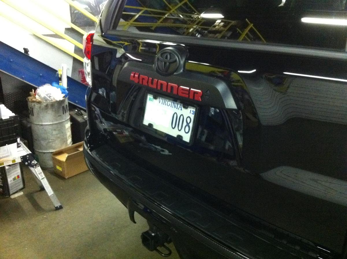

I painted it while still installed. Process: I removed the lettering with fishing line,used 3m adhesive remover to get off the rest of sticky tape from housing with small plastic kids ruler. I bought a plastic table cloth $1. it covered pretty much the whole back of the rig. Cut out the area that was going to be painted,taped off all areas exposed around housing,lightly sanded then painted (3 coats). Bought 3m double stick tape to reattach 4runner emblem. I know you didn't ask how I did it,in case you or any other member decide to do this mod this is how.
Thank you for your detailed mod. I have already taken the what I consider overly large 4 RUNNER badging off, but have not decided what I wanted to do with the "base plate". At least now I know I could paint it with minimal concerns. Thanks again. Be safe.

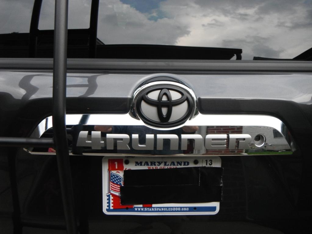

No. The "4 RUNNER" letters and the "T" Toyota emblem are taped on. The chrome moulding is held on with some 10 mm nuts inside the hatch, and a couple of plastic push pins. I removed the "T" and painted it. It's located with 2 plastic pins and held with NASA grade adhesive...
LOL i like your poormans photoshop of your license plate. lol. It actually is much easier to cover the plates up with tape, that to crop it out. Haha.
