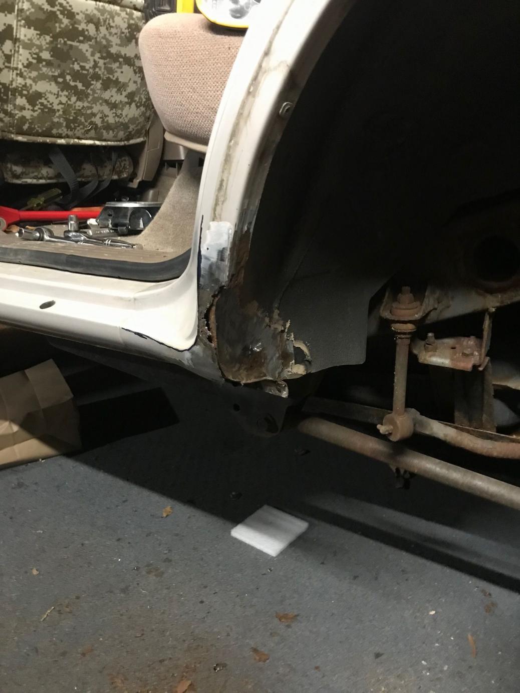

I just got my replacement panels from Wolf yesterday. It’s been too cold to really mess with them yet.
I’m split between cutting the wolf panels down or cutting my rockers up higher towards the floor pan. My bad spots are gone once I hit the dirt 90° ledge from the rounded part.
I made a thread today (without seeing this one first) that has some pics of my situation.
