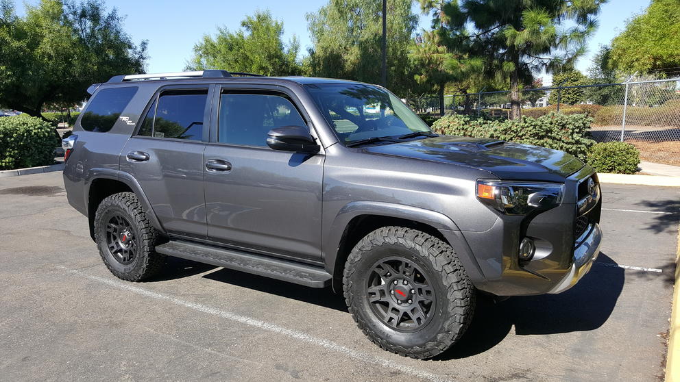

It's a little difficult to tell, but here's my 275/70 next to my cousin's TRD Pro on 265/70. Both stock suspension.
Mine (on right) is on SR5 suspension, cousin (left) on KDSS.

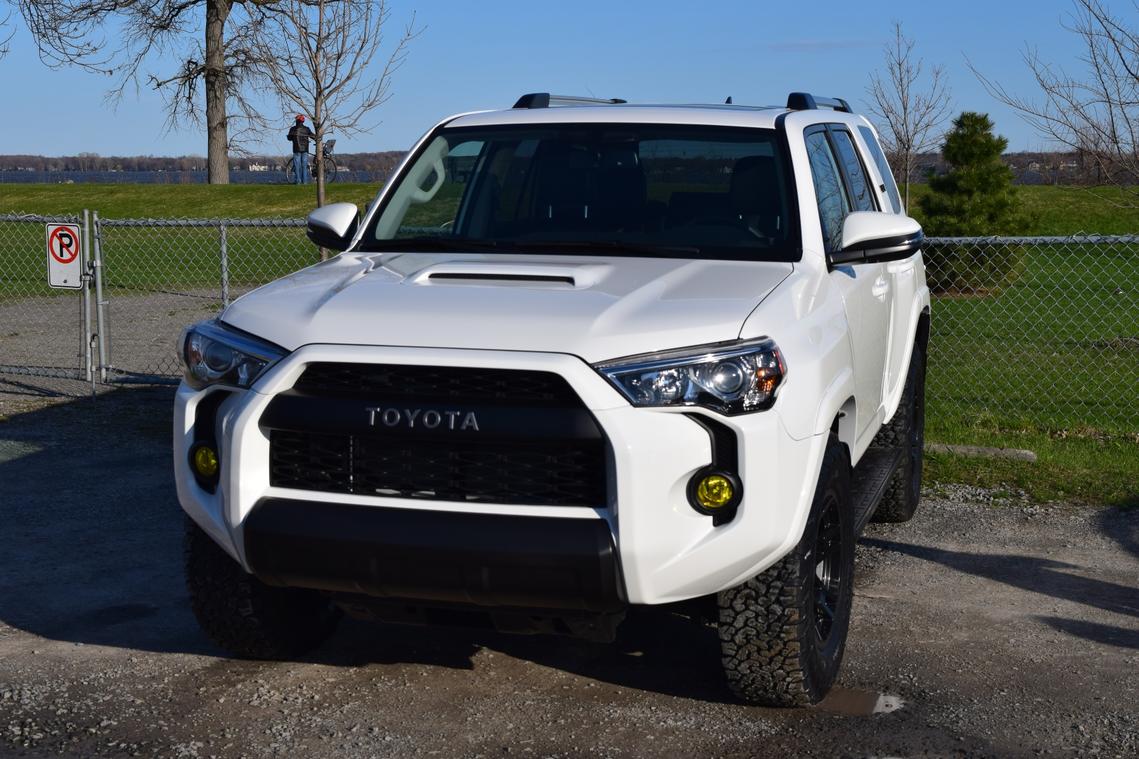

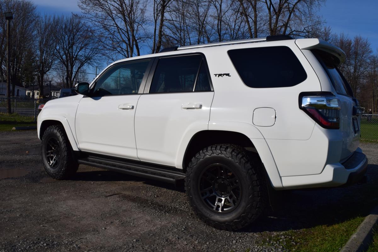

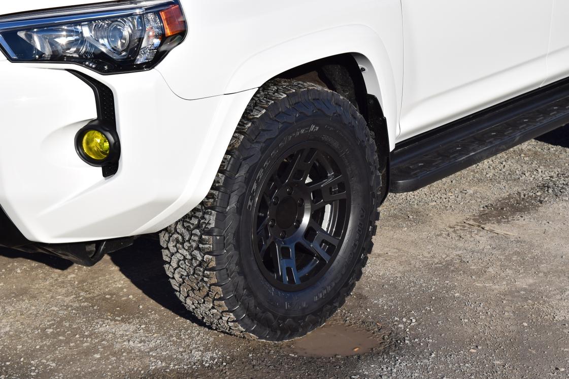

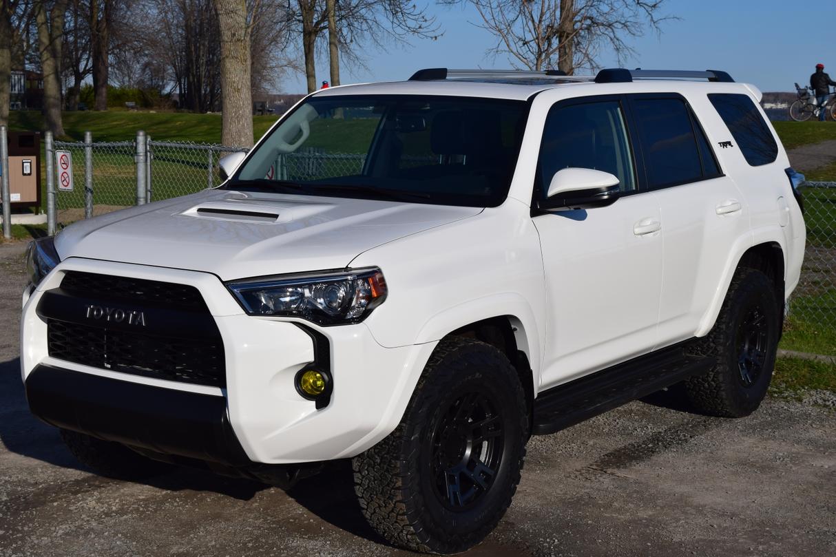

2016 Trail Edition with KDSS and stock suspension.
The wheels are FN Fx Dark Gloss Metal with 275 K02. Unfortunately, they look WAY better in person than on pictures.
I had to move the fender forward (took 10 minutes) and reshape the mud flap with a heat gun since I wanted to keep those.
It still rub a LOT on the front bumper plastic while going in reverse and turning. I am still debating if I will cut the bumper plastic a bit or go for a 2 inches lift. No way I can leave it that way, it rubs too often.
As a one liner, if you aim putting 275 K02 on your stock suspension 5th gen 4Runner, it will rub more or less ... expect some trimming. Do not get discouraged since it is really easy to do though. The compliments on my truck started raining the day I did install that wheels/tires combo.
I do not care about the E rating of those tires. They feel AWESOME.
ps: I got my TRD vinyl installed on the center cap but they are not on these pictures. I will try to post a new picture soon. They look quite good.

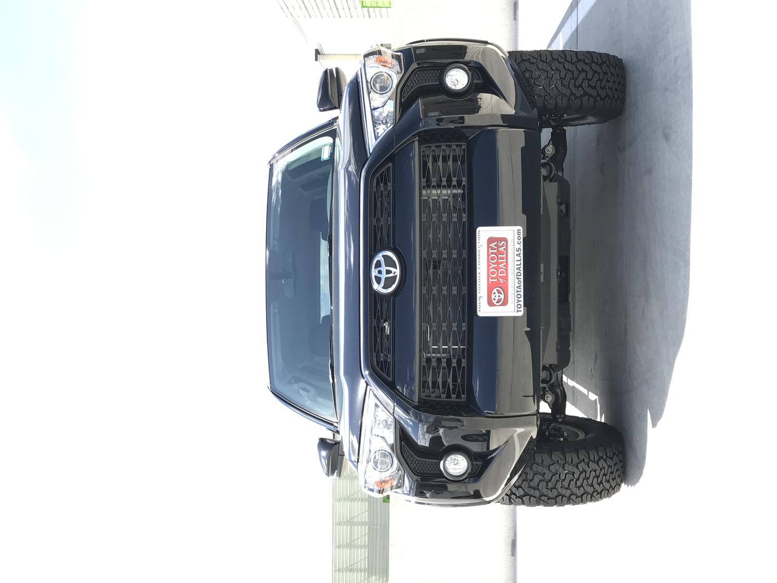

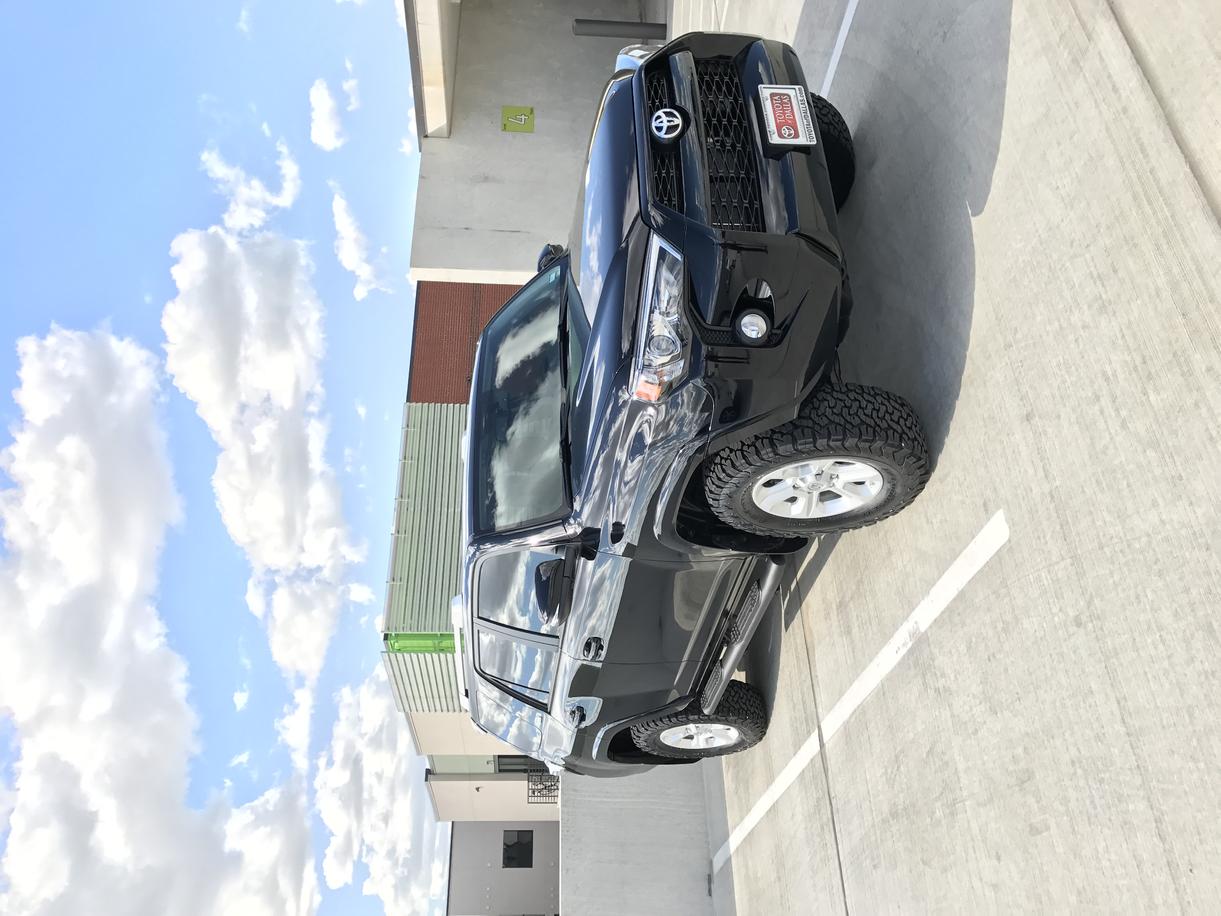

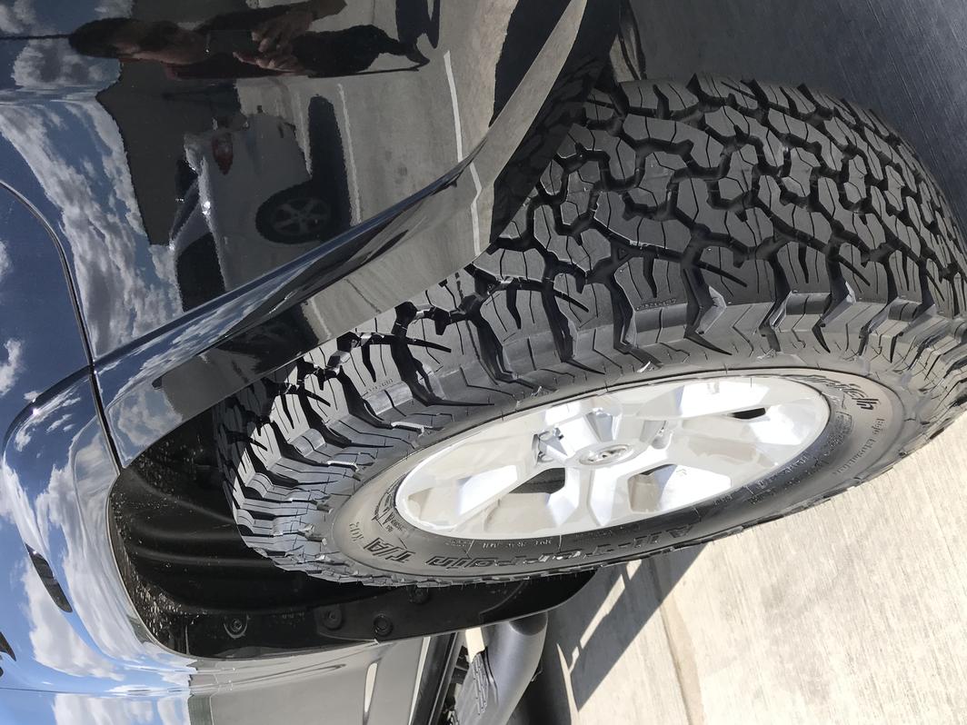

Just purchased a new 2017 sr5 premium. Very stoked on my first self-bought new 4runner. About 5 days and 100 miles into owning this truck I put on 275 ko2s, and about an hour after I picked it up I took it on a short road trip and camped. No rubbing whatsoever! You can feel the weight of the tire, but beyond that there's nothing really different that the stock Duelers (as far as drive quality goes). Drives smooth on the highway at high speeds, noise isn't bad at all.
This is the first of many upgrades to come, hope to share them all with you here

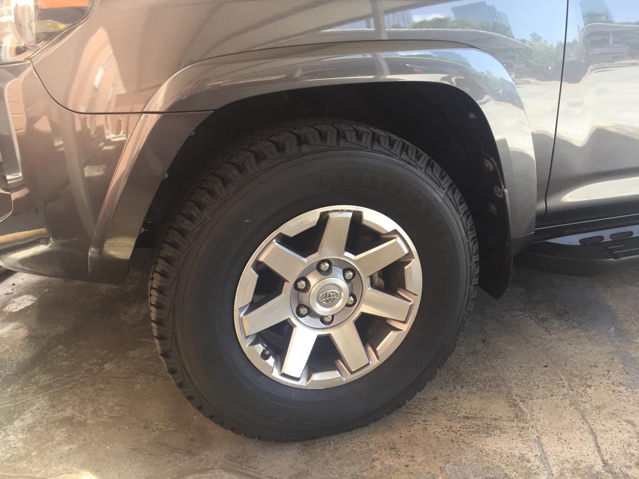

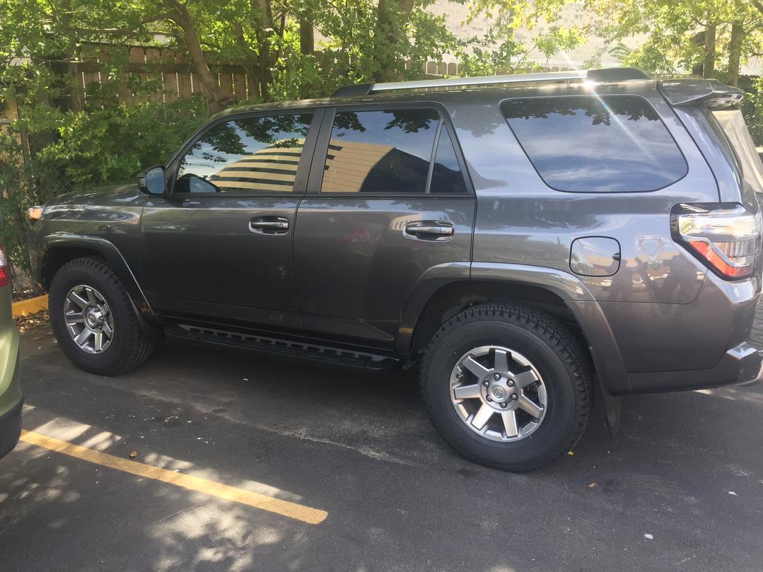

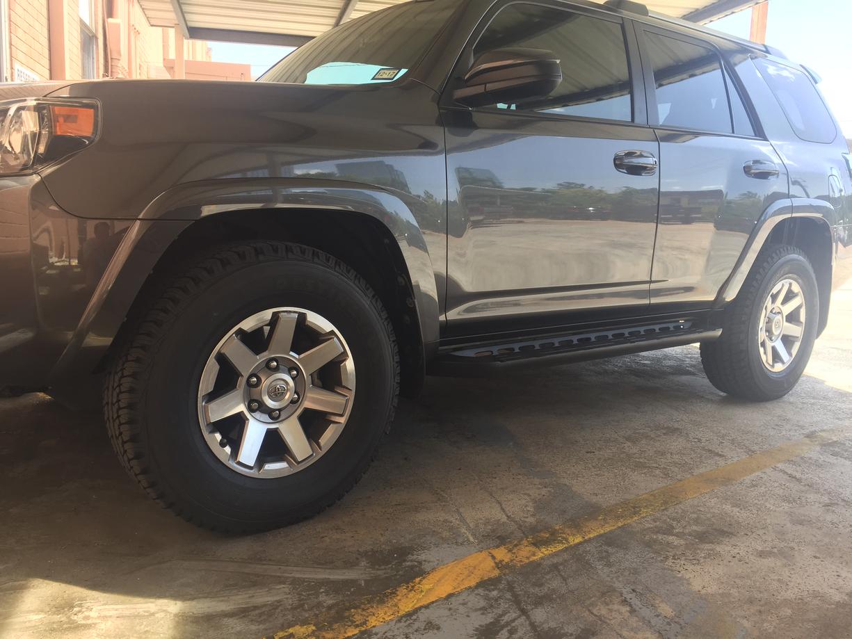

I just put 275 70r 17 Firestone Destination A/T on my completely stock 2014 Trail. To my surprise, there is some slight rubbing when turned completely turned left and in reverse.
Suggestions?
