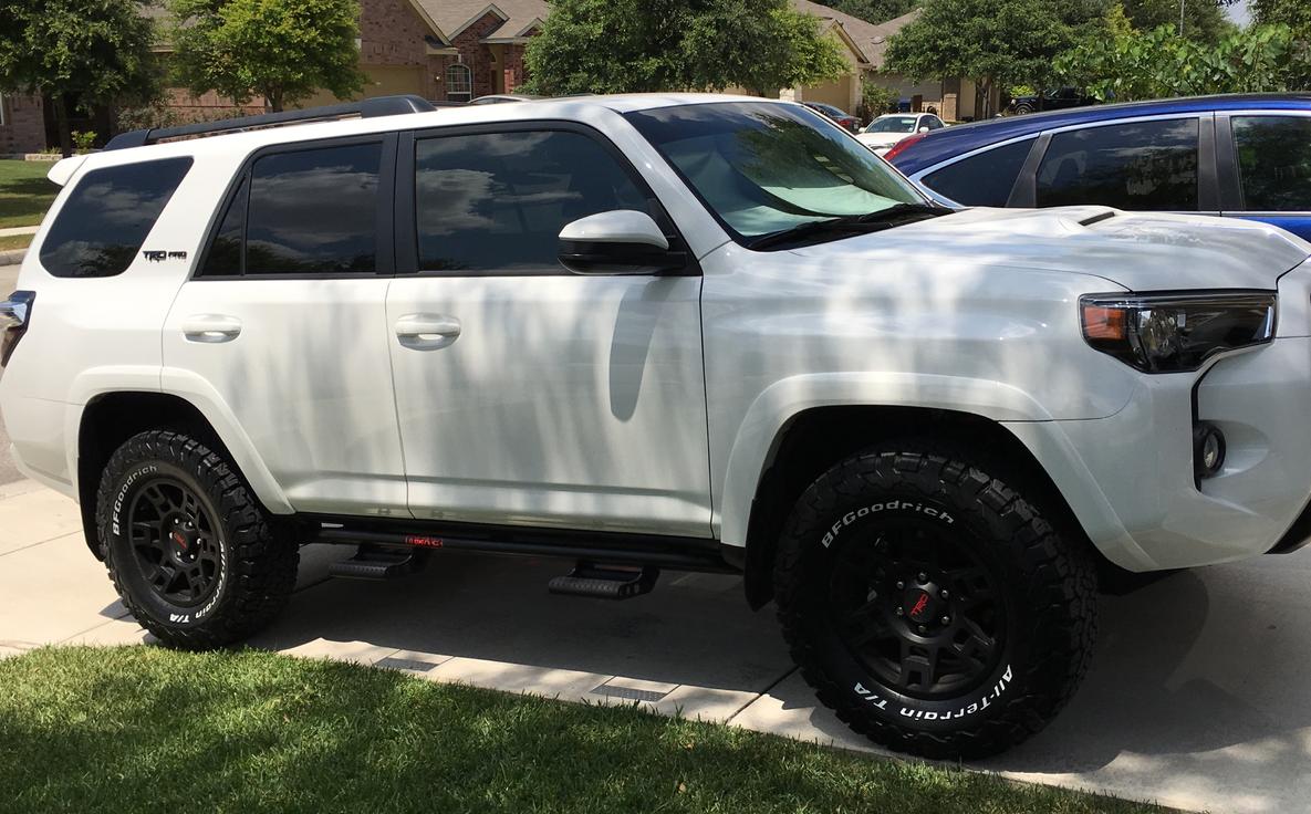

275/70/17 @ 40 PSI
No Rubbing
After less than 24 hours of ownership and only 36 mi on the odometer I upgraded to the KO2. No rubbing on the street, I have not had a chance to check rubbing through full articulation.

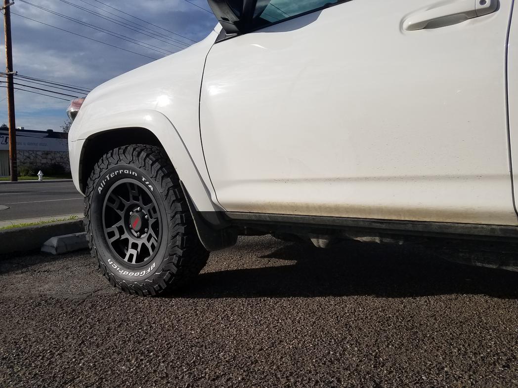

Happy to hear it didn't rub for a lot of you, I jumped on a set and got them installed. Unfortunately for me, my fronts are rubbing when I lock the steering, and they rub before locking the steering if under braking. I guess I'll have to stick my head in there and see where they rub and how I can make more room.

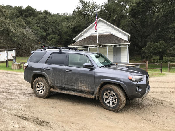

2016 TEP running BFG KO2 275/70/17.

It's because of the TRD Pro wheels. Read this thread for some answers.
http://www.toyota-4runner.org/5th-gen-t4rs/231362-2016-trail-275-75-17s-rubbing-thought-id-ok.html
I was under the impression that the Trail and TRD PRO wheels are the same size: 17inch x 7inch. The linked thread used a rim that's 1-inch wider than sock. Is the TRD PRO wheel pushing the rubber further than the Trail wheel? I guess that's about the only reasonable explanation I can come up with.
The backspacing is different, essentially like running a small spacer. Even though the TRD Pro wheels are 17x7 they have a different backspacing then the OEM SR5 and Trail Wheels. In that thread I mentioned for you to read through, Post #4 by [MENTION=66316]1engineer[/MENTION] highlights the issue, and in post #5 there is a link by [MENTION=120065]BlacknTan[/MENTION] that explains the port modification they actually have to do to TRD Pro's at port. To run those wheels it requires a fender liner modification and slight bumper trimming. That's why you may notice a pattern in this thread that everyone who is stock with stock wheels running 275's has no rubbing issues, but most people running 275's with aftermarket wheels including the Pro wheel are mentioning at least minor rubbing (and if they haven't noticed it they likely haven't run their suspension mostly compressed and then had to make a full turn).
