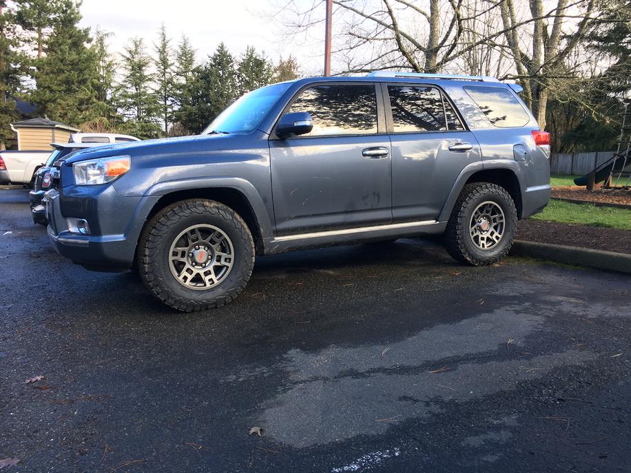

Just put them on, a little rubbing that seems to have been fixed by removing the mud flaps and pushing the front fender liner forward a bit.

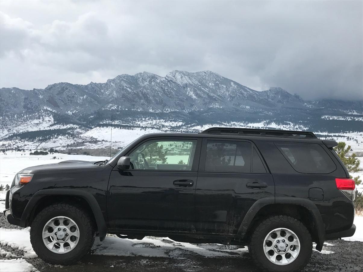

Spotted a stock 4runner in a parking lot and to a photo for comparison

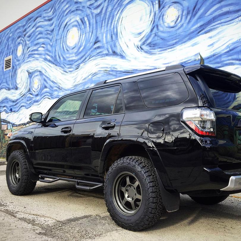

I got these 265/70/17 C rated and they are a good proportionate size IMO..
275 looks like the perfect size to line up outside of tire with edge of fender. Wish they came in C rating...
