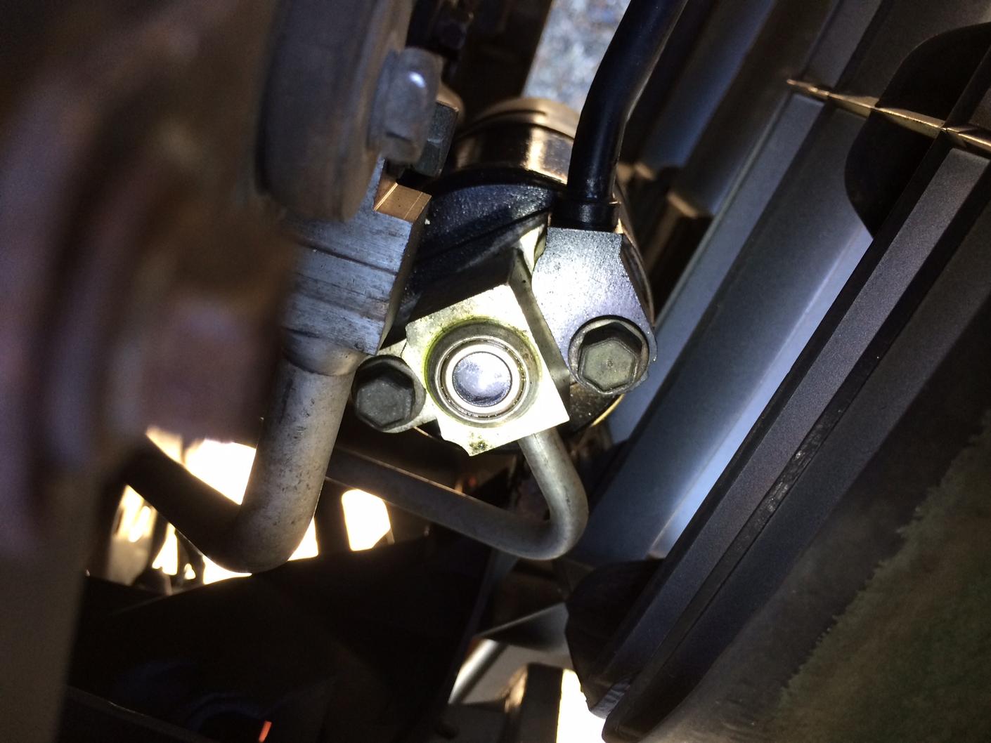

anyone had ac leaking from the sight eye?
Deezil
Just noticed today my ac coolant is slowly bubbling out around the sight eye, lame, any way to fix this, anyone had this before?
Oh man what a pain. I had that happen to me on a commercial kitchen walk in fridge. You might not like the news but...
That sight glass/line needs replaced, a seal has gave up letting refrigerant and oil escape.
-The refrigerant needs to be recovered (EPA rules)
- Repair/ replace defective part
-With a set of AC gauges, Pressure test system with nitrogen to check for leaks
- If no leaks present than pull a vacuum on system to rid of any air and moisture( the enemy of ac systems)
- Re charge system correctly with refrigerant.
