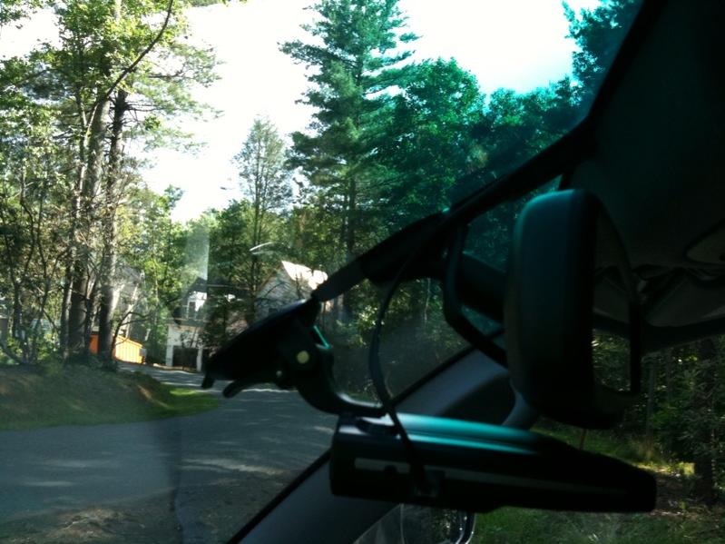

Escort passport 9500 hard wired with escort suction mount
I wanted a better suction device because the little suction cups kept coming loose, especially with hot days. I bought this new 20 dollar suction mount from the escort website and its very sturdy. I had looked at the alternatives that were mentioned, but 100 was quite expensive. I used the hard wire kit from escort, and ran it across the top of the windshield, down the pillar and into the fuse box.
I have a hard time believing that setup doesn't interfere with everyday visibility. I routinely have to look around the rear-view mirror to see other vehicles at stoplights and stopsigns...I can't imagine having something blocking my view 2 inches below it.
Move the whole setup down another inch to get the detector level, and you're gonna have visibility problems unless you're < 5' 4".
Nice choice on the Escort detector, though.

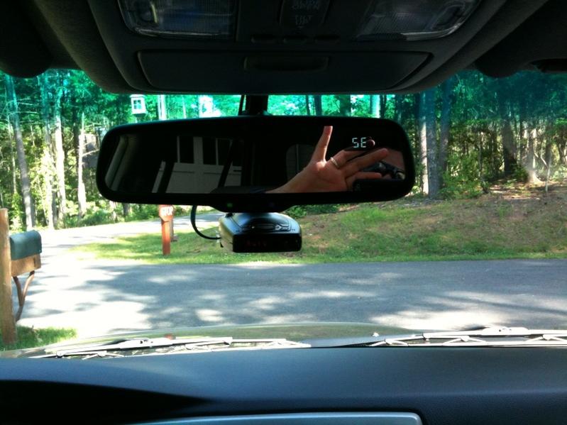

Finally wired the 9500i this afternoon. I used the $20 "SuperCup" mount method instead of the blend mount - couldn't stomach the price tag. I wanted to be able to use the SmartCord that comes with the Escort (instead of reaching up to mute it) so I bought the hardwire kit for $30.
Had to take most of the dash apart but it was educational. Ran the plug end up the RH pillar, under the headliner, and down the mirror mount. Ran the mute button into the back of the cubby under the AC and mounted it right next to the AUX input.

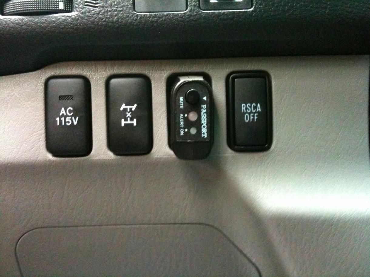

Silence button mount
Decided to install the remote silence button in the blank to the left of the steering wheel

Dennis, I did have to sand down the top and bottom so I could force it into that blank. Please post pics when you get done.
