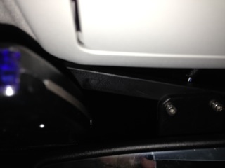

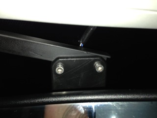

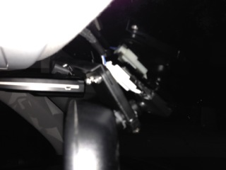

I had this setup in my former Tacoma, had a guy make me a mount and then I made a offset arm for the detector, then used mounted the remote mute switch and box on left side of dash by the ac vent and dash, I was able to route the wires between the panels.

That's an interesting method. I don't remember how much room is available to the side without interfering with the sun shade, but if the center console doesn't work out, I'll look more into something like that mount.

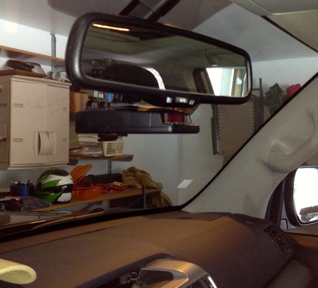

I just installed the blend mount. It looks pretty good. Sorry about the poor quality phone photo.

You will find a fine line between using the sunglass holder and the sun visor, I opted for the holder the sun visor will not come down all the way. I wanted to mount under the mirror but since I drive places that don't allow detectors, I went above and behind non metallic tint.
