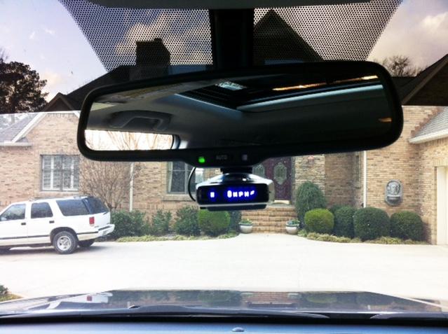

Took the plunge and did the blend mount. I really like the clean look. I'm sick of having wires everywhere for all my gadgets.
Here's a side view of how high it mounts under the mirror.

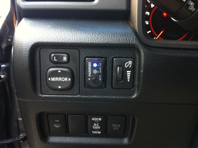

I mounted and hardwired my 9500ix a few weeks ago, and finally got around to posting some pics. I got lucky and got the blendmount and hardwire kit for free, from a car that we got from auction at the dealership, and they let me have it. Everything was pretty simple but I wanted the remote to look as clean as possible, so i took it apart and dremeled it down to make it fit in one of the blanks. I thought it came out pretty nice, just thought I'd share it with ya'll.

How did you get the mute switch to look so flush? You said you used your dremmel, but did you take off the original plastic housing? It look so flush! (<--- Jealousy) What is the plastic surrounding the switch?

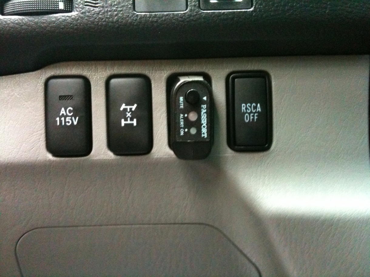

I took the remote apart and had to grind down the circuit board some then dremeled out one of the blanks to hold everything, then glued and clamped it together, placed the original sticker on the modified blank/remote.
