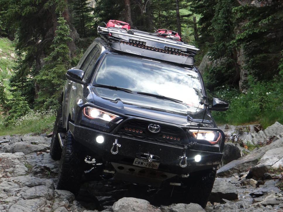

I put Mini Morimoto in place of DRL

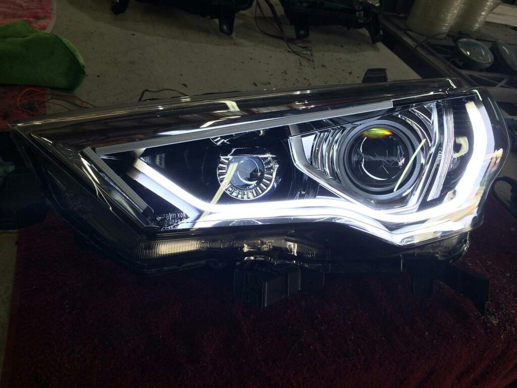

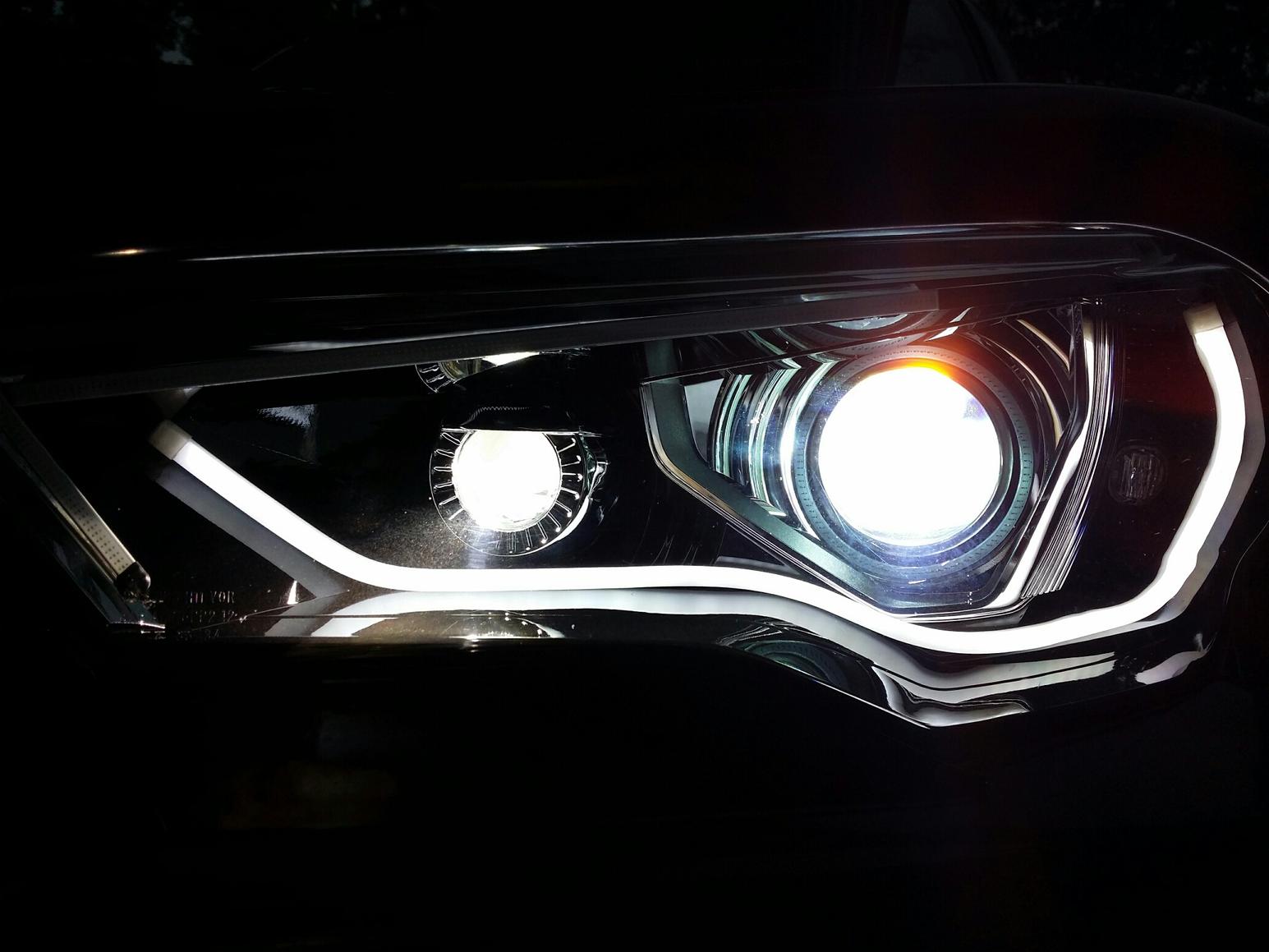

What I love about TRS is the detail. If you look closely at the low beam projector, you will see it has "Unlimited" etched on the surface of the lens. It can only be seen with the lights off. But details..thats TRS

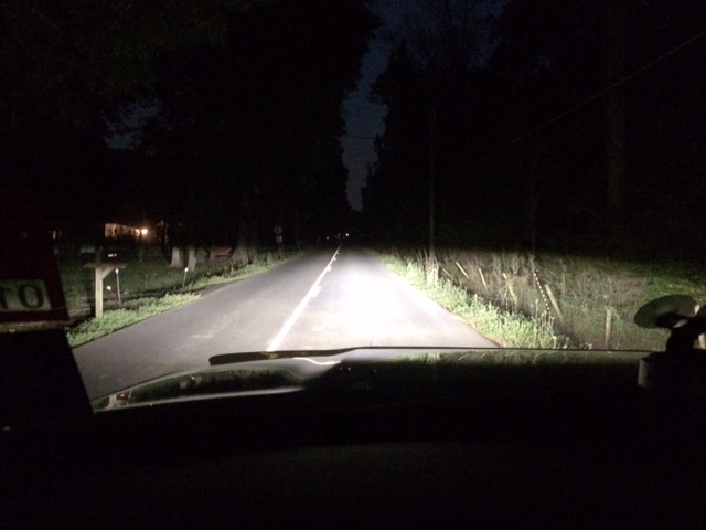

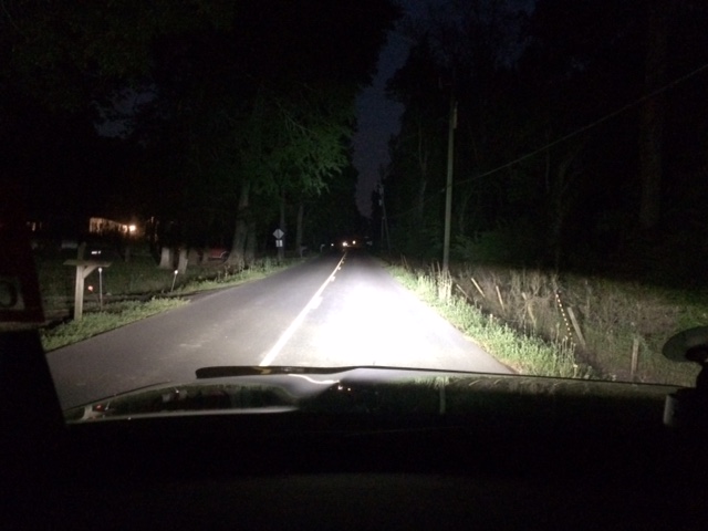

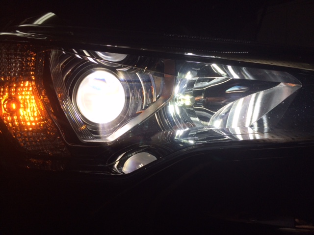

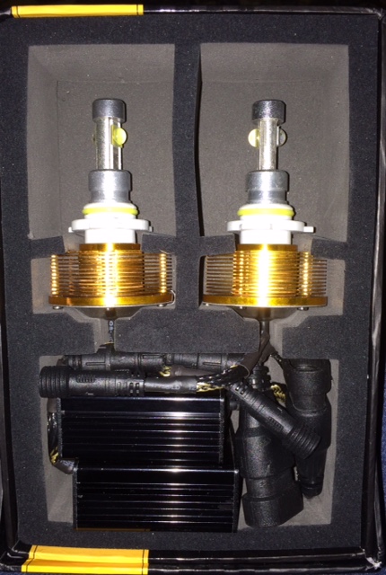

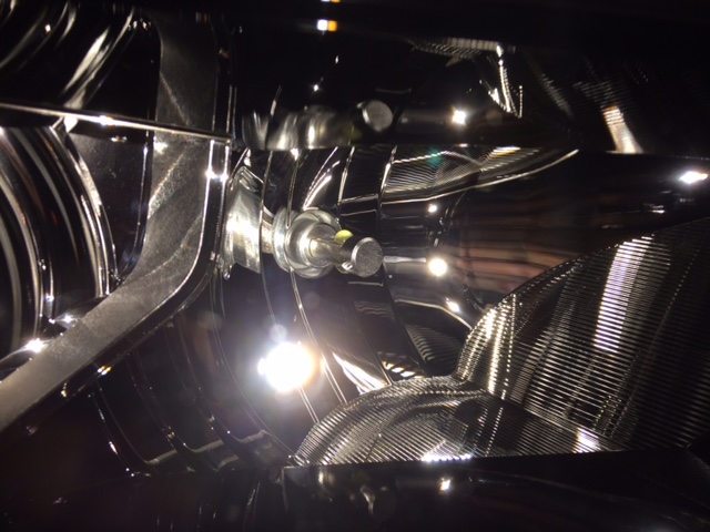

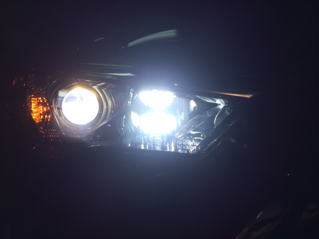

I received my TRS Morimoto XB LEDs today, Installed them so here are some pics. in this order:
1. TRS Morimoto XB LED Headlight in the Box
2. TRS Morimoto XB LED Headlight Installed
3. TRS Morimoto XB LED Headlight - Lit Side View
4. TRS Morimoto XB LED Headlight Frontal
5. Low Beam HIDs w Morimoto LED Fogs
6. Low Beam HIDs w TRS Morimoto XB LED High Beam - no Fogs

Looks great! How much brighter would you say they are over oem? In your pics the color between the hids and these is a little off. How are they in person?
I replaced my 9011 HIR Philips bulbs with these, so I had slightly brighter bulbs than stock 9005's, but they were still halogen yellow!
As far as brightness, they are probably as bright or brighter than OEM 9005's. A halogen filament & glass bulb emits light @ 360°, even though these are bright as seen in the picture, the 2 - 30 watt LED's on each stem is at the top and bottom of the stem so you are not getting quite the same coverage of light to the reflector as a halogen bulb.
That being said, the color, when on appears to be very white (no yellow light anymore) and not blue to the naked eye as it appears in the photo.

From pic5 vs pic6, these weren't that bright, minimal difference between the 2 pic, a little disappointing. What do you think?

I don't plan on running them as DRL's, so I didn't take any pics.
Realize they are filling in for Low HID's and the LED Fogs are off when the High beams are on.
They are throwing more light forward and higher than the HID's are projecting with the cut-offs.
