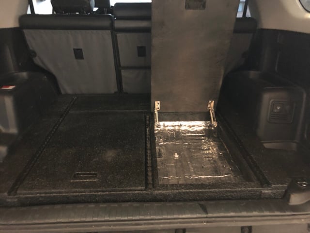

here's the set up i built for my trip to utah in november, 2 slide out drawers, a slide out "tail gate" to cook on and a hidden compartment that is under the bed i put all my expensive gear in. Was able to fit a Queen size 4" memory foam bed topper. slept great
[MENTION=164977]tahoe.nick[/MENTION] -- that looks great. where is the hidden compartment and is it easy to access (but not easy if you don't know how to use it??)
I'd love to hide computers and camera gear not immediately in use...

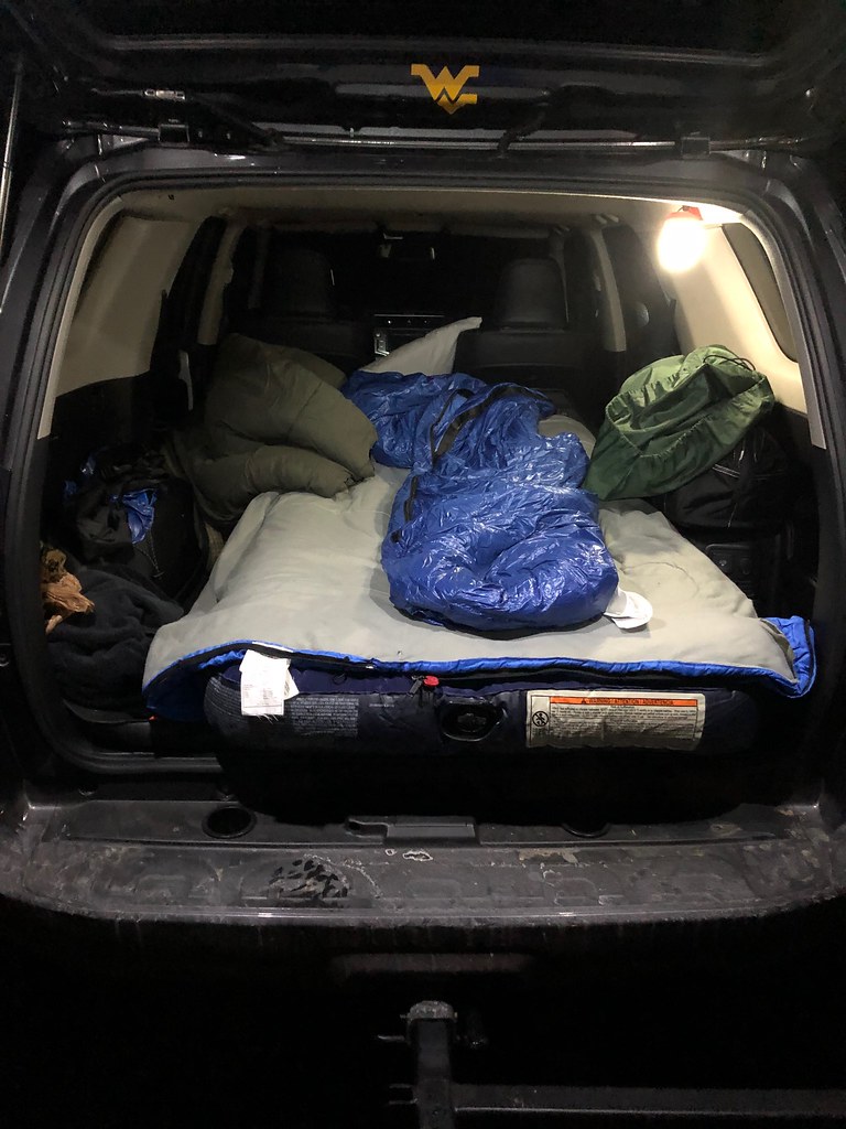

Slept in the back on a twin air mattress with a few sleeping bags and I was comfy.
Been meaning to build a little sleeping platform to level out the hump when the seats are folded down but I didn't even notice with the air mattress blown up. Maybe it was all the whiskey :beer:

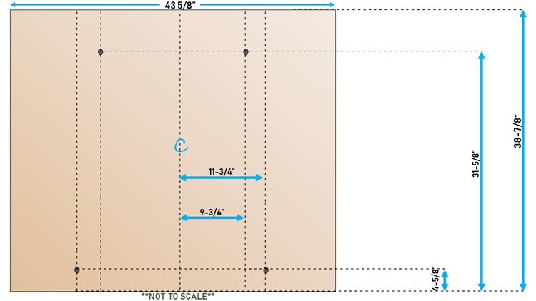

I just finished mine this weekend. Here's how I attached it; can shoot you measurements if you decide to go this route:
Cargo area "flat plate" mod bolt holes
Please do - I'm trying to figure out the easiest way to attach to the vehicle. Thanks!
Also, right behind the rear seats, there is a piece of plastic that angles down that covers the back of the seats and creates a small ramp down to the actual back of the car. Did you have to remove that, or does your platform just sit on top of it?
Here is a stripped down sketch showing the bolt locations I used and overall size of the plate. Keep in mind, I have no KDSS/XREAS/3rd row or factory cargo plate.
I ended up keeping that ramped piece in place. In the pictures on the post I linked to, you can see where mine starts and stops. There isn't room to go any wider. If you shift it toward the front any more, the rear seats won't fully recline. If you shift it toward the back, it is getting close to the lift gate, and then you start to create a gap between the plate and the rear seats. The thickness (height) of the whole unit will depend on whether or not you remove the carpet/foam underlayment. Good luck!
