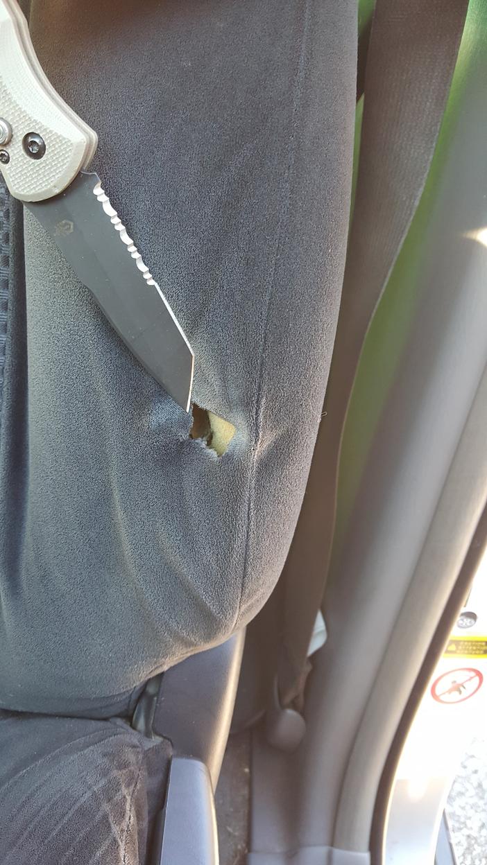

Luke, take pics if you can. I am wanting to do this with my driver seat for other reasons, like this hole that showed up in the fall.
