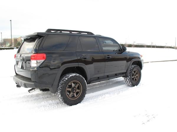

And on that note, the 4Runner below is on these forums? Ntur4 is the member name? Looks amazing!
Hey FN u guys should also consider some flat face BFD's, not just concave.
She was on here a long time ago. Those are the volks though.
Oh I know those are Large PCD Volks, I had a set of TE37's on my car.
So that's the same 4Runner that was posted above by Harper?
Didn't think 18x8 +20 and a 295 wide tire could work clearance wise
