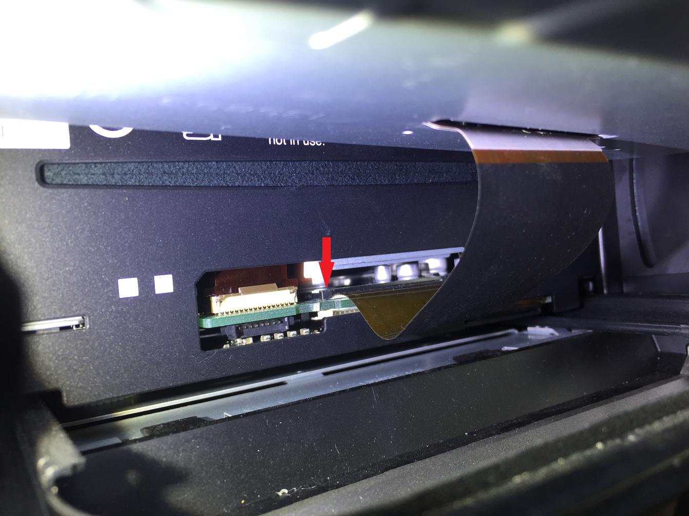

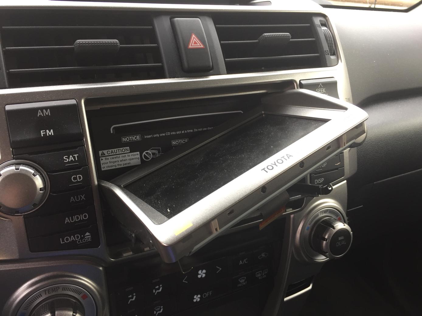

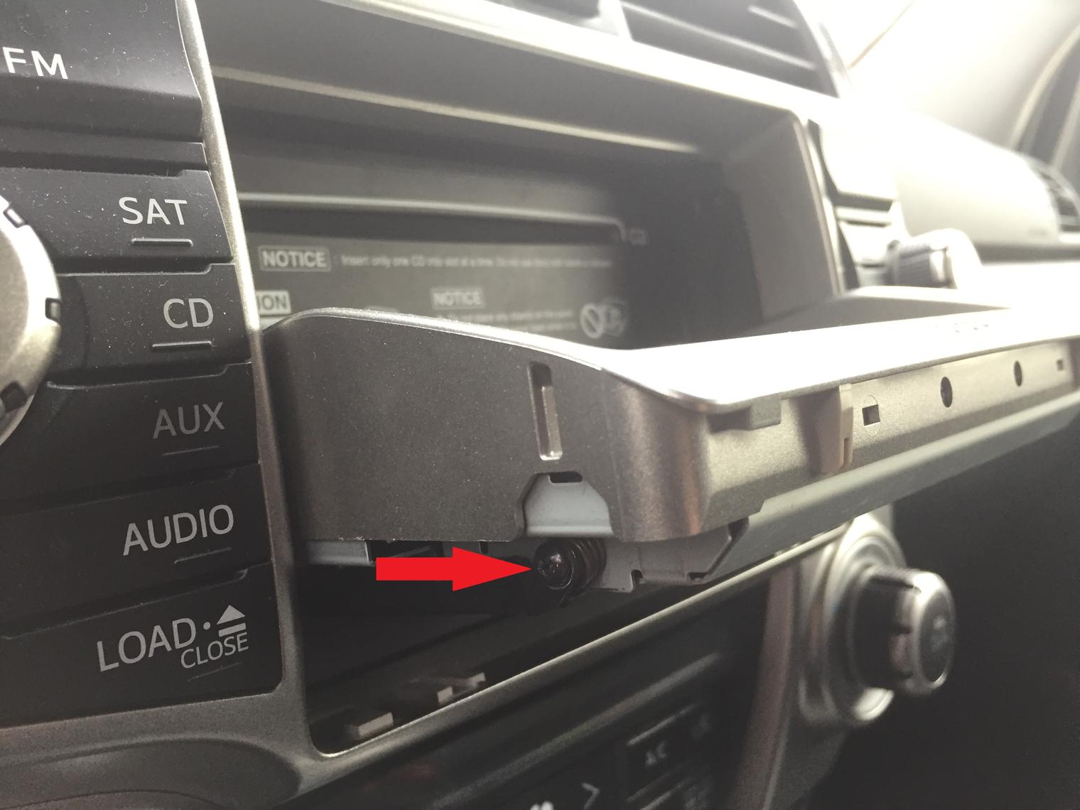

Flip the display unit open and disconnect your battery while the display is lying horizontal. Remove the 2 pivot screws on the bottom of the display unit. They are thread locked so it will be a little hard to remove it at first.
Slide the display unit up so you can disconnect the ribbon from the main unit. Disconnect the ribbon by pulling the black tab towards you.

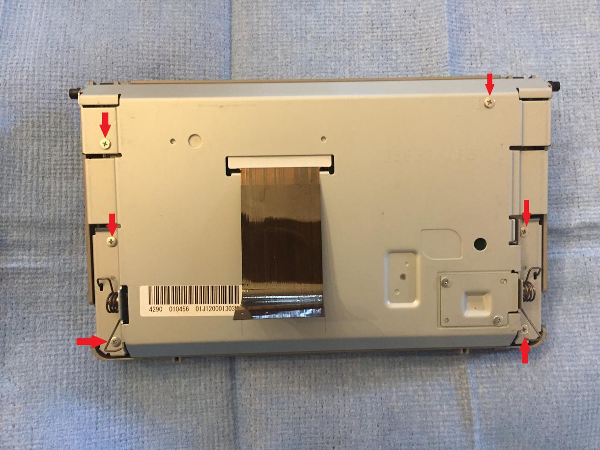

Remove 6 screws (PH#0) and slowly separate the metal back plate from the plastic face plate. The face plate clips in on the top and bottom.

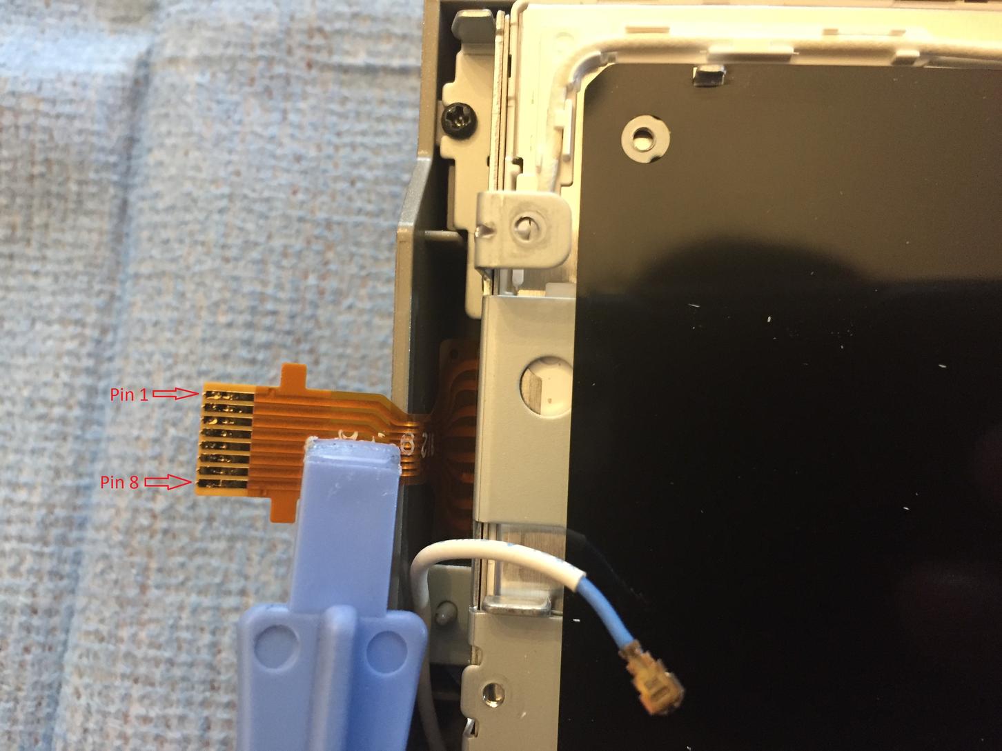

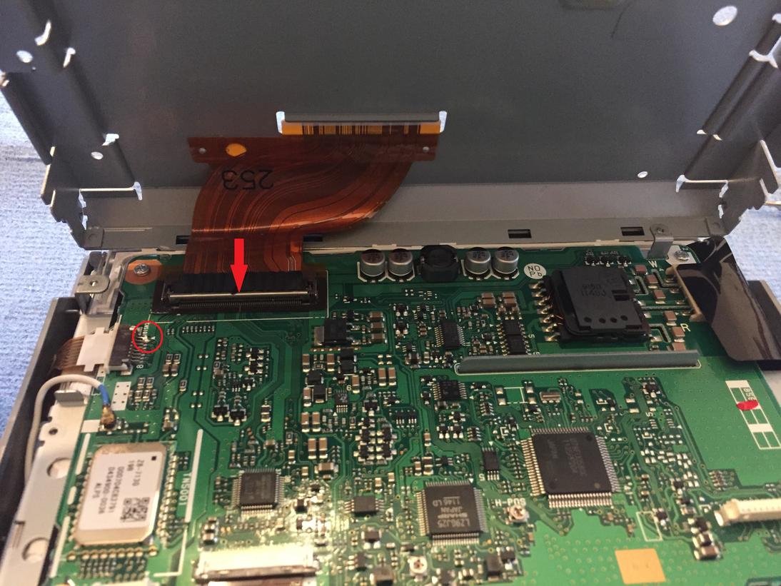

Lift the bottom of the back plate up and disconnect the ribbon by lifting the silver bar up and sliding the ribbon out. You can see I bridged (soldered) pin1 and pin 2 since the trace for my pin 1 is severed on the touch screen ribbon
Use a multimeter and check continuity between pin 1&2, 3&4, 5&6, 7&8. If one or more of the pairs are open then you can bridge those pair on the logic board.
