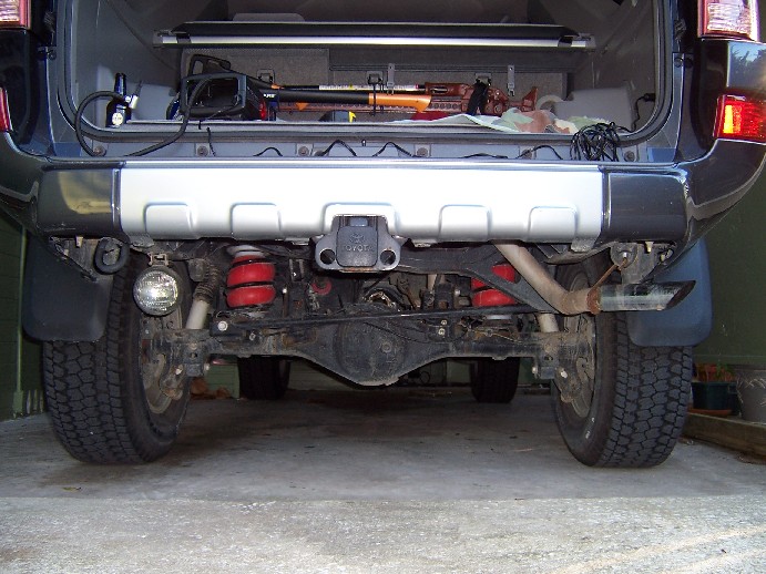

Just a basic Pep Boy's $10.00 tractor light. Have 2 on the frame as well facing to the side. Back light bolted directly to a threaded hole that was in the DS frame rail.
If you look close you will notice that I relocated the plug in for the tow lights to clean up the back a bit.

Nice thanks, does the light come on when you back up? Where did you tap into the 12v and constant power? Thanks
Here is what I have installed. PIAA L105 Xtreme Position Lamps. They dont put off as much light as the ones you mentioned about installing, but it does brighten up the ground more than just with the reverse lights alone.
For 12v power I tapped into the trailer harness and grounded to the frame.
The yellow center one... Youll know it when you see it.

How did you attach the lights? Did you drill holes into the rear bumper or the metal piece? Thanks
Drilled holes to the bumper. Those lights are not very heavy at all.
The lights had 2 wires, one ground and one power. Grounded to frame and ran the power to that yellow reverse wire in the trailer harness. Very simple install.
I'll probably end up getting some that put off more light eventually but its not that big of a deal right now. When I get new ones I am going to add a switch to the install so they dont come on every time I back up.
No I figure the ones I buy will come with a relay and that involves more than just running another wire up front.
