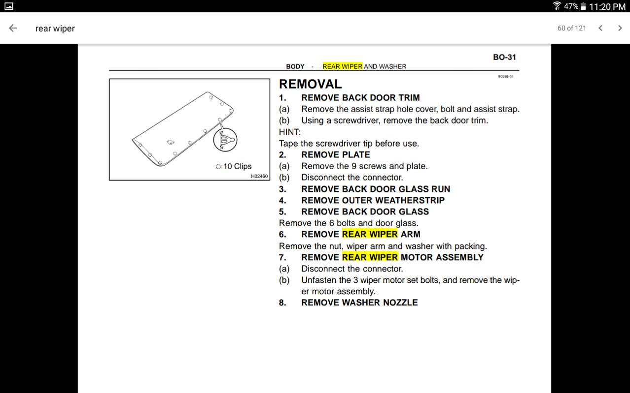

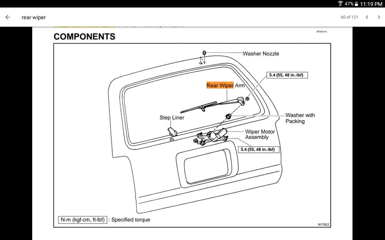

Thank you! I searched for a few hours trying to find an exploded picture of the liftgate with part numbers and never found that one. Looks like it’s from the fsm. Thanks again I’ll see if I can find a wiper motor!

How do you get the little plastic cover back from that area to even access that nut? Mine is so stiff it will break before coming off.
What I do is take plastic trim pry tools (you can buy them at harbor freight) and I start where ever I can slide the tool in and then gently until one of the red clips pop. It’ll seem like it’s about to break but they’re pretty sturdy.
