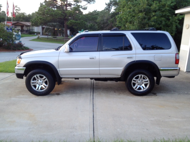

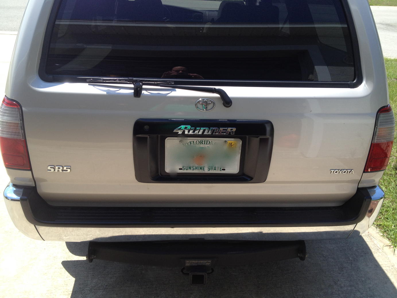

You should do a search Shadow as there was a similar thread about painting plastics not to long ago, may be a ton more info, so sorry if this is redundant. Anyhow, I used Rust O Leum "paint for plastics." Worked great on my rear bumper cover, flares, rear tag surround, and front valance. Cleaned all of them with Simple Green first then 2-3 coats. Mine has lasted a year so far without any sign of fading yet... Guess we will see. Hope this helps.
Looks flares in that pic look good! Has me thinking. Now.....
