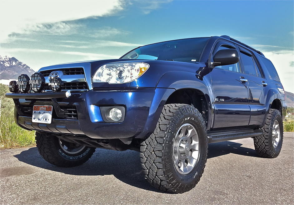

Here's some on my dad's 05 Galactic Grey with Billy 5100's at .85 on 265-70-17 Duelers.

Hard to tell from the pics, but how much more are the wheels pushed out over the stock wheels?
Pc-d TE wheels
17 x 7.5 offset is bout 1/2 more give or take still have my spidies on .

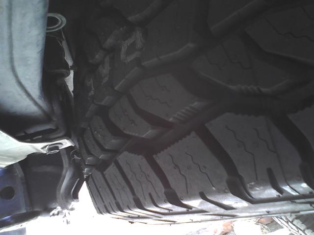

Yes I have tight fit but it does , not sure if you tow the receiver would be able to lock in but since I don't no problem . Will get a pic of it today
I was just kinda curious, I also have 275/70x17s and they just barely fit, gotta push'em up in there.

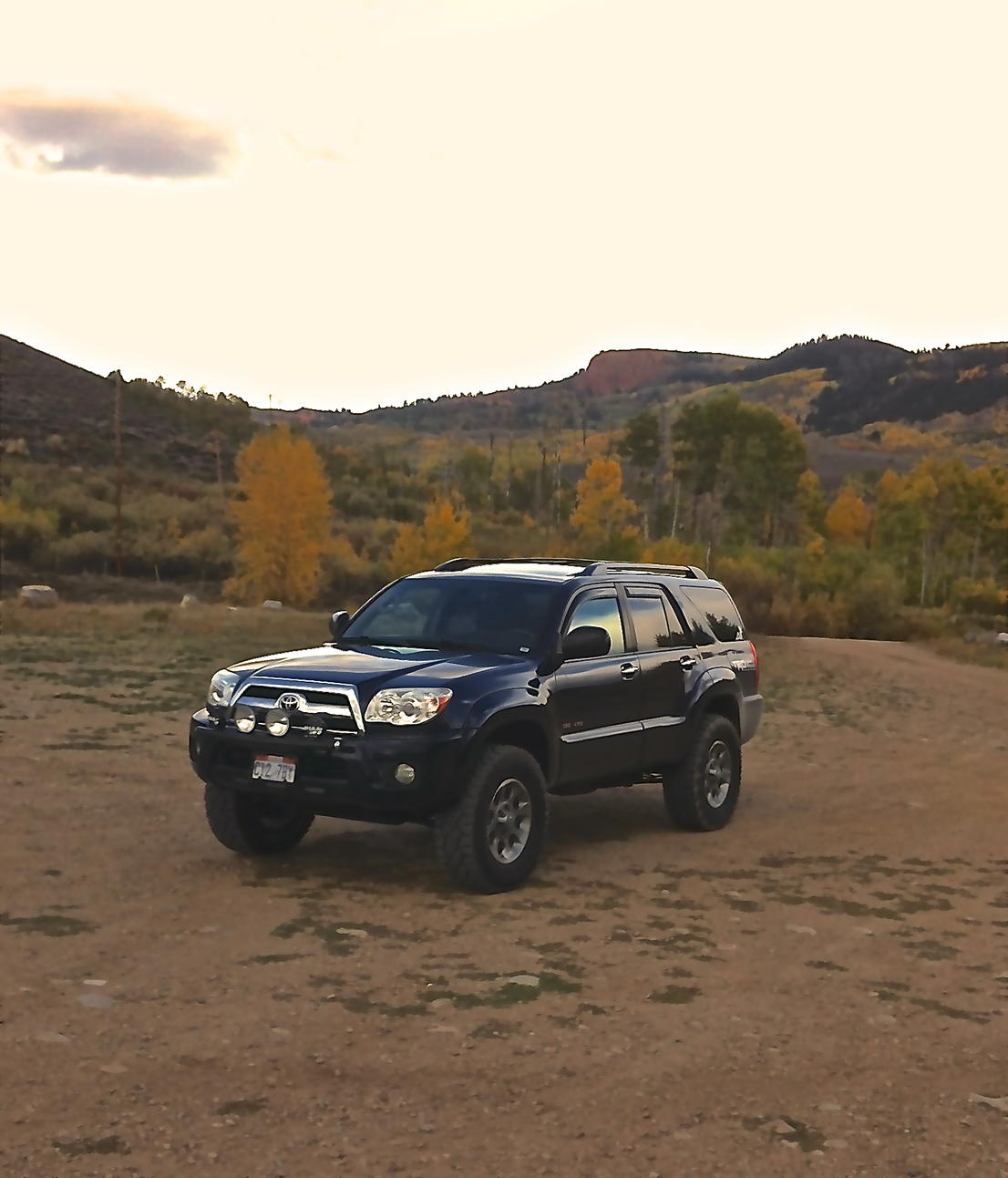

Thought I would add a updated photo. The pic on page one was about 14 months ago. Removed the Running Boards, Added a Lift, 285's, Wheel spacers.

00328 hope you can see how tight the spare is crammed n there !

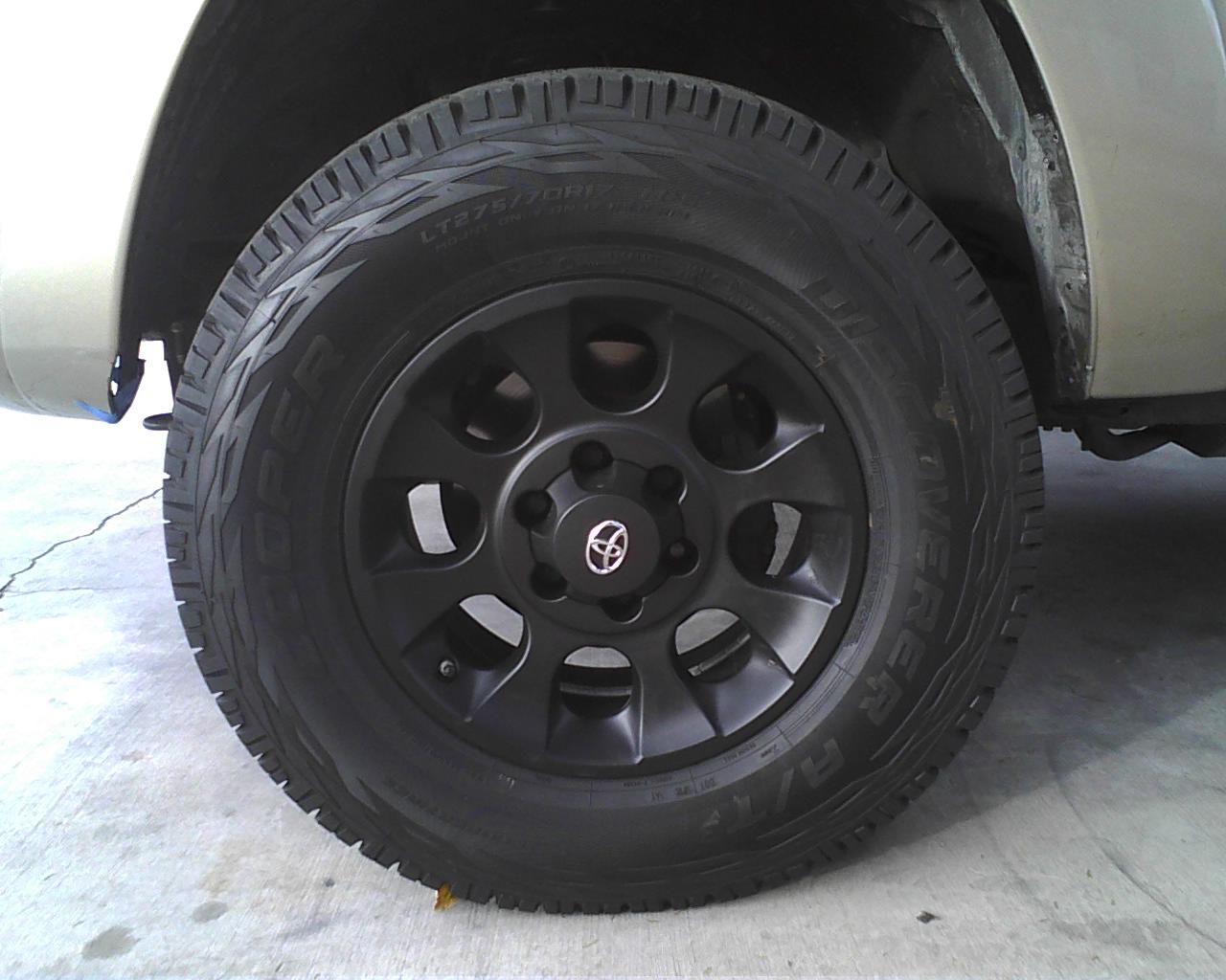

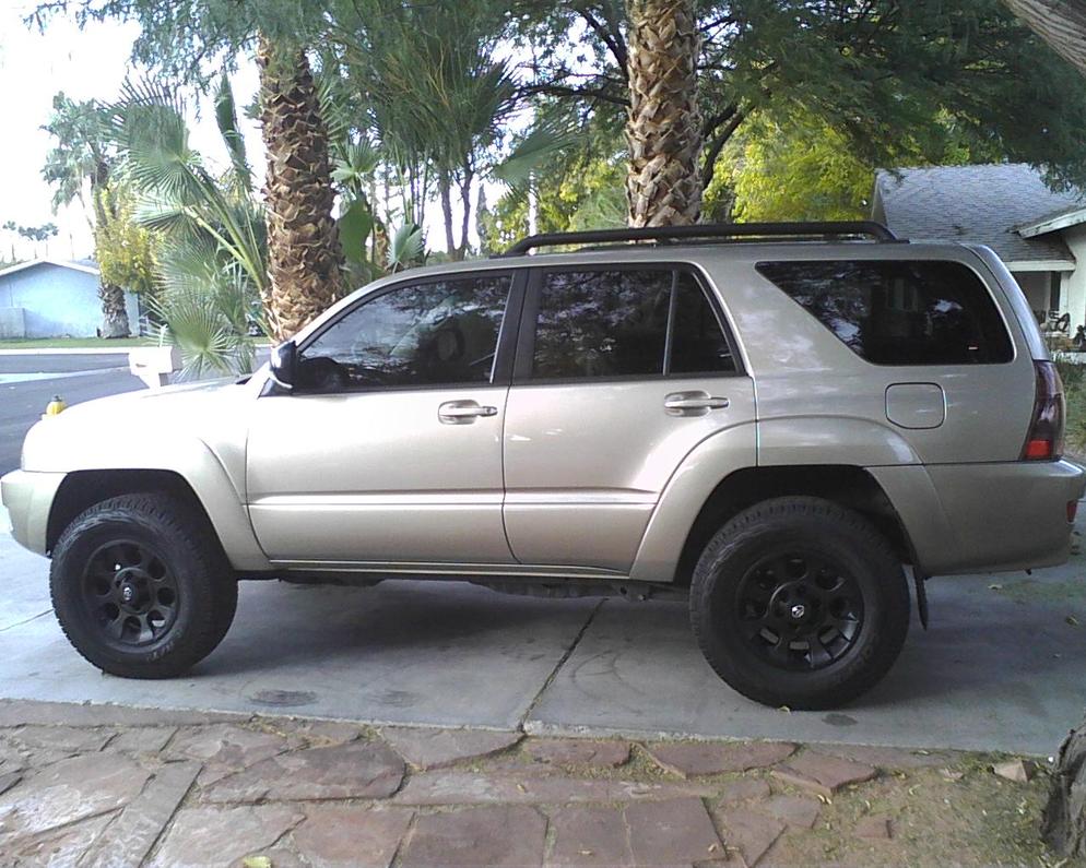

I bought some brand new 2013 4runner trail edition rims for $220 on craigslist.
They are at the powder coaters right now getting colored matt black. I will post pics when I get them installed next Monday along with BFG MT KM's.
I sometimes like these wheels and sometimes don't. But at $220 for the entire set I could not pass it up since I needed to upgrade to 17 inch wheels from my oem 16's.

Damn run like you stole em cause you did !! Remember about tpms gasket kits better to change them out & since got awesome price get em before mount wheels .
