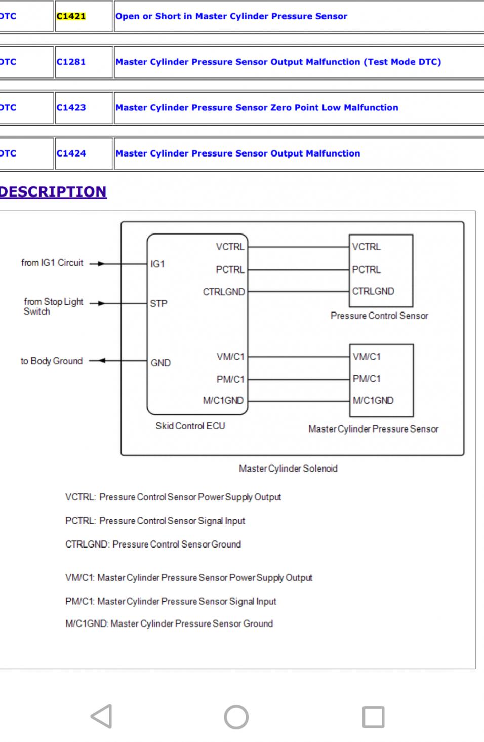

jp3, looking at your toyota service manual link, looks like it is purely ABS (VSC is on just because of ABS). for ABS then, we have: 1421, 1422, 1423, 1424.
That makes sense. All those codes relate to the master cylinder pressure sensor and master cylinder pressure control sensor. So you would want to test that circuit and the sensors.

They are inside the abs control valve/pump assembly, unfortunately. I've never rebuilt one myself but I'm sure that's an option. There could be a problem in the actual wiring/circuit outside of the abs assembly. (Short circuit, open ground, loose connector pin) That's what I would hope for. If you feel like it you can test the circuitry to make sure you're getting a signal from the pressure sensor to see if it's working or if the stop lamp circuit is out of whack.

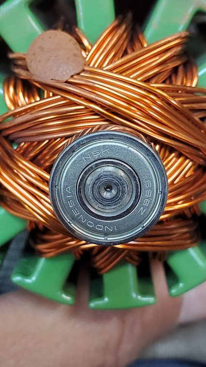

My aplogies for not reading the entire thread but I can add something. I picked up an used unit from a buddy who owns a 100 series LC and it matches mine. The only thing that wears out, from what I can tell, is the motor brushes and bearing. The motor is constantly pressurizing the brake system so it makes sense that those two items would wear out. I suppose the solenoid valve is also an wear item but they're not operating on a continuous duty cycle. Besides, they're just stupid on/off valves which aren't typically known to fail. Perhaps a piece of debris in the brake fluid would prevent a valve from closing shut completely but that's a stretch.
I took apart the spare unit and noticed the brushes weren't that worn down. You might recall that the motor sits vertically and the bearing that sits at the bottom had way more crud fell on top of it. Someday, I may replace both bearings and brushes, clean up the commutator then put it back on the shelf as a spare but good unit.
I'm disappointed that I didn't more pics but I have a pic of the actual motor shaft bearing for future reference.
I guess the moral of the story is if you have your spare motor, take it apart and see what's up. The chances of an electronic part like an ECU going bad is close to zero. Toyota simply makes robust parts that lives a long time.
I hope this helps!

No sir, that pic is of the actual ABS motor! I took my spare one apart and made the observations I listed in the post.
Anyway, might be worth a shot!
