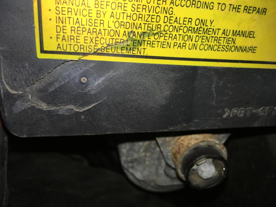

here are a couple of pics of what i discovered after the dealer diagnostic in march. i took a closer look at the module unit then, to discover serious impact cracks on the module housing! it was never noticed before. i don't know if the dealer did it, or the installer at 111k miles, or was it sold to me damaged and not noticed since. no clues. at this point, i need to replace the module.

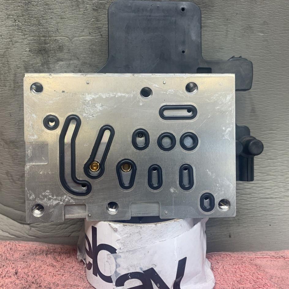

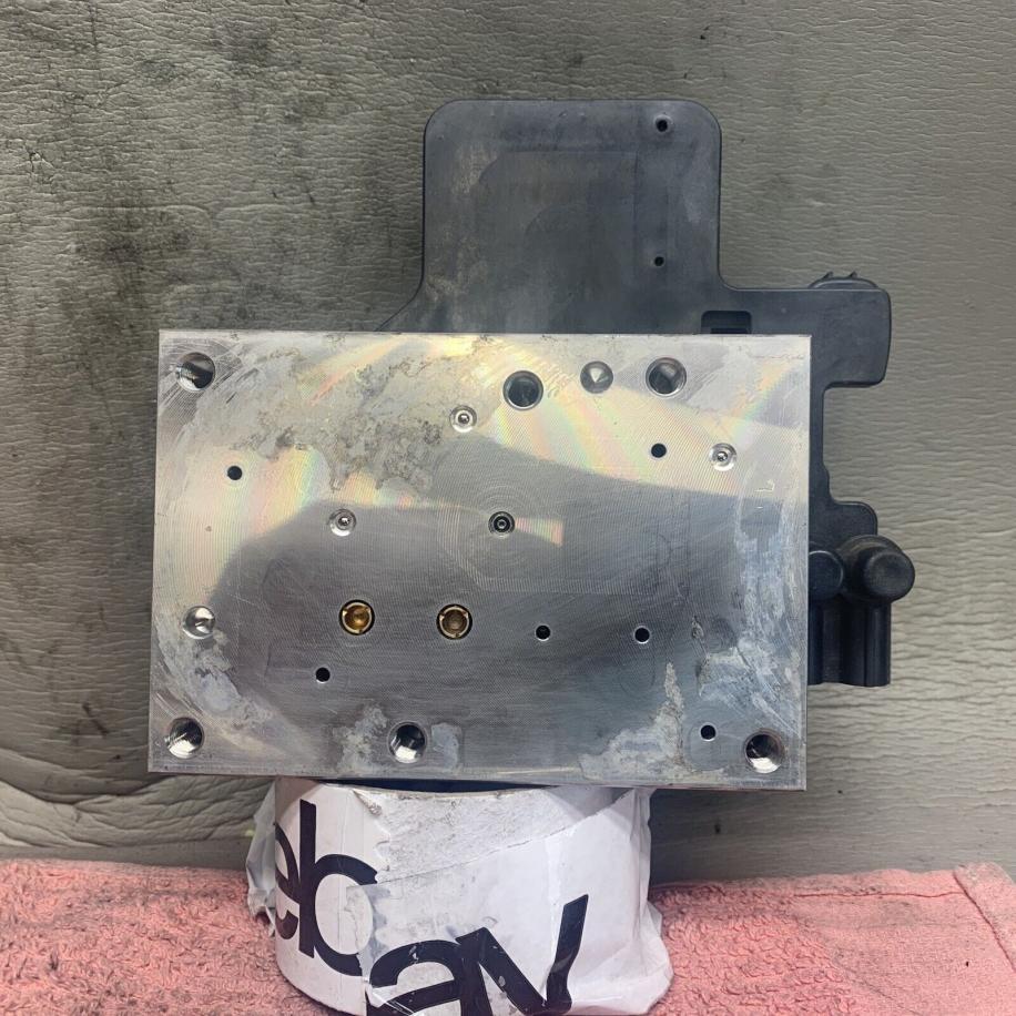

some pics of a module on ebay. maybe this will help someone explain how this mounts.

With it having oil rings on the mounting plate, it would have brake fluid going into it, so at the very least it's going to take a special service tool to help bleed the air out of it once installed I would think.
As long as the master cylinder isn't messed with most anyone can bleed the brakes after messing with brake lines, calipers, etc., but with the modern ABS brakes system, once you open up the master cylinder in any way it's going to take a special service tool/scanner to open and close the ABS valves to release any trapped air when trying to bleed the master cylinder.

someone on ebay responded and told me that to remove the module you remove the plastic outer casing and there are bolts with wires that you back off to detach from the master cylinder/booster assembly.

a little backstory on the current master cylinder. this isa one family owned 4runner, but i wasn't directly involved at 111k miles when the original started making noises. the then owner sourced a replacement at a salvage yard w/85k miles on it. because of the plastic module damage, i'm thinking they told the salvage yard they need a brake booster, and the yard sold one at discount because of the damage to the module, assuming the original module would be swapped over. that never happened, and we have been driving with the cracked plastic since 111k. over time, moisture may have entered, damaging the module. so the booster is fine, but the module is not, causing electronic flakiness. that's my theory.
