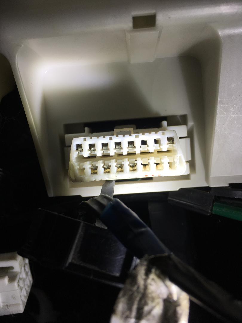

ok, took a couple pics of the OBD2 plug. i assume that is what you mean by "data link connector"?
starting at the top, count 4 in, place one end of jumper, keep counting to 13, place other end of jumper.
turn key to ON.
now, will all the lights start blinking? what kind of numerical codes should i expect? low numbers of blinks, high numbers? do i have to record each lights blinks? they will just keep cycling through until jumper removed?

couldn't wait any longer:
ABS: 4 flashes
VSC: 4 flashes
TRAC: not visible
CRUISE: constant flash
CEL: visible, no flash
Yes that's the connector but it sounds like you did it wrong. It's upside down in your truck too like mine. Here are the TOYOTA instructions. Notice the connector is a trapezoid shape. Make sure you look at it in the correct orientation. Sounds like you may have tried it backwards. These instructions show a picture of the pins to jump. The codes should be blinked in two digit intervals..
