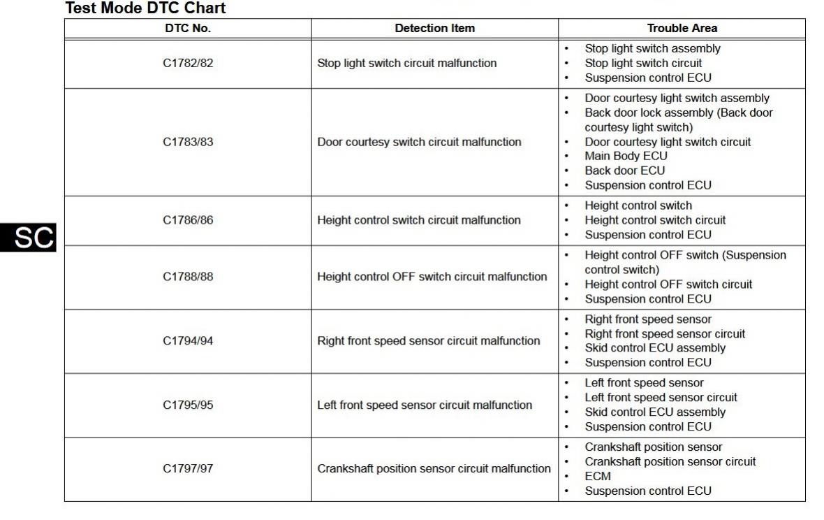

Looking at the book you need an intelligent tester to get the codes.

no codes yet. that would be through toyota. if you popped over to my other thread, you could see my efforts so far. that chart is helpful; it does mention stop lights, plus skid ecu (vsc/trac lights also on).

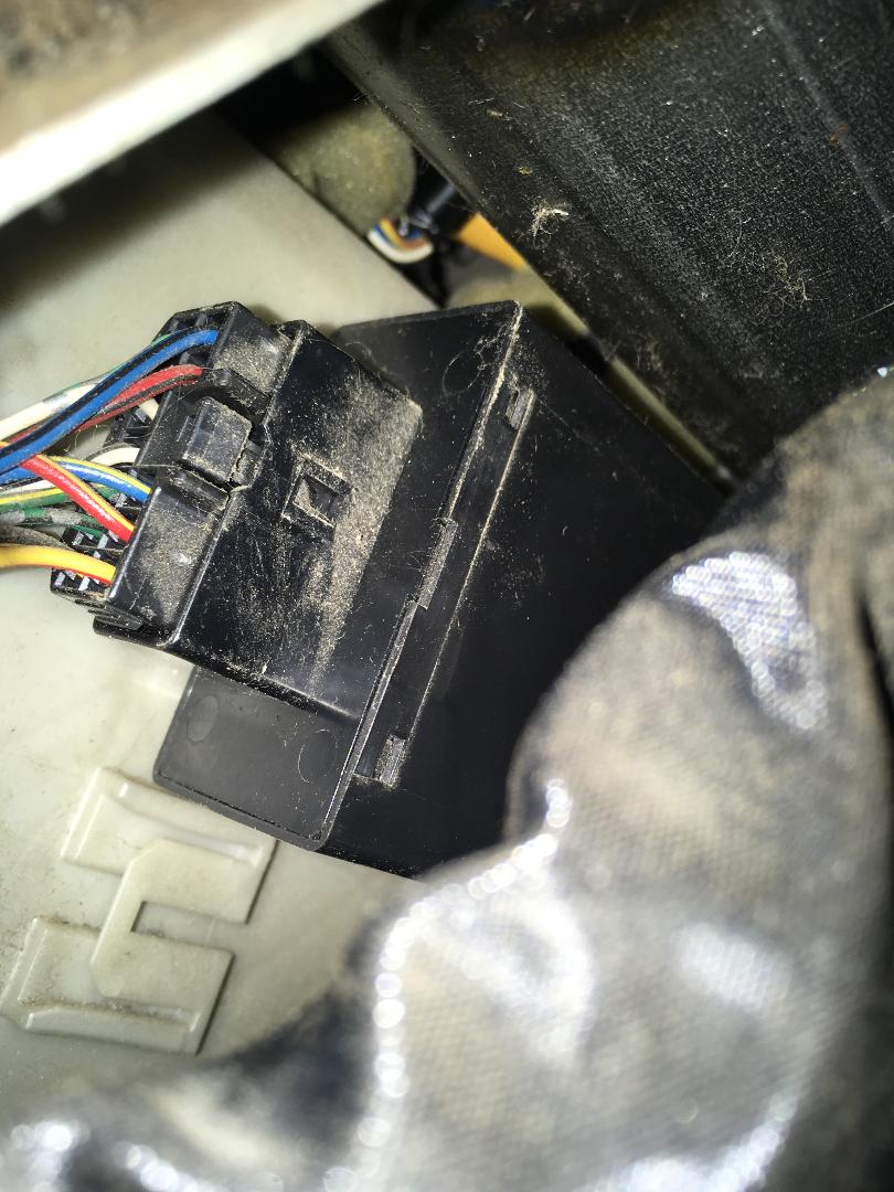

crawled into the footwell. a gray box is mounted on the backside of the fuse box. it seems to receive one of harnesses from the fuse box. is this the body control module? looks like i have to remove the lower dash, unbolt the fuse box, then access the gray box.

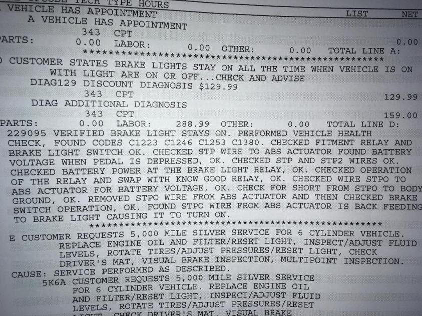

after nearly $300 in diagnostic cost at toyota, the winner is the ABS CONTROL MODULE! now i need to figure out the part and replacement procedure. hopefully, i can grab a good used part and do it myself.

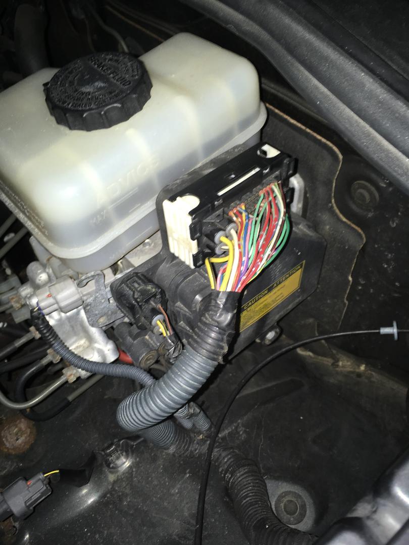

at 111k miles, the brake booster failed(another part of that abs/master cylinder ensemble). back then told it was highly unusual for it to fail at that stage. wrote toyota for assistance, got nothing. picked up a used total ensemble which included the booster for a fraction of new. independent installed. everything fine for 100k. now it seems another piece of that group, the control module, has failed. service said they may see one a year do that. strange that i've experienced two rare failures in the same location.

looked into the vehicle historical maintenance records (and my memory). brake booster replaced in 2013 w/111k miles. booster was used, paid about $150. local shop installed for about $300. booster unit, if i remember correctly, had everything on it (module, brake cylinder, fluid container, etc). when i look up new part, it says that it is included with the master cylinder. so, i might have to buy another used complete unit, instead of a separate module.
