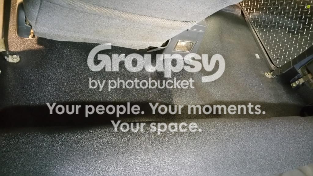

VERY interested in seeing this as I am contemplating the same setup. What type of bedliner did you use? Post up as many pics as you can!

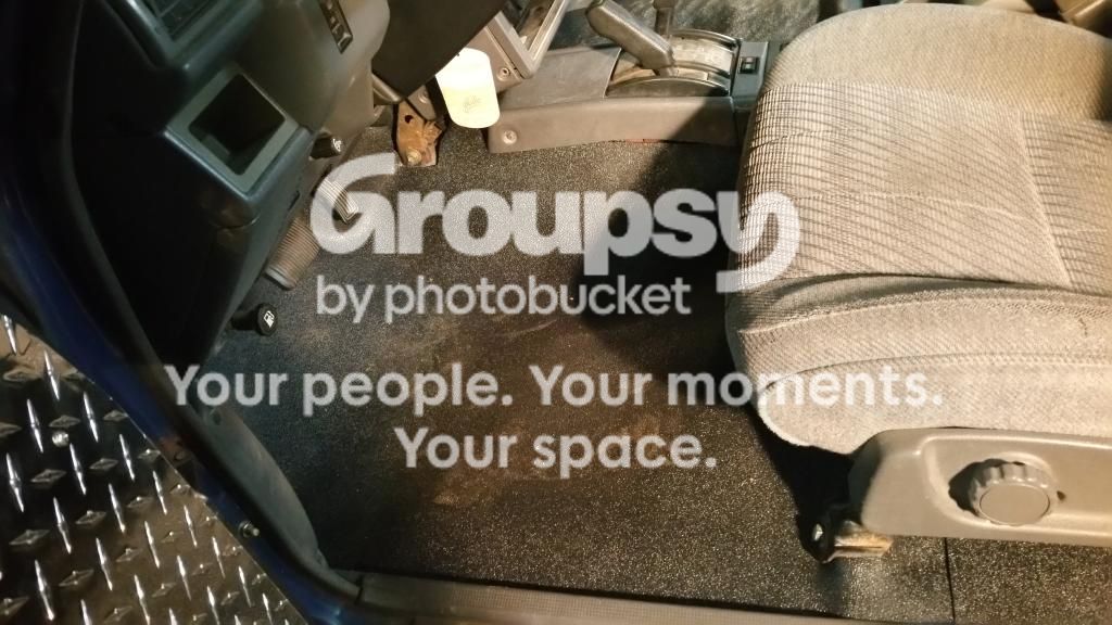

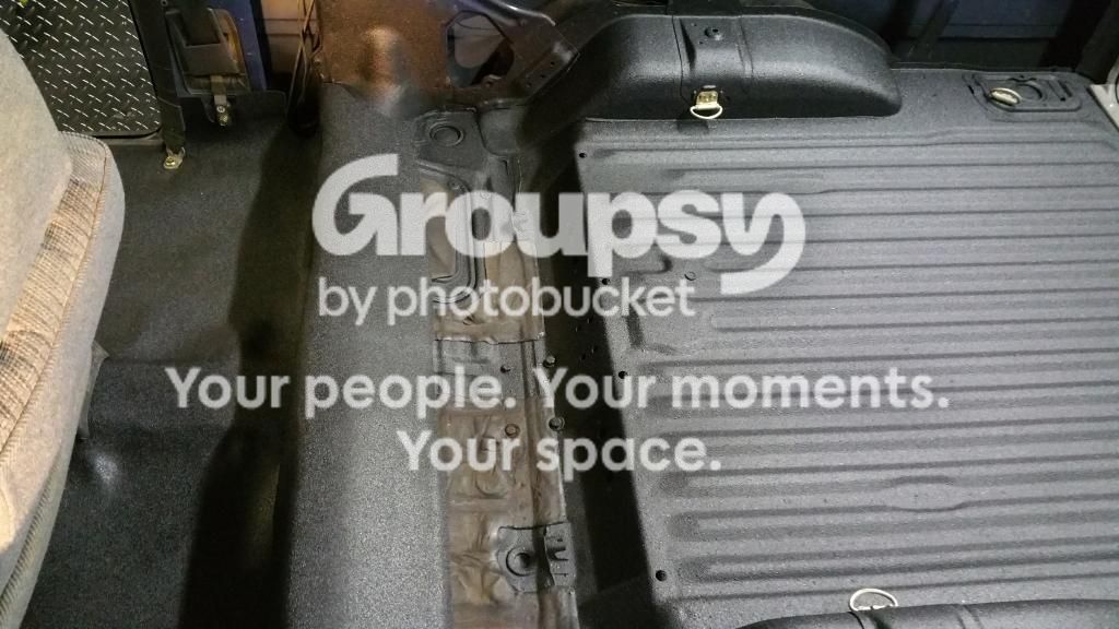

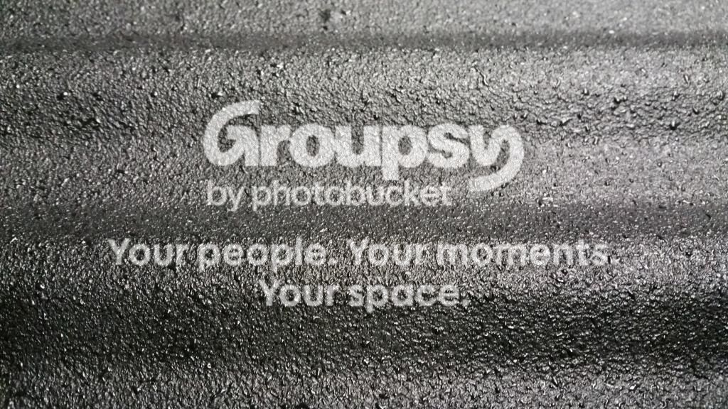

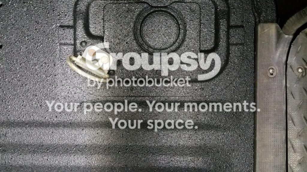

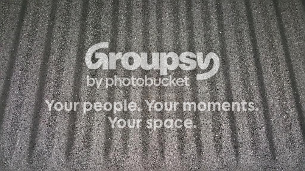

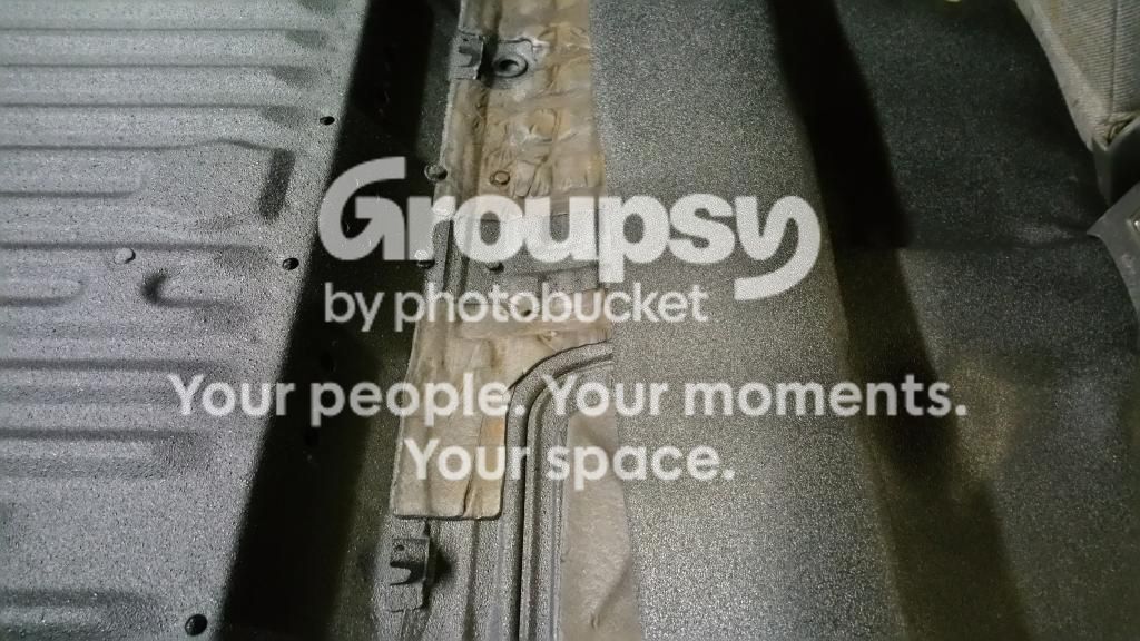

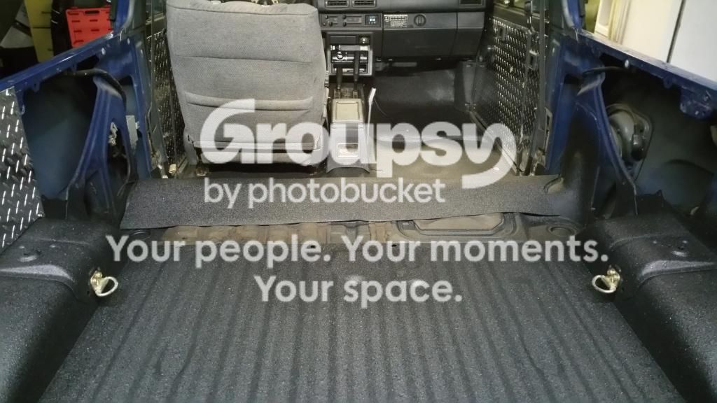

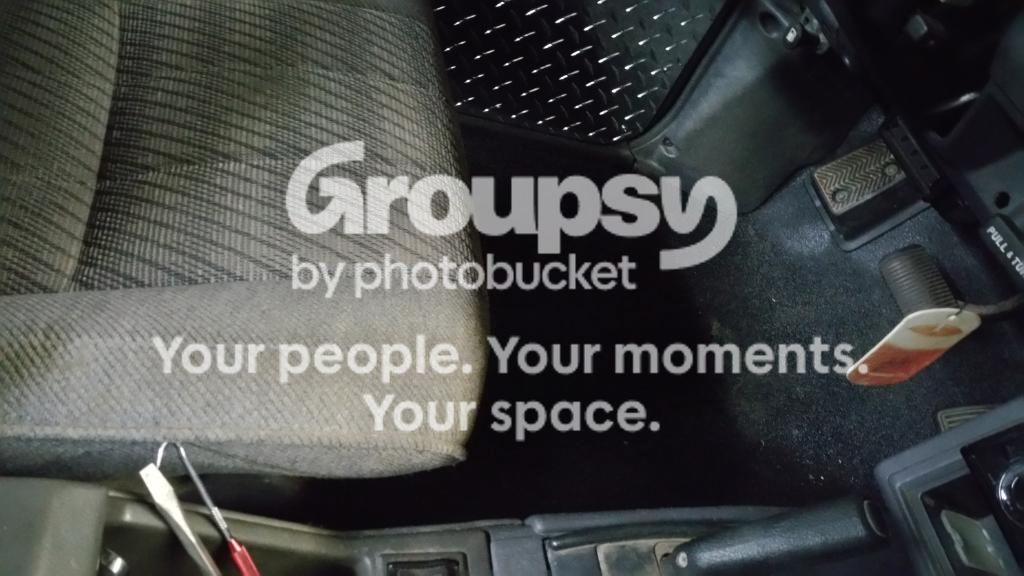

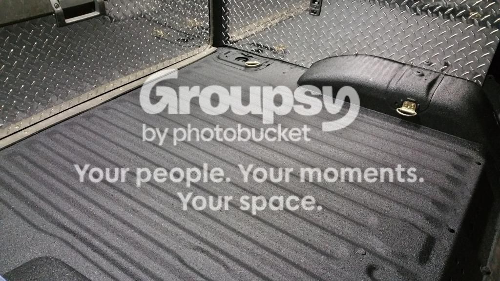

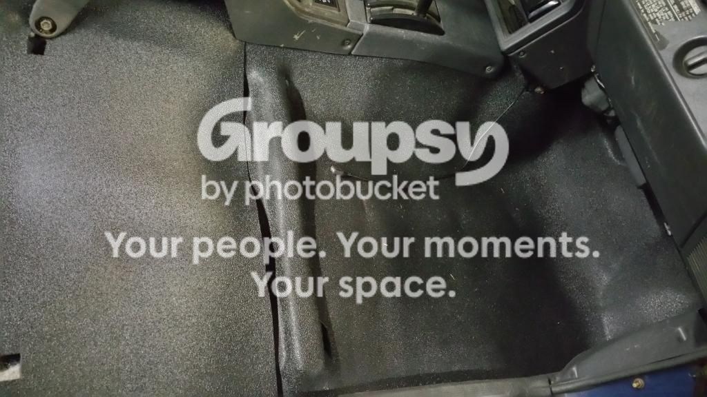

Obviously, I haven't installed the roll bar, rear seats, passenger seat, and a couple side panels yet but you get the idea. I used Raptor bed liner and HIGHLY recommend it. I tried an idea I had to get a little more bumpy texture and I like how it turned out. You can do it alot more fine than what mine is. I only used 2 bottles of the 4 that came in the kit. Allowed for 3 coats and I have enough left to do the bed of my 02 Tacoma double cab now. Anyways, here are the pics. Vinyl could use a little cleaning.
Thanks for the pics, looks great! My 88 is the same color as yours, would love to see some pics of the outside of the truck as well. Mine needs paint.

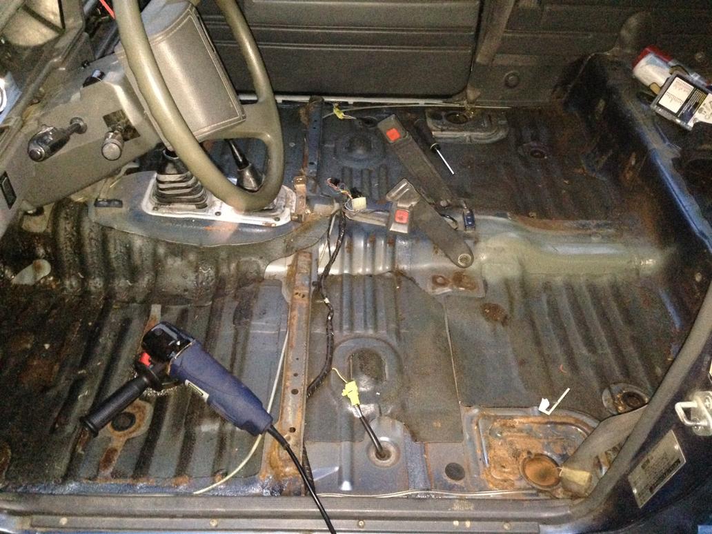

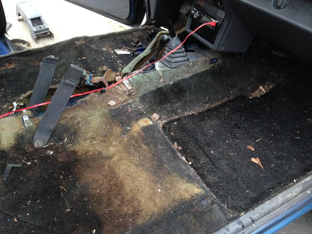

Put this on my build/questions thread but it seems relevant here too. I took the plunge a couple days ago and ripped out the disgusting house carpet the previous owner(s) put in.
Felt good when I was doing it but had a definite "oh shit" moment seeing a completely bare interior. Discovered some surface rust under there as well. Judging by all the water stains on the carpet it looks like things got very wet at some point and the carpet soaked it all up like a sponge. This resulted in some bubbly surface rust.
I'm currently wire wheeling the rust spots and re-painting with some self etching primer and some underbody paint. Then I'm going to attempt the peal n' seal insulation method chuckles used.
My biggest fear comes after that. Since the carpet I ripped out is not even close to factory, it's pretty much useless as a template. There's no way I will be able to trim and drill holes neatly! I'll attempt it but I may have to turn to a professional to clean up my mess!
