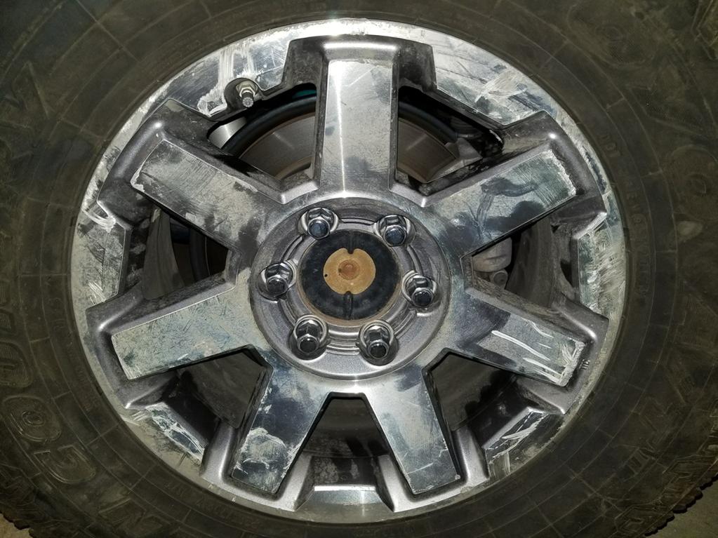

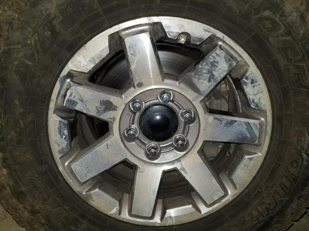

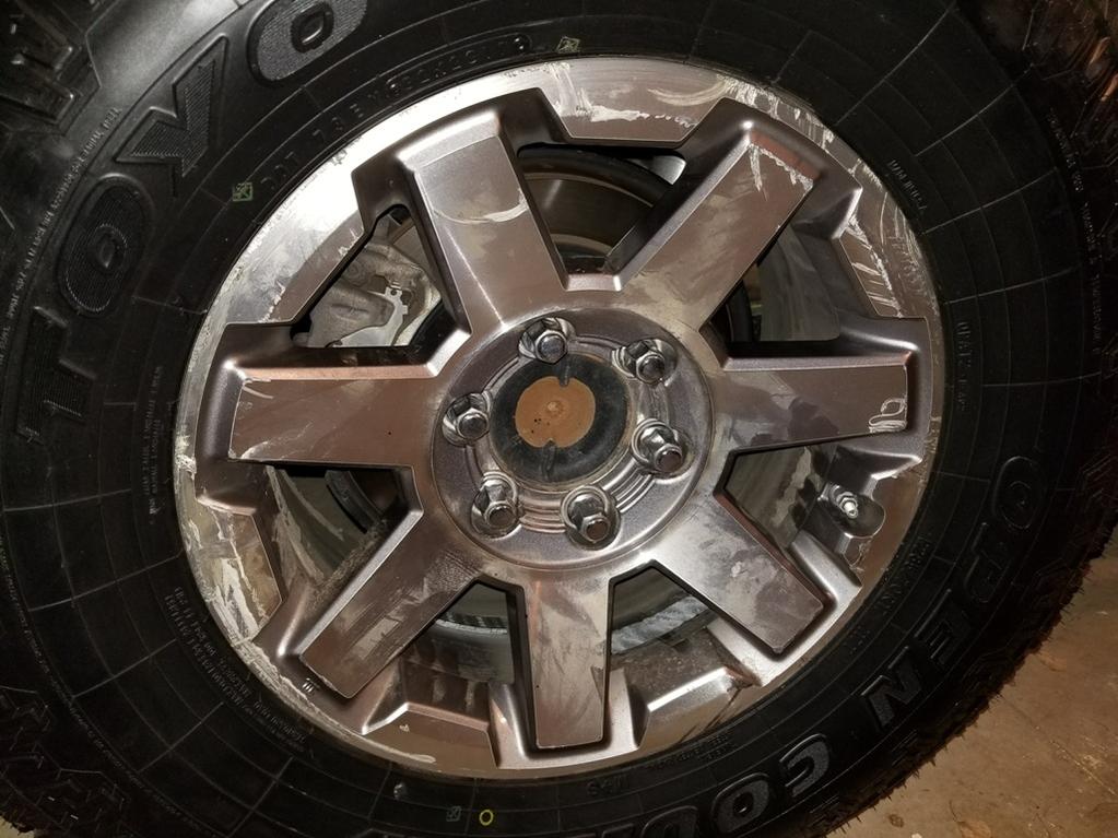

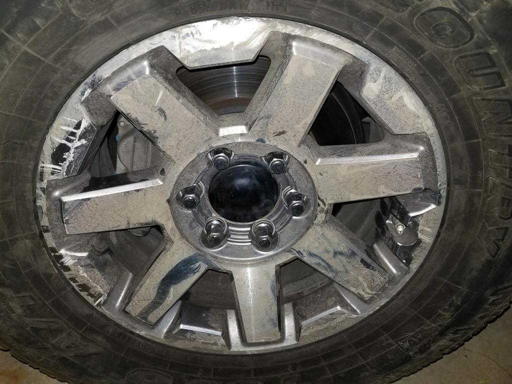

I've been pretty happy with P rated tires for durability. It really does depend on what you're doing and where you're going. I'll take a pic of my wheels and you can see they sustained a good bit of damage from grinding in the rocks - with no damage to the sidewalls of P rated tires. Not all rocks are created equal though, so my rocks might be totally different from your rocks.
I have however put a sharp rock directly through the tread of them. Once. Going fast on sharp rocky terrain - basically desert racing type scenario.
My other scenario on my trail rig where I've ripped lots of tires is at very low pressure. Like 3psi range. And it has happened almost exclusively in the snow incidentally. The sidewall ls pretty exposed and the right situation results in a pinch with the wheel, or a folded sidewall that is spinning on top of sharp rocks. Add some water as lubrication to the sharp edge and bad things happen. Without beadlocks - you're probably not going to have these problems.
For most everything else, I think P rated tires are a better choice. Moab is a good example of where street tires are probably ideal. The rocks are not sharp and most obstacles don't involve high speeds or spinning tires. And the surface is very close to a typical highway surface, so a street tire generally will have better traction than an MT tire. For moab, unless you're running sticky compound tires, an AT is probably better than an MT.
Kinda the same thing on the Rubicon. If I were doing it every weekend - I'd want a more durable tire. Doing it once a year, P rated tires are fine. I didn't have any flats. No one in my entire group did other than one person ripping off the valve stem on a rock. The rocks are mostly rounded.

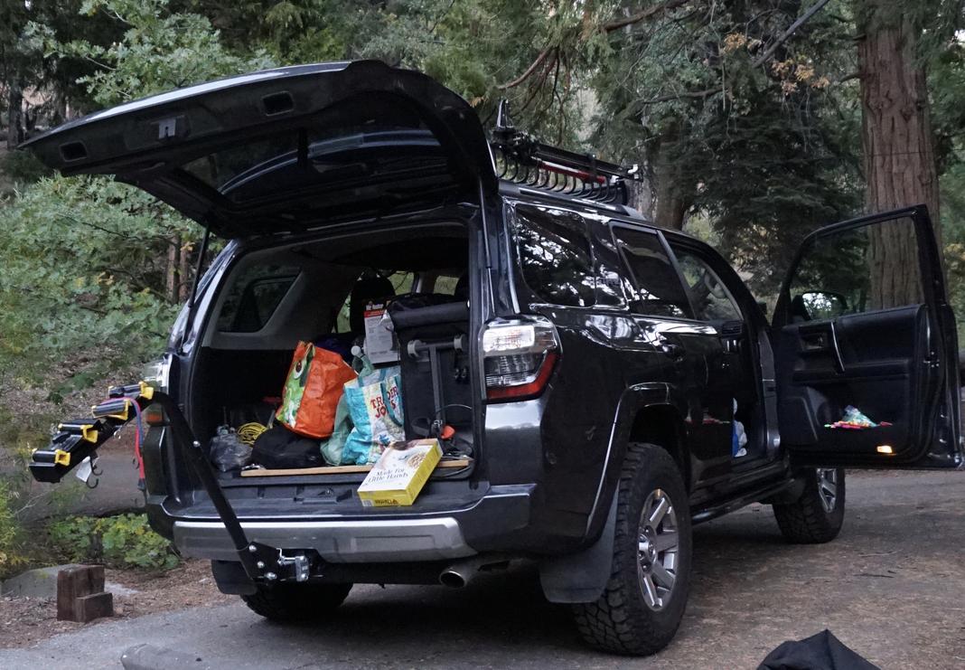

Do you have a pic Shai of your setup?
Would like to see how those look with no lift....Thanks
As promised - all of this damage to the wheels happened with the tires that are on those wheels as they are. You can see how minimal the damage is to the tires compared to the wheels. Also note the valve stems. The Trail wheels are designed right! The valve stem protection is pretty critical when you have $100+ rigid valve stems. And the wheel lip is heavily reinforced. I'd challenge anyone to break a wheel lip on these. They're significantly more robust than a TRD Pro wheel. The center caps were all totally destroyed. That happened about day 2 I owned it. Kinda wish I had just thrown them in the tool box immediately. Oh well.
Dang. And I felt bad about dropping a lug nut on my wheel.
Nice to know about the strength of the wheels. I've always loved them and I don't see my self switching.
And I actually always wondered about the placement of the valve stems. There is only one direction my ViAir compressor will grab on to the stem perfectly which I didn't like at the time. Seeing this makes me fine with it.
Here is the side photo
Thank you for posting those pics right away.
Are you sure those are 255/80's? They don't look any different than stock tire size. They don't look any taller anyways.
edit; Now I see they do look like other pics posted of the same tire size...my bad.....Truck looks good btw, almost got Mag Grey myself.
