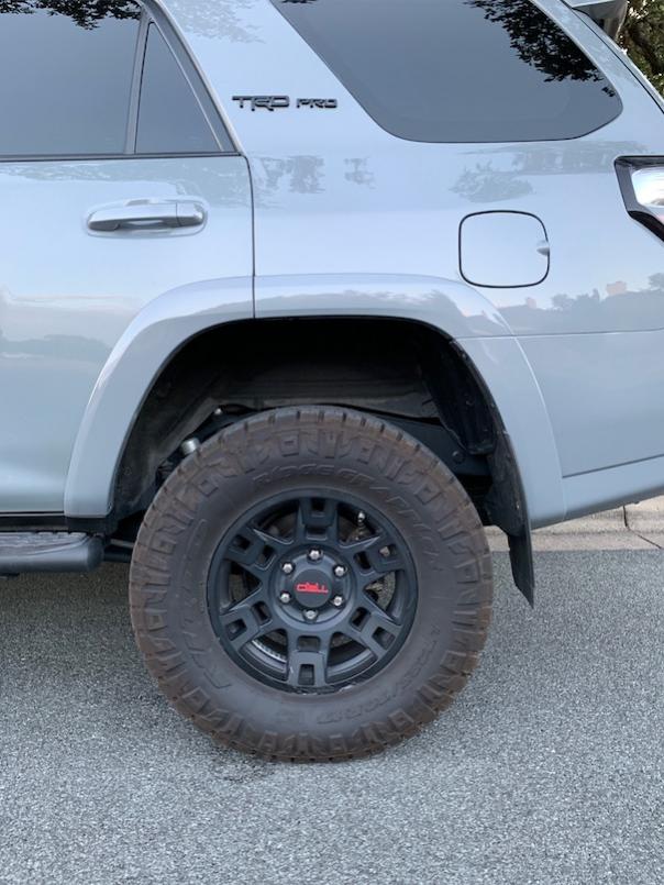

How much lift are you running? The rear tire looks pretty close to the front of the wheel well.
Which brings me to another question: when lifting, how much does the rear axle housing move from center? I know in my Jeep TJ, if I went with any more than 2", an adjustable track bar or track bar drop bracket was recommended to move the rear axle back to center and adjustable lower arms were recommended to push the axle housing back.

It's a weird camera angle -- here's a more straight on shot of the rear tire. It's fairly even in the wheel well.
Lift is probably a little over 3" front and 2" rear. My centerline measurements are 23" F and 24.25" R.
