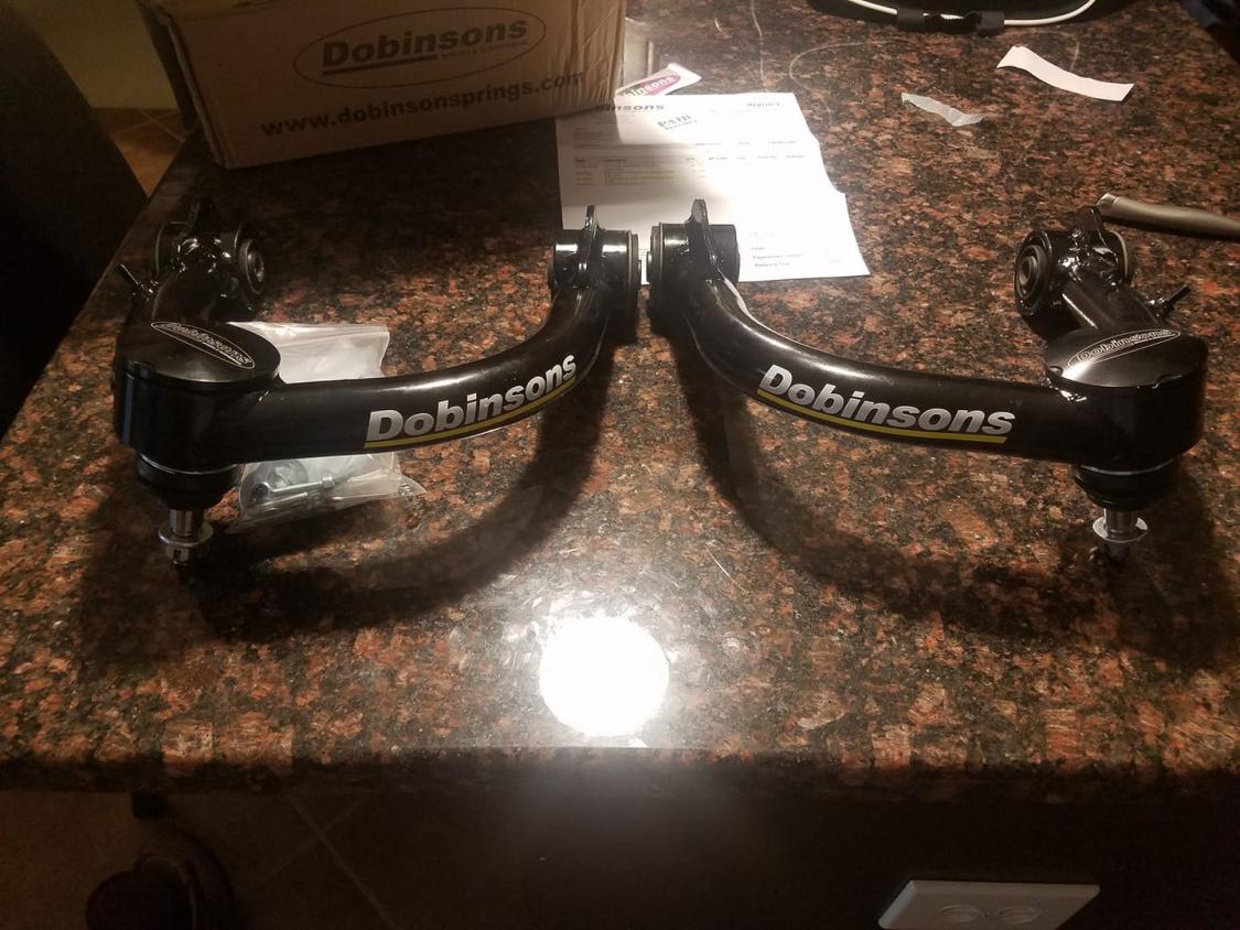

Anyone Running Dobinsons UCA? Opinions?
:guitar2::guitar2:
Install is on Tuesday, buddies lift will be clear on that day :)

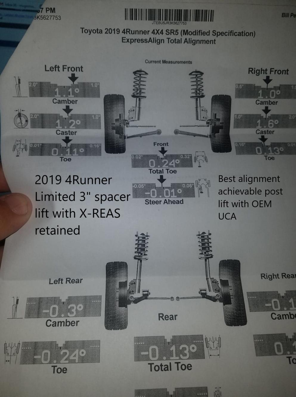

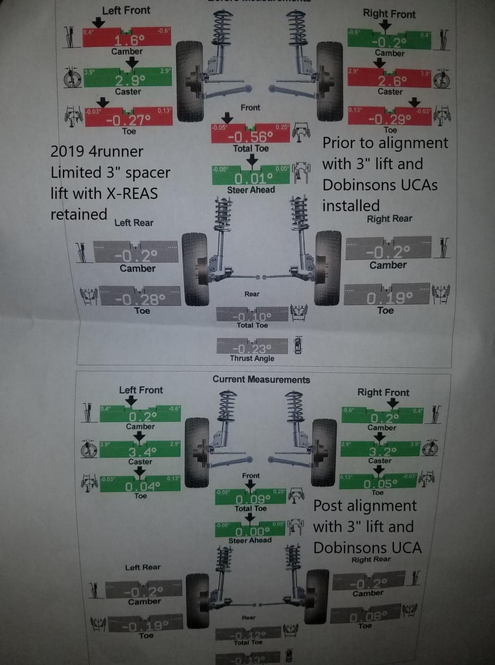

Dobinsons installed and very happy with results.
The pictures speak for themselves
First adjustment post lift with out UCAs while I knew would be very hard if even possible to get the geometry I wanted with out after market UCA. The alignment tech modified the machine readout/limits to put the numbers so they showed green:censored::gun5:.. and the truck pulled left which required about 2 deg of steering wheel correction!!!!
Tech was like "I don't know why it pulling left camber and toe are almost identical..":ybrick: well perhaps because you have a good amount of cross caster...... That was 2.5 hrs and 90$ wasted
After installing the Dob UCA went to a different dealership only took about 45 mins for them to adjust it properly.
Final adjustment ( at a different dealership) came out as close as I could have expected..
very very very happy with the Dobinsons UCA
One suggestion for Dobinson is to include a P clam example> (Essentra Components - SPN-10 - Clamp; Fixed; Screw Mount; Steel w/Black Rubber Cushion; 5/8 in holding diameter - Allied Electronics & Automation)
To secure the wheel position sensor wire to the stud on the UCA arm. Worked better then trying to reuse the factory bracket.

Just installed Dobinsons UCAs. Got alignment done today and after lots of wrenching the guy could only get +3º caster. When turned closer to +3.5º it pushed the camber out of spec (0.7 to 1.0 degrees) so I had to settle for only +3.
My setup is: Bilstein 14" springs, Toytec 1/2" top plate spacer, and TRD struts. My front bumper adds 90 lbs so I don't think I'm too much over 3" of front lift. I'm happy with how it drives, but I know 4º caster would feel better. I watched him adjust the cam bolts all ways seemingly possible, is this as much caster as I can get?
Nice stance, how does it ride now since you removed the toytec 1 inch spring perch?
With my 2 in lift, the tech was able to get me 3.4. He tried for 3.5 but it kept throwing the numbers off
I started out with just the Dobinsons 2.5” lift (2.25” after winch and aluminum slim bumper) then swapped the factory UCAs for Dobinsons a few weeks later. I checked the alignment paperwork and the caster is 3.5°. It definitely changed how the T4R tracks. Wandering all over the place at highway speed is drastically reduced. The lift didn’t really make the wandering worse. It was already annoying right off the dealer lot. Now I can relax and drive without having to make constant corrections.

Looks like I have just about the same amount of Dobinsons lift as KB180 and the Dobinsons UCAs resulted in very slightly higher caster (than KB180) with the rest of the alignment numbers within spec. The highway tracking is drastically improved and well worth the money. It's not luxury sedan precise, but it's about average now compared to most trucks. Way better than my 2017 F-150. About the same as my stock 2009 Tundra and a little worse than my stock 2006 Tundra (best handling truck I've ever owned).
The UCAs also eliminated the slight steering wobble I was experiencing intermittently after the lift on some roads between 60 - 65 MPH. Could be the result of a better alignment or balance by a competent tech instead of the UCAs.
