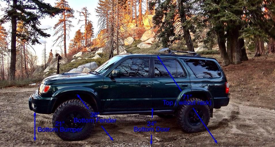

I have a 3" lift on my rig with 883 front and the rear coils are 890. The shocks are 60028 OME. With the stock front bumper the ride is a bit stiff, but a new plate bumper & winch are the next mods on the list which should make the ride just about right.
Here's a couple measurements I took that might help you see how yours will sit with this setup.

I am running the same thing... OME 883 and 890 with Bilstein 5100s. I also have a tjm up front. Seem to do the job but the 890s sag with gear. Stepping up to LC springs.

33" BFG KM2 Mud Terrain. No rubbing at all under normal off-roading - with a bunch of flex there is slight contact, but well within the acceptable range.
