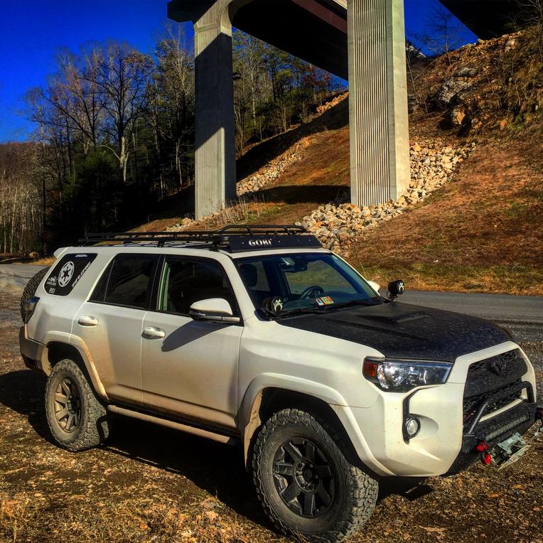

Anyway here is mine 3" all the way around.

Yep. And if you get the springs I would advise getting the matching shocks otherwise you will be topping out the stock springs on every bump in the road.
