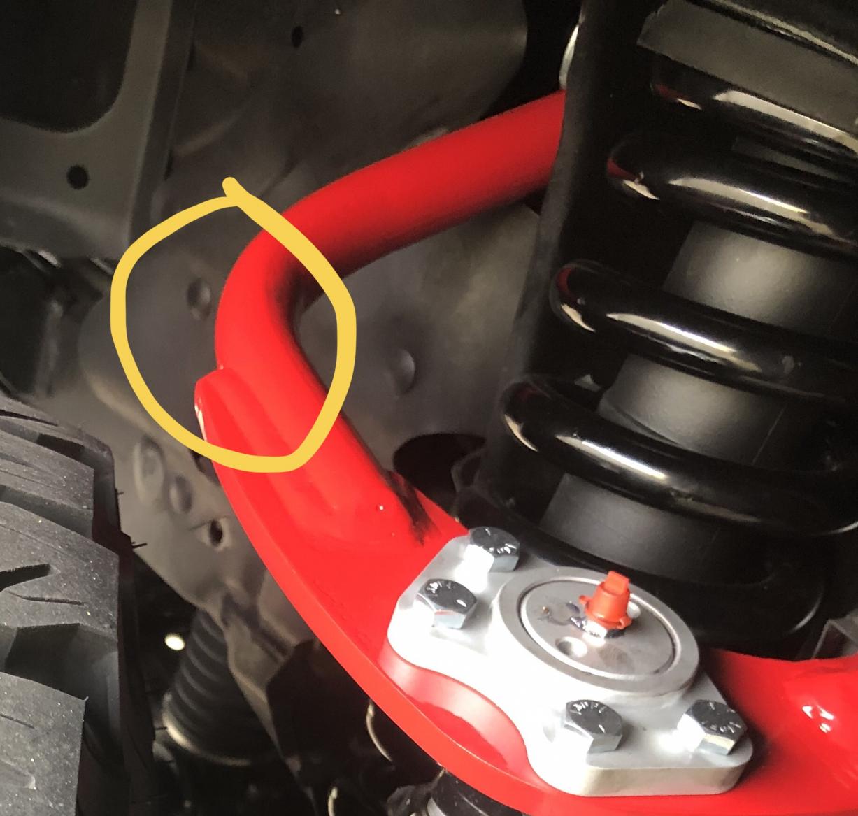

Due to a screw it's finally time to upgrade my tires. I'm thinking about the below combo:
FX Pros, Nitto RG 285/75r17, JBA UCA and King Shocks/springs
Anyone running this combo?
No, but I started another thread about running 285s with JBA UCAs....so far nothing. I reached out to JBA, and according to them, 32.7” tires will rub the outer corner of the arm. I’m test fitting Wildpeaks and KO2s in 285 Monday and I will report back.
