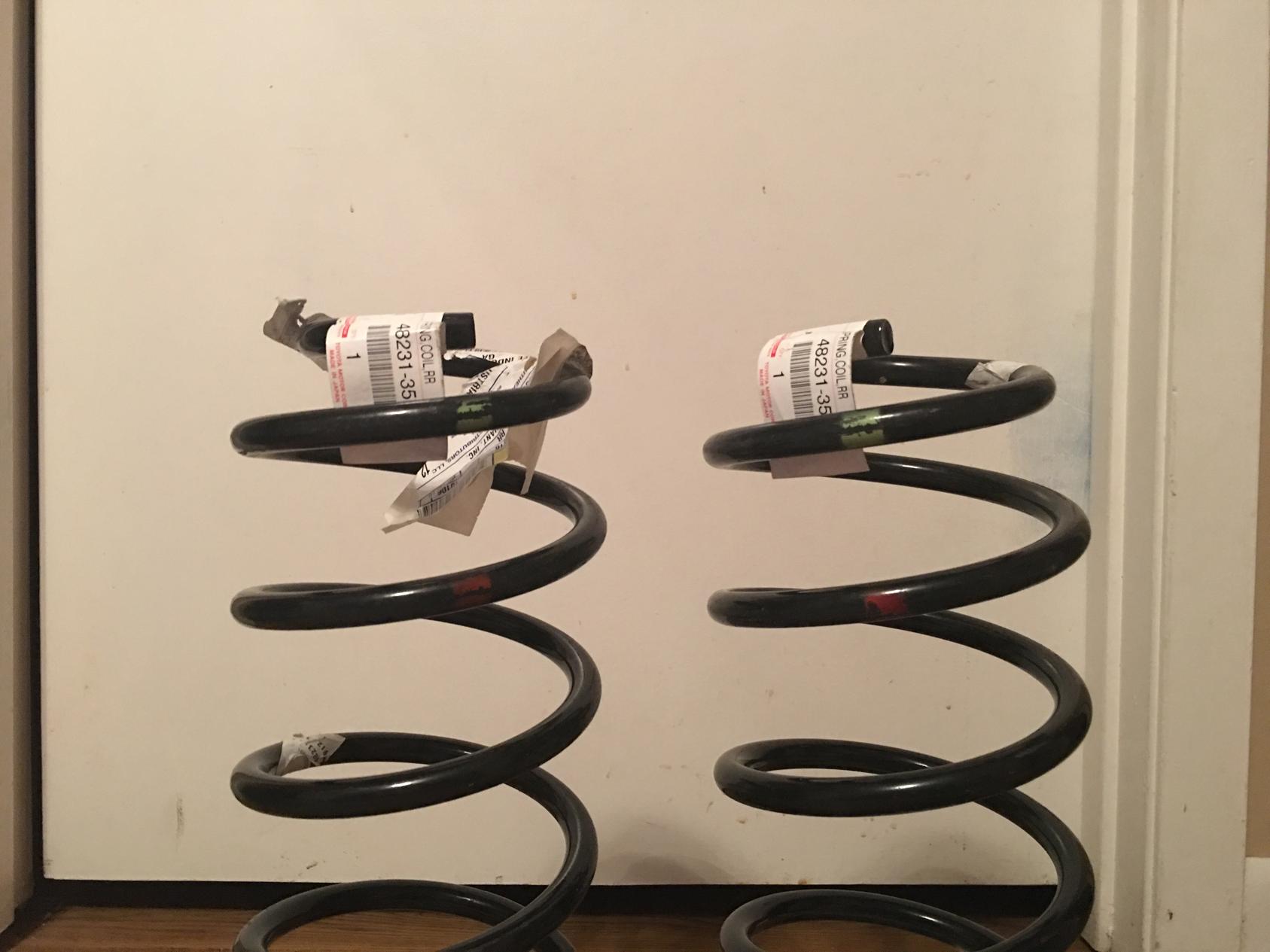

My 99 talls that I've yet to install and purchased brand new from Toyota are the same exact height.
Part number is 48231-35210
Tag on the left says "6C11" at the bottom. The right one says "6A18".
Am I missing something?
