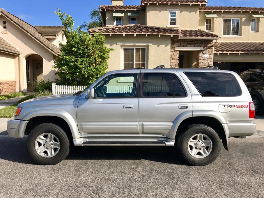

If anyone asks why the back is lower than the front – show them this.
I changed my springs in front 3 times and ended up going with the Moog Tacoma fronts. Have the 81041 rears but judging by the pics I don't think I'm going to like them. I'm interested in finding a heavier spring rate but not such and extreme lift. More to come when I can start my own posts...
Installed my Bilstein 5100's and front & rear moog springs. Ride is very smooth. I really like this setup. Did a rough before and after measurement and with the moog/bilstein setup I gained 1" front and 1.5" rear.

Before: 19 3/4" from hub center to fender flares
After: 22" from hub center to fender flares
Sent from my Pixel using Tapatalk
Before/After
Sent from my Google Pixel
Yep... See above posts.
Sent from my Pixel 2 XL using Tapatalk
