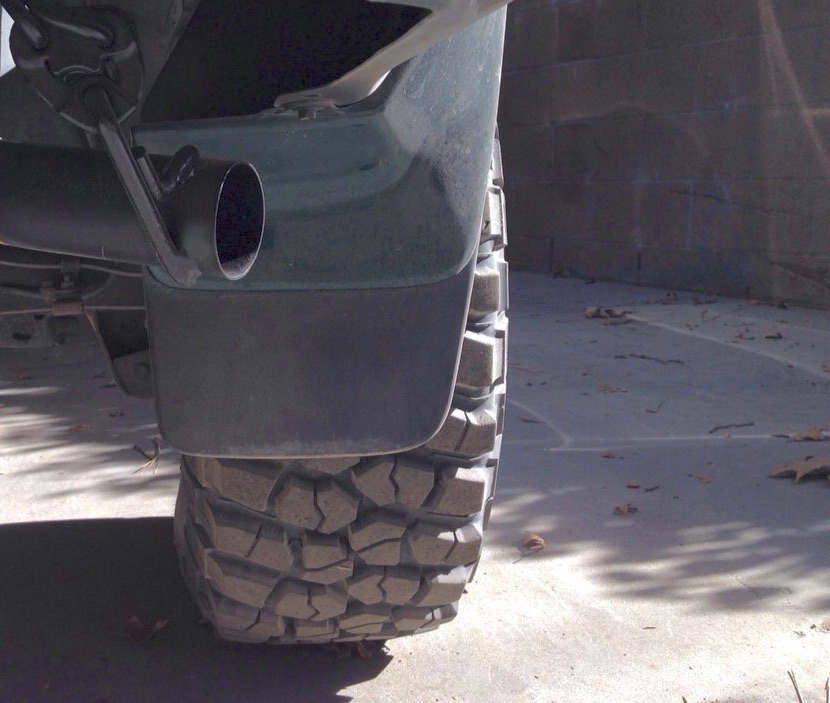

What the heck, I busted out the sawsall and 20 seconds later I trimmed about 4-5" off the tailpipe. Put on a few coats of black caliper spraypaint I had left over from the TBU. My only regret is not doing it sooner - the pipe is no longer visible from the side and looks right about where it should have stopped from the factory IMO. Sure I could have gone further, but will keep it as is unless it gets crunched on the trail someday.
