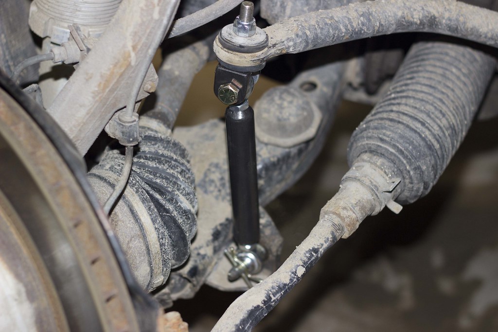

My question is, since the Tacoma bar is getting the larger range of motion by allowing the endlink to move more freely, why not just make a set of endlinks for the stock bar that do that? That's essentially what I did, they disconnect easily when I want them too, and when they are connected I noticed no increase in body roll but can easily stuff either front tire all the way to the bump stop and still have the max down travel that the limit straps allow. And it only cost like 50 dollars for the heims

[MENTION=169609]Septimius[/MENTION] there are a few more pictures of them on page 4 of my build thread. Pretty simple design though. I used 3/8 heims and just added a bolt on stud to the a arm, similar to the jks disconnects. Pull the cotterpin on the a arm, fold the links up against the bar and secure the bar up and it's disconnected. I can disconnect or reconnect in about 3 mins, closer to 8 if I have to fight with uneven ground.

[MENTION=169609]Septimius[/MENTION] I used 3/8 heims and just added a bolt on stud to the a arm, similar to the jks disconnects. Pull the cotterpin on the a arm, fold the links up against the bar and secure the bar up and it's disconnected.
is that a hood pin, essentially, at the a-arm?
Essentially yes, It is a grade 8 bolt that i cut the head off of and drilled a hole in to allow for the retaining pin which is also grade 8. I then bolted that to where the stock link hooked up. There are about 10,000 miles on them with no issues.

I purchased the heims from qs components. The link itself is made out of some left over 3/4 x 1/8th wall tubing I had in the scrap bin and I made the brackets that are on the bar out of 1/8th inch plate. Basically all you need is 4 heims, 6 grade 8 bolts, roughly 1 ft of tubing, a couple cotter pins, and a little bit of 1"x1/8th" bar steel.
For tubing I recommend .120 wall DOM tubing for strength and Id upgrade to 1/2 inch heims just for a little more strength
