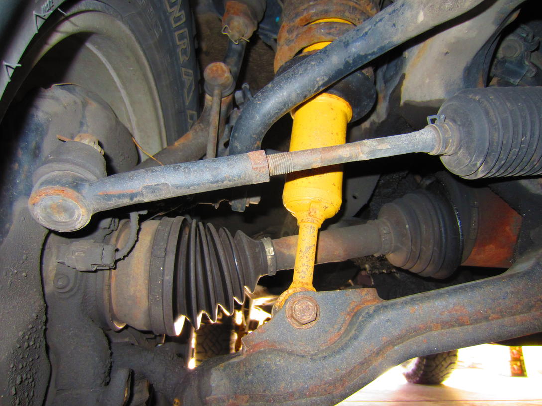

So being cost restricted right now and my tax return wasn't as much as I had hoped, I'm just going to get just one rebuilt OEM axle from CV J Axles out of Colorado. Another time when I have the $500+ for the off road CVJ's from them, I'll do it. So maybe next years tax return! This is what Ruffian's axle looks like as of this morning. I'll take photos and post them up after the install. My appt. for that is Sunday March 1st.

CVJ in Denver Colorado comes highly recommended from a few different forums. They do factory OEM rebuilds and they offer a beefier silicon inner boot for the increased angles with a lift. I'll be installing a pair this weekend and taking lots of pictures and possibly putting together a write up if there is any interest. If not just check my build thread later next week. Here is what they look like.
