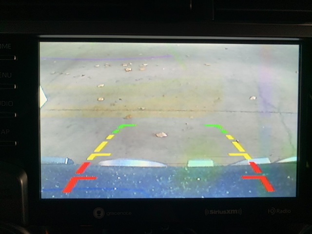

For future readers, I was able to mount on the upper grill portion. I haven't yet connected all the wires up, but this mounting location looks great. Based on the camera angle I think it will clear the TOYOTA lettering just fine. To install it you'll need to take off the upper grill and cut out a good bit of plastic from the black inwards-facing piece. It looks pretty good in my opinion and almost OEM, doesn't stand out at all like I was worried it might.
I was thinking of mounting my camera in the same spot. How did this camera view end up working out for you once you had it all connected?
It worked Okay. Not perfect, as the view doesn’t clear the lettering. It’s still useful for some situations but it’d be better if it was farther forward. I may adjust it later.
