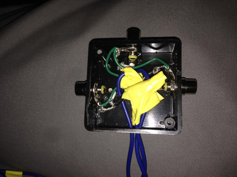

I aimed for something that was basic and employed the use of a switch between the video inputs. I saw this product during my research and really liked it for its simplicity and the fact that no power was needed to run it. However, I didn't like the switch that was installed on it, so I opened the door, gently removed the wires soldered to the switch, and attached some longer wires and ran that to the switch panels to the left of the steering column. I had a spdt switch from oznium.com laying around, connected everything and viola!

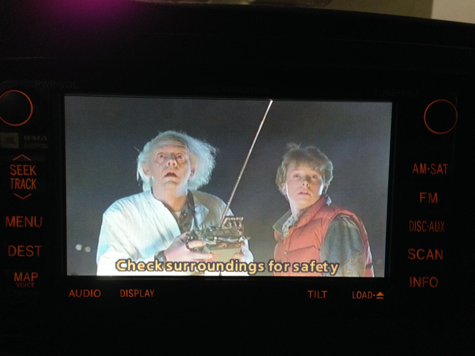

I used my A input as the reverse camera, and for now, during downtime in the car, used the B input for an iPod video connection, with the two audio channels running to the AUX input to my PA-20TOY.
