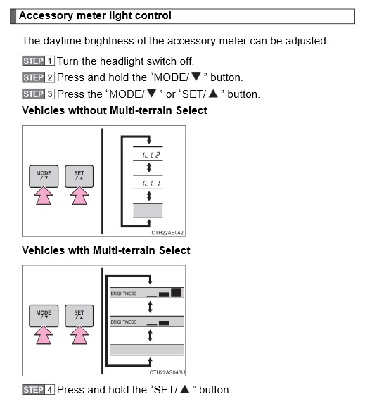

Oh I see what you're talking about, have you tried making it brighter using this adjustment feature? I know what you mean though, sometimes the sun just overpowers it, oh well.
