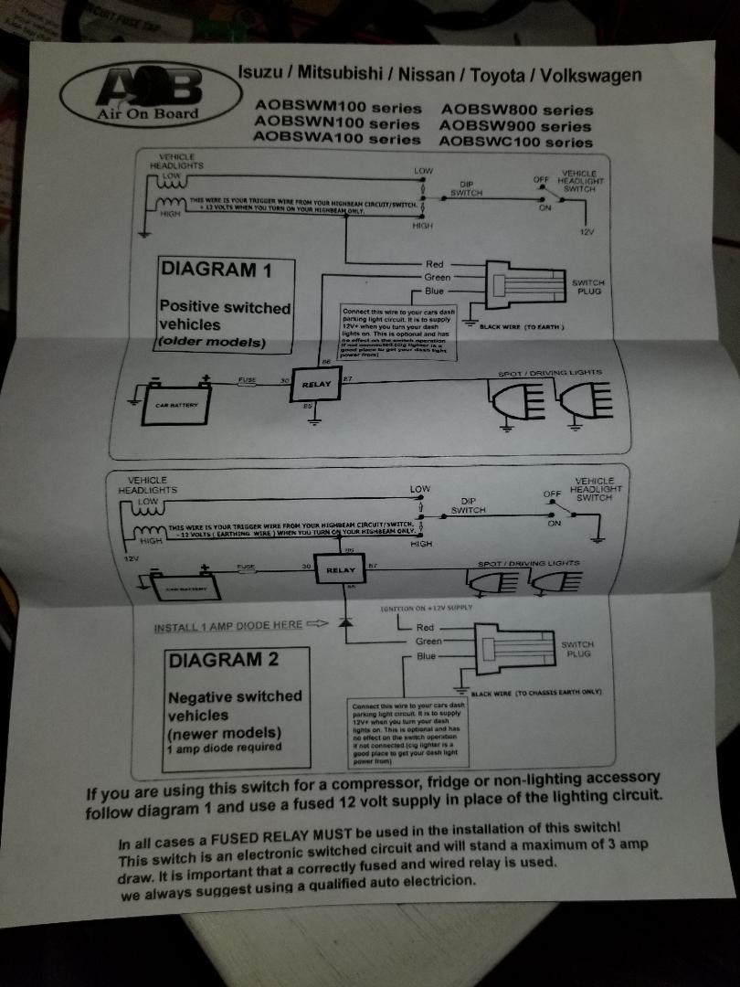

I thought I read somewhere that all of a sudden the AOB wiring harnesses changed and some of the colors were swapped. Here in my wiring diagram......
Following your instructions but looking at the change in colors....???
So AOB red to harness red?
AOB green to harness blue?
AOB Black to harness black
AOB blue to add a fuse?
Yeah, I believed you cause I have that one too! So if the wires on the switch are RED, GRN, BLU, and BLK, then follow that color code. If they're like the diagram that I posted, follow that; it is confusing that there are more than one version for the AOBSW800-series and 900-series switches!

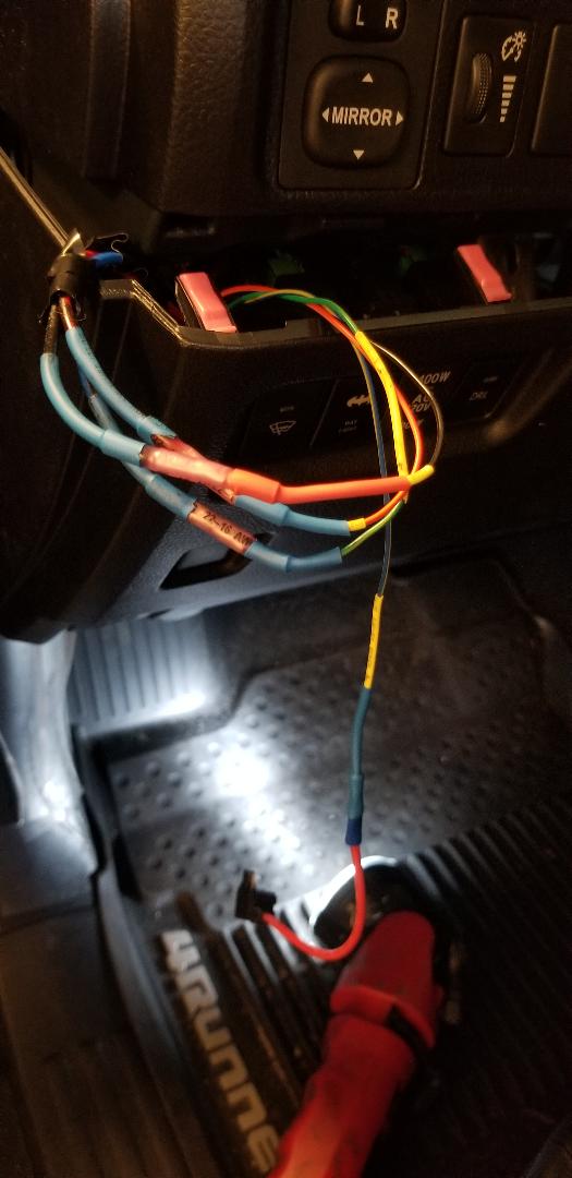

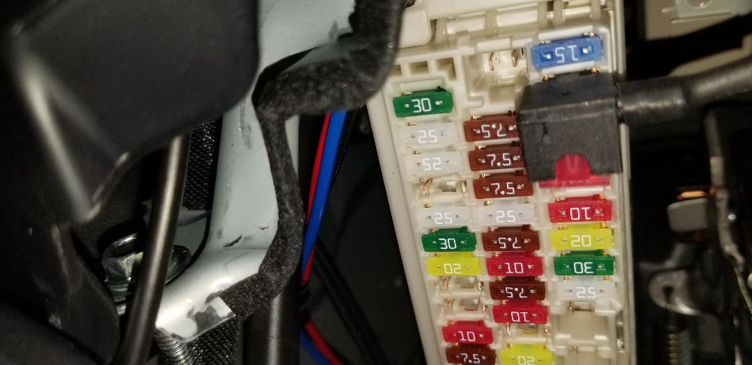

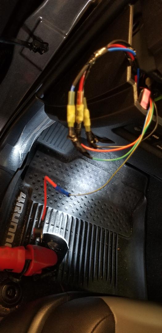

Ok. Here are a few pictures, ended up getting out there and just tidying it up. I am not an electrician, I am not good at wiring and such, I read for far too long for what is likely an easy project.
-Proceed at your own risk, so many variables of parts of there, what I did may not work for all.
-Lightsource light bar behind the upper grill
-AOB light switch. i believe my wiring is the updated coloring (the colors changed at some point, so some of the early references and wiring diagrams are confusing. Lots of color options of the AOB switches, make sure to get the new toyota blue I believe.
-My light bar came with a nice wiring harness, which made it easy. But it took me a while to really verify what color meant what since i didnt have the original instructions (bought used).
-I initially wired it and it worked, but it felt more like a bandaid. Today i put on some more heat shrink, and now I feel better about it.
-I did not tap into my wiper heater, I just did an add a fuse, so it will not dim, but it lights up just like it should.
-Black to black, red to red, blue to green, and the blue/yellow to the add a fuse.
-One picture is my before (bottom), one picture is where I put the add a fuse (middle), one picture is the final part (top). If anything looks out of sort please let me know, but it works just fine (knock on wood.)

Very helpful! Thank you for positing this, ill likely be doing the exact same thing. Which fuse are you tapped into?
Cant remember. But it's on passenger side closer to driver (farther from engine). Worked out perfect.
