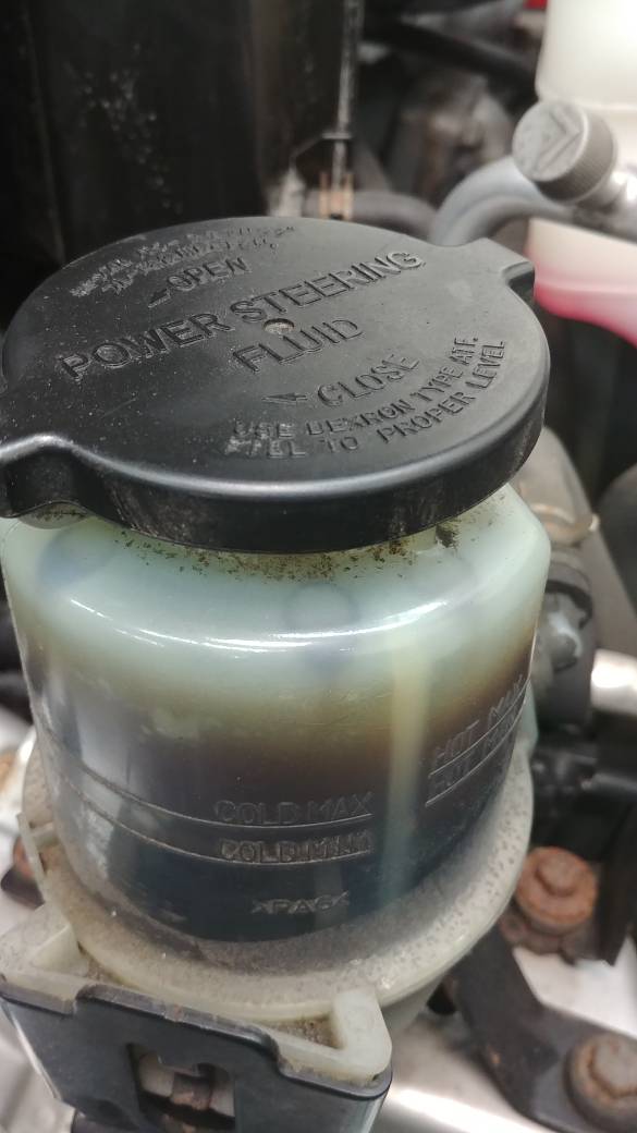

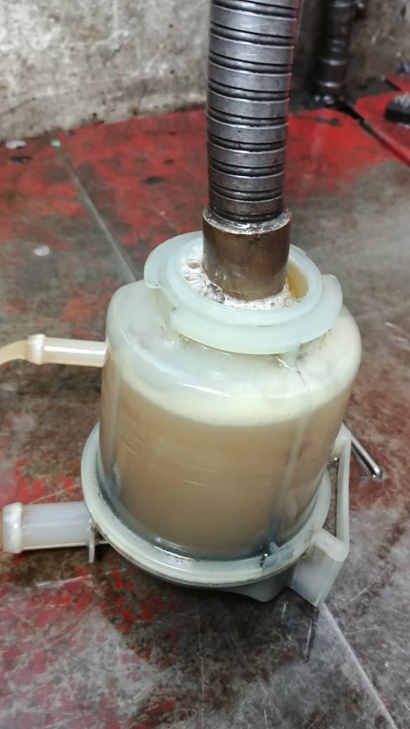

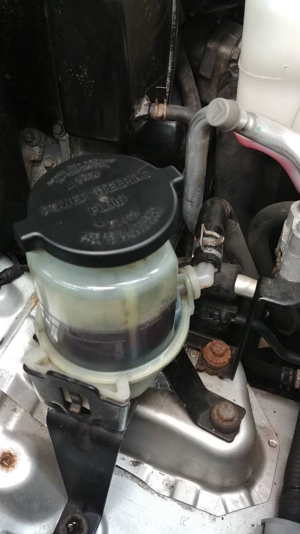

Lastly for now, an overdue power steering flush! The previous fluid was likely PS fluid, which is not reccomended. In went Valvoline Maxlife Synth ATF!
Before:
Parts washer mid-clean:
Install, cycle the fluid until the whole system is clean by turning the wheels when off the ground, and... Voila.

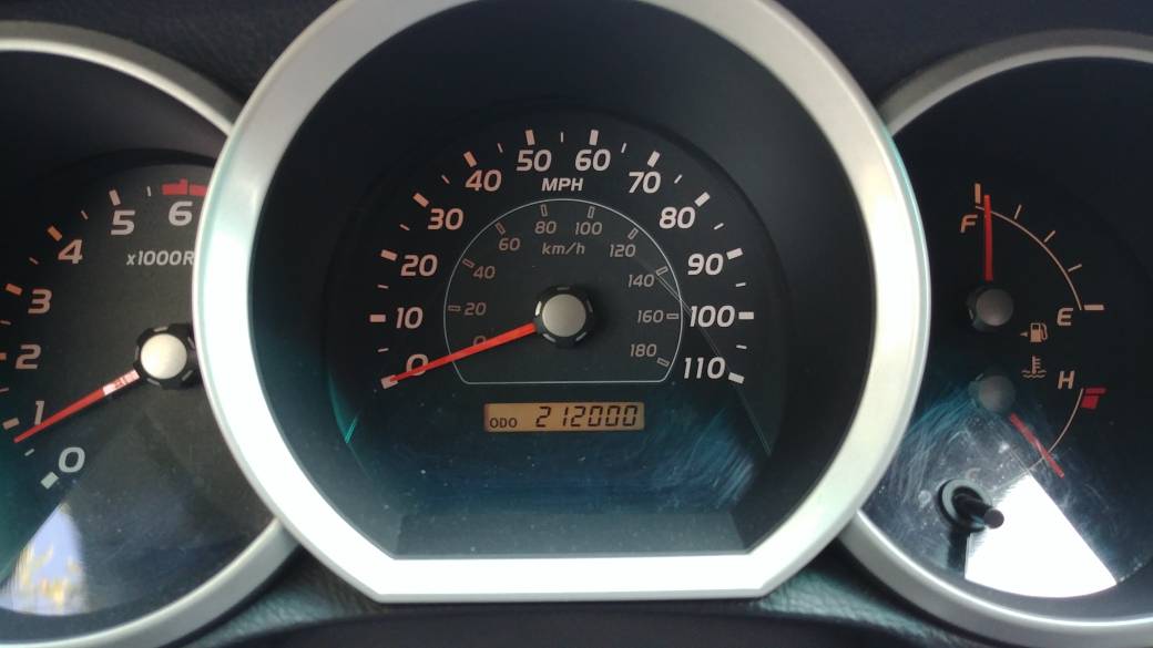

Couple hundred miles already on the AventuRunner. Hit 212k!

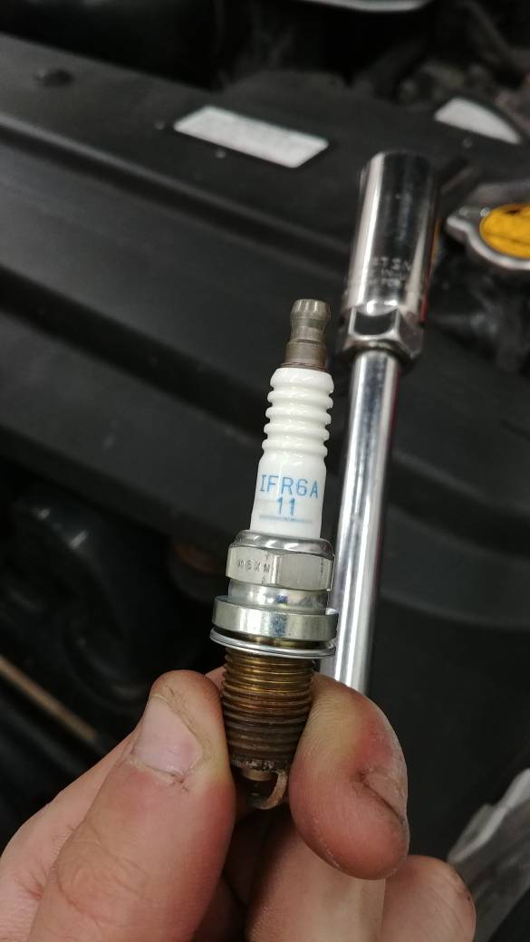

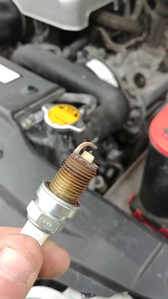

Checked the plugs, mostly for reference. Looks like they are doing fine, gap is still at 0.040. I'll probaly replace them with Denso next year sometime...
Sent from my VS988 using Tapatalk

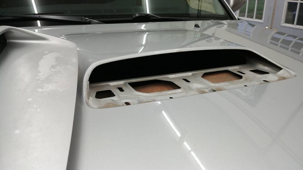

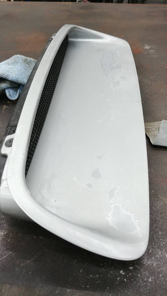

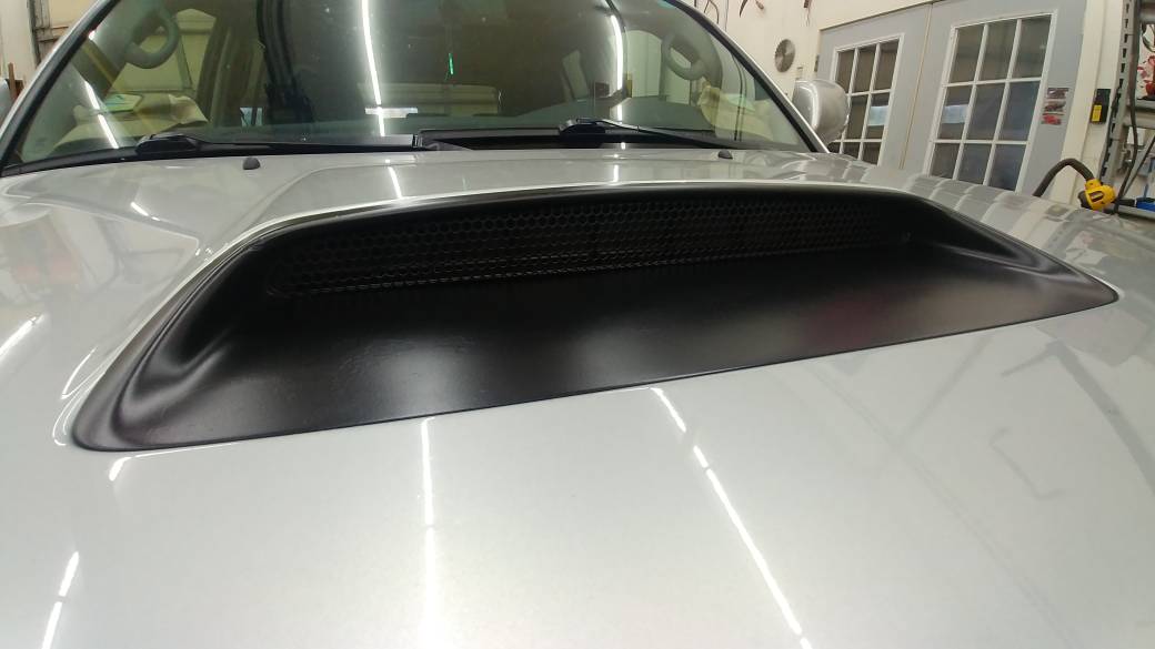

Decided to paint the scrappy looking faded scoop.
First step, removal. 5 bolts, one hidden philips screw under the insulation, and it's off.
Hit it with some 400...

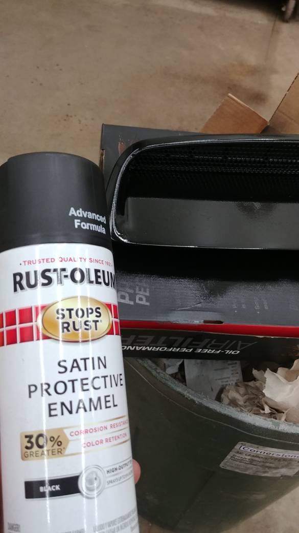

And out comes the trusty satin black.
Notice how glossy it looked? I got freaked out and nearly topcoated with flat black!
But, I gave it a night to degloss, and it went down to satin overnight. Whew.
Much better! I'll probably repaint the peeling grille next, torn whether I want to keep it silver or not!

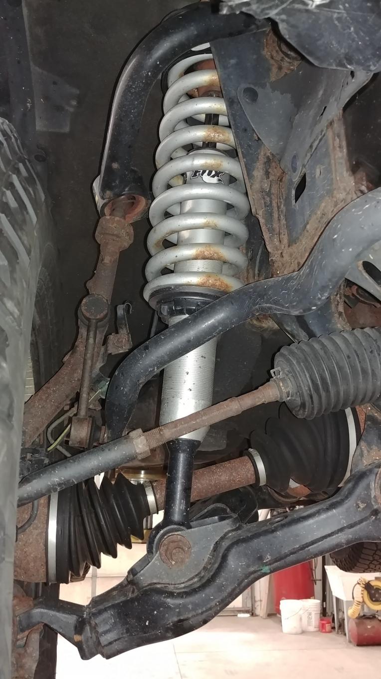

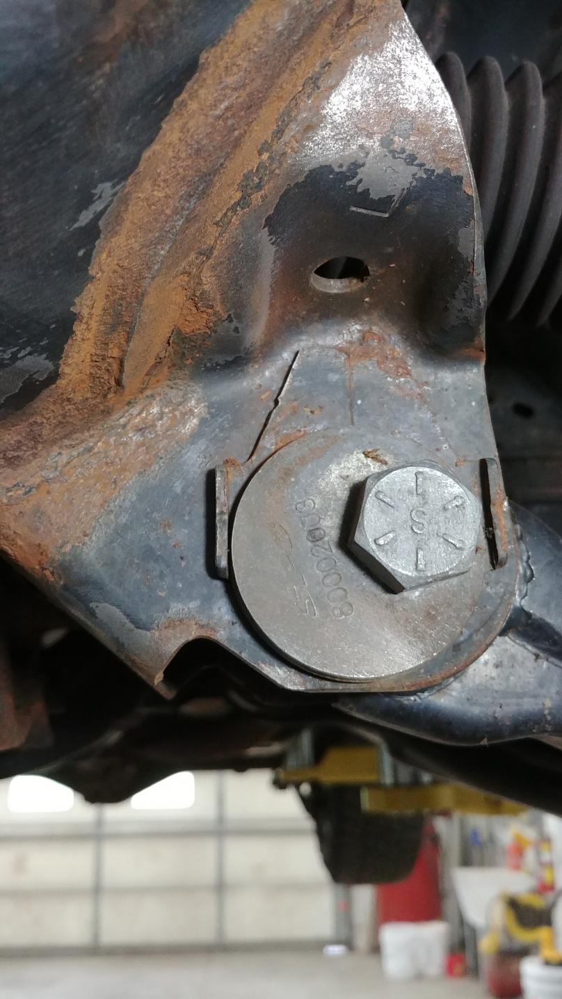

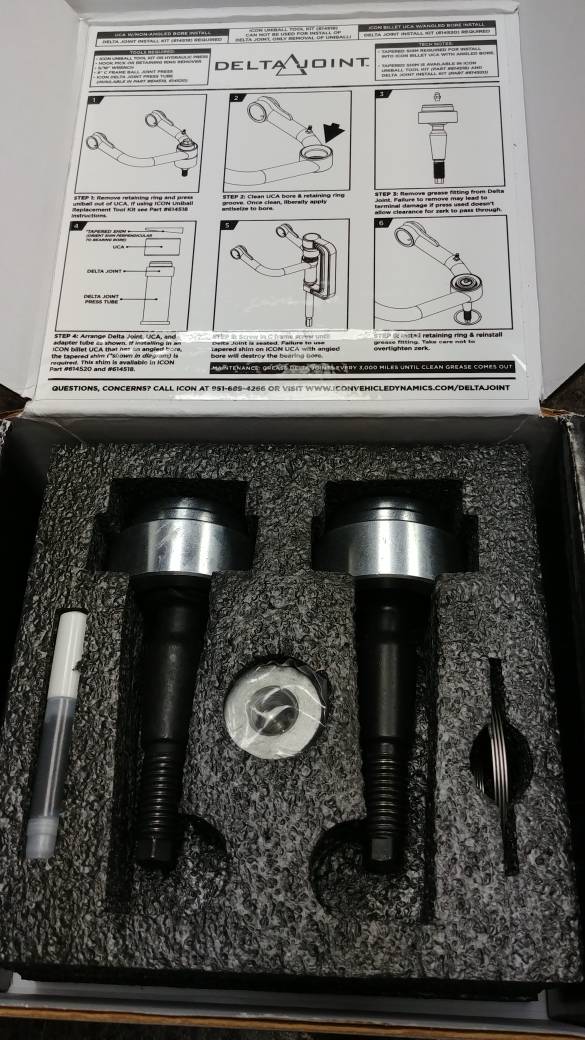

Couple goodies came in the mall today!
Big shout out to Icon for warranty replacing my rusted delta joints. They were very easy to work with and great customer service across the board.
New deltas:
Install hopefully in the next couple weeks!

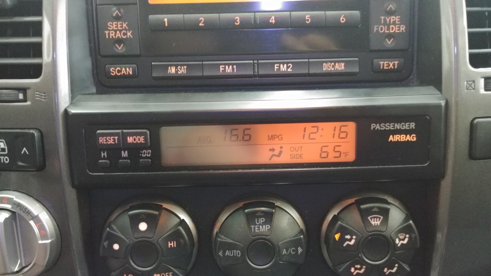

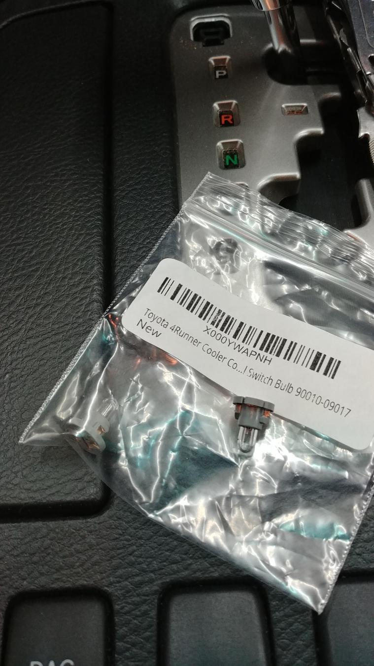

So as I have been driving around, I started to notice the LCD screen dimly lit. So, I ordered in a 90010-09017 bulb, replaced the one I thought was out, and replacing it, I realized, indeed, not one, but both were out. Guess I should'a bought two! At least the time is lit until I get the next bulb in :bravo:

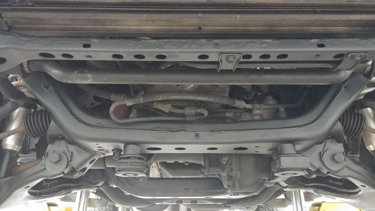

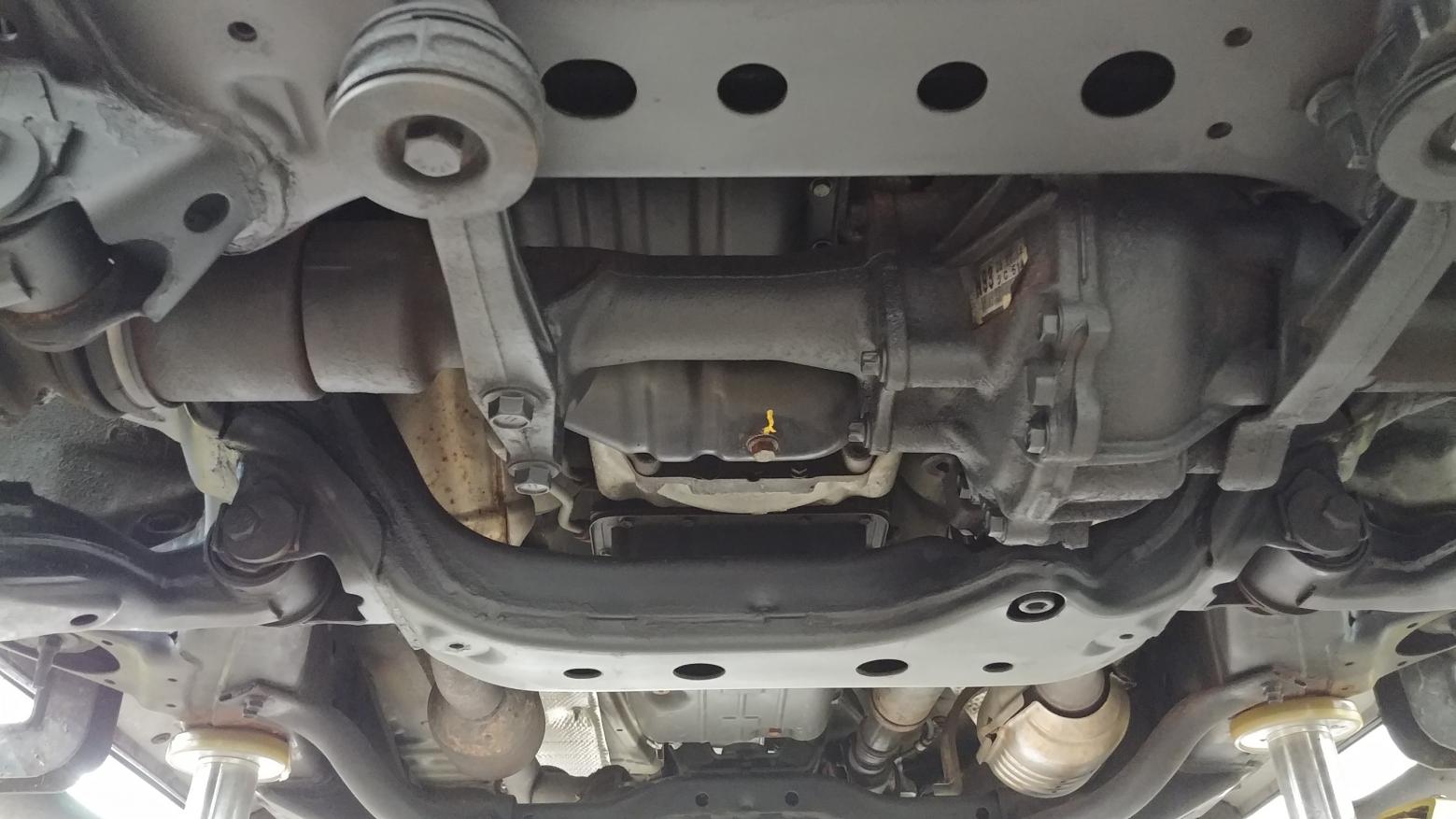

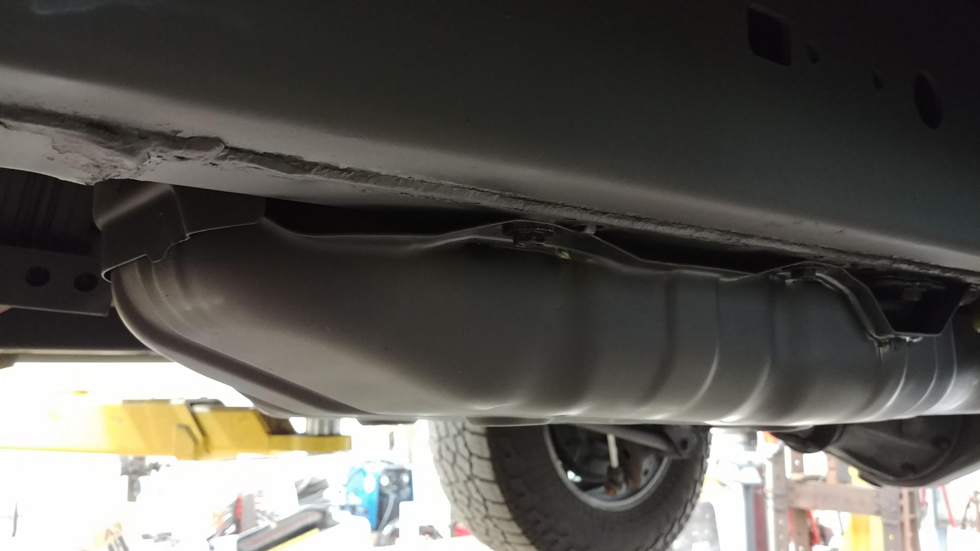

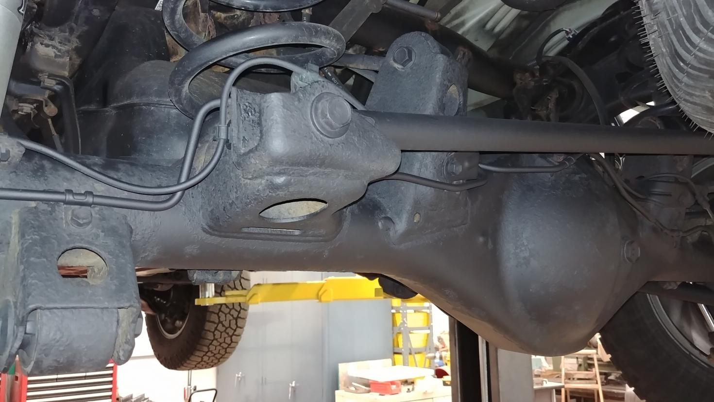

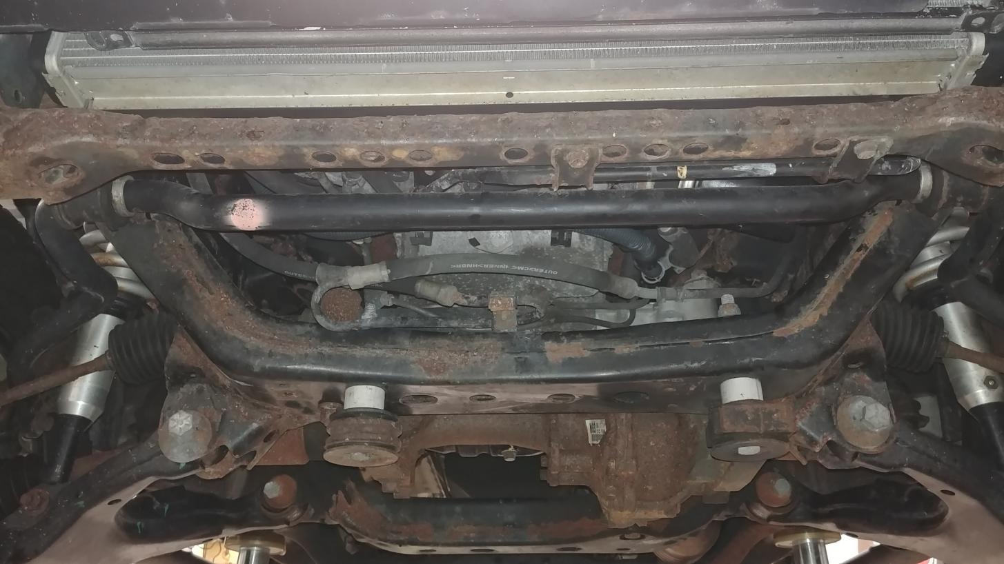

Over the weekend I spent a few hours doing a lil' thang I like to call... a frame manicure. Since this is my 3rd runner (and the one with the least amount of starting rust), I made my point to keep the frame juicy. So, out comes the wire wheel and the facemask!
Before:
1. After wire wheeling everything I could get the bristles on, out came the air nozzle to blow off the dust, flakes, etc.
2. Next up, a little bit of degreaser to clean the surface from oils/grime.
3. Third, Rustoleum Rust Reformer- Used 2 cans to get all the rusted areas. Turns the corrosion into a paintable surface. For the price, it does well!
4. Lastly, a topcoat of Flat black enamel.
Finished product (for now):
*edit, the shop kittens were watching intently the entire time.

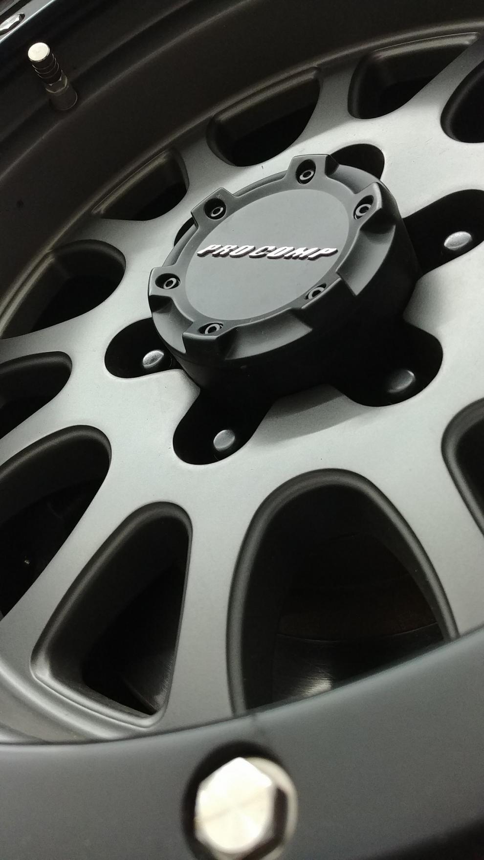

Also, cleaned up these wheels a bit, really digging them for what they are.
:party::party:

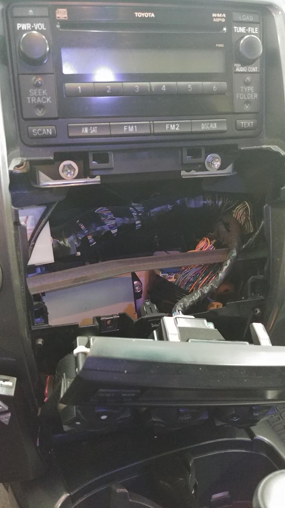

Another bundle of minor things came in the mail yesterday! The Crux interface and Metra 8202 dash kit is for my double din install in the near future. And I got my second 90010-09017 bulb for the LC's screen, so now that's fixed for good...

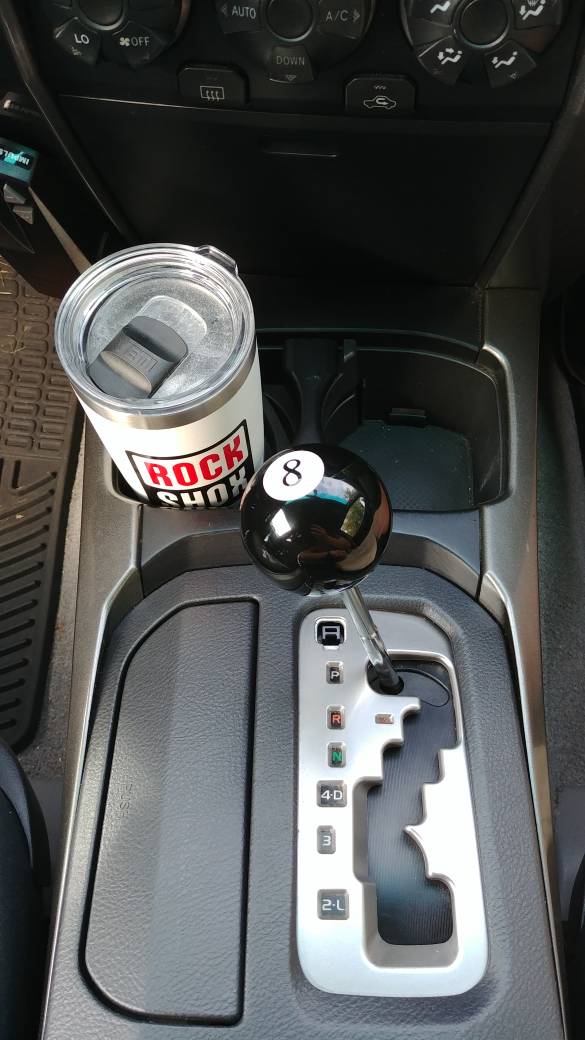

The first being this $11 ebay 8-Ball. Threaded right up, and it's noice....

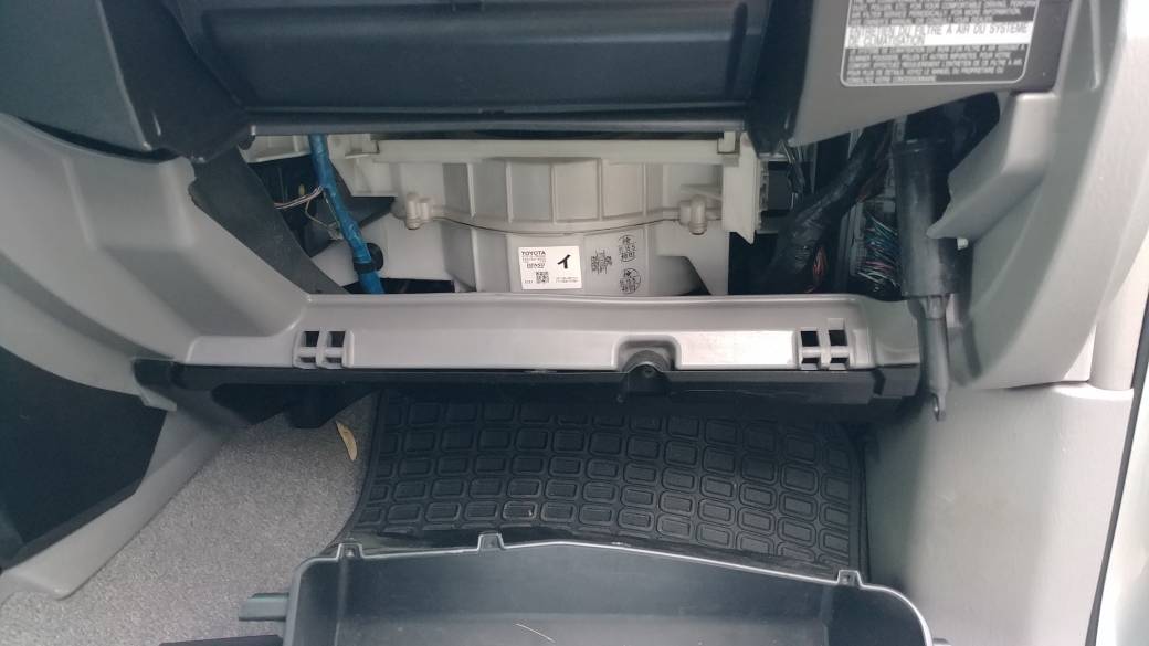

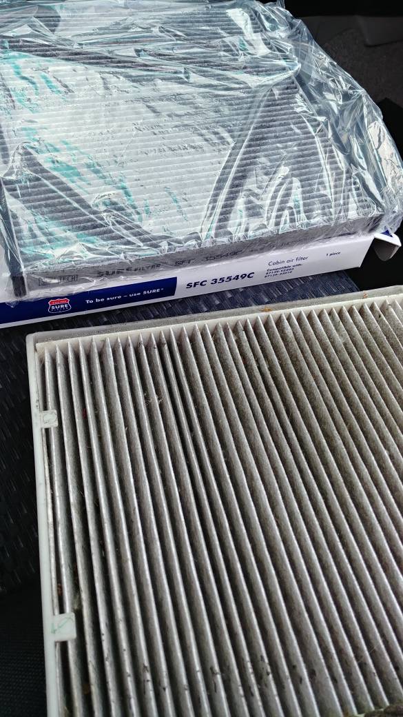

Next up, cabin air-- I had checked it a week or so ago and it was pretty plugged up. For $8, time for a new one!
For those of you you don't know, it's easy to get to once you drop the glove compartment, which is a single screw and a bit of finaggling.
